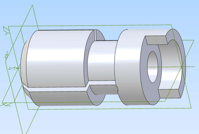

      Among my magpie boxes are two of these, marked only by their cutter diameters: 10 and 12mm.
      I have searched among Clarkson Autolock but did not find this pattern so I suspect another make. (I have an ‘S’ type collet set, I learnt.)
      I made this rather unrefined sketch as clearer than I could photograph it, but as a guide, overall length 1-3/4″, body diameter 5/8″, and show the 10mm cutter size.
      BTW They are surplus to me, so…..
      Screenshot 2025-11-30 213835

        I think it’s an Osborne milling chuck collet.
        Martin.

          Posilock?

            I do remember using some collets like these about 45 years ago, it may have been an Ericsson chuck.
            The only thing I do remember is that the collets were not very springy and they gradually collapsed so that it became very difficult to fit or remove the cutters.

              Posilok?

                Google ‘Posilock milling collets’ and all will be revealed.
                  Martin.
                  Just been out to measure my Titanic 2; they’re 0.881″ diameter.

                  Nigel Graham 2
                    @nigelgraham2
                    Thankyou!
                    Bill –
                    Yes -I’d meant 7/8, but had measured it by Vernier in poor light, didn’t account for those extra thous…  and then mis-quoted it! The drawing’s correct (I think). Correct enough for identifying.
                    Right. So I can’t use them anyway… If anyone can.

                      Bill and Nigel.
                      It seems that Osborn and Posilock collets are the same thing.
                      Thanks for the verifications.

                        Posilicks were /are? sold by the likes of Warco for their import mills since maybe 30 years ago so thousands out there. Of course mostly with a set of collets but maybe someone who only got imperial collets would appreciate a metric one.

                          Definitely Osborn, my Titanic II uses them and I bought some new Posilock metric collets to complete the set, which fit exactly, they are still available as are the Posilock arbors. Same general way of working with threaded shank endmills as Clarkson Autolock, but not interchangable. Mine go up to 5/8″ and 16mm, I’m not sure if they have a larger range like Clarkson does.
