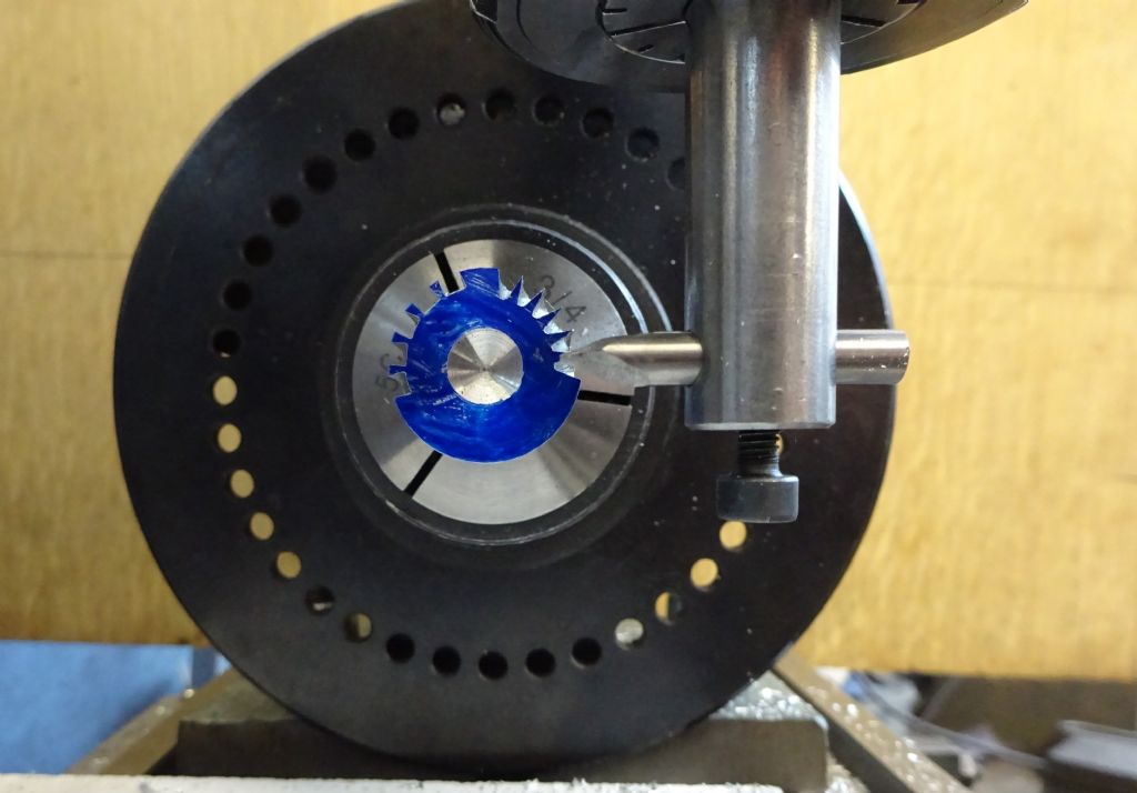

                        I would imagine something like this either grind up an HSS tool or drill/file some HCS to profile and then make a simple holder or even use a flycutter if you have one then you can make whatever shape you like- just the tips or the whole tooth form.
                        Couple of photos from my Milling for beginners series

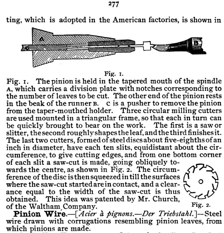

                              From the ninth edition, 1896, of Briitten’s ‘Handbook Dictionary and Guide’
                              Edit: Just found this : https://youtu.be/VHysXT7RaIM
                              … and don’t forget to watch Clickspring’s masterclass : https://youtu.be/XkJJid3_bhg
                              Edited By Michael Gilligan on 14/12/2019 09:30:04

                                  From your scan that's an interesting and simple way to relieve a small cutter and the "pusher" is useful too as a standard Ctr often stops you getting in close, bit like a half ctr in the tailstock.

                                        Posted by JasonB on 14/12/2019 10:10:07:
                                        There was a lot of innovation in the American watch and clock industry. yes
                                        … hence importance of the little book that linked in the ‘Build a watchmakers lathe’ thread
