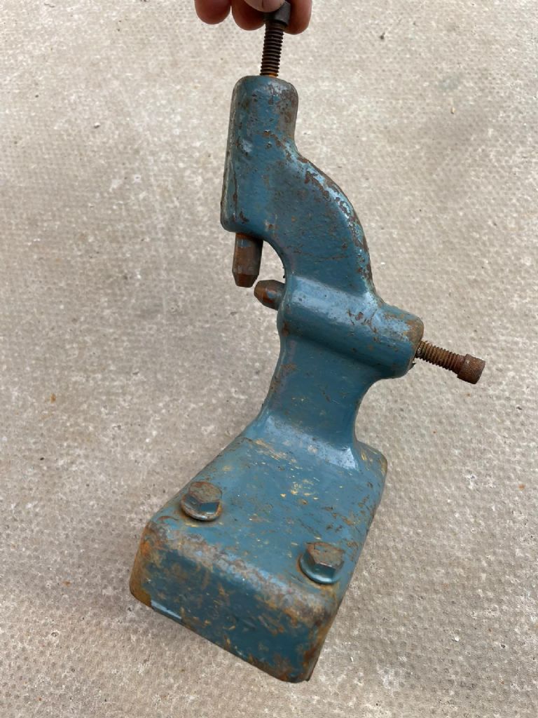

      Hi guys
      My brother has asked me to help identify this lathe steady for him, as it is surplus to requirements he might as well sell it. I found a few similar, but no exact matches. Anyone know what it fits?

          I don't recognise it but dimensions may help, particularly width of bed and height to centre.

            Dimensions are approx. 92mm from the bottom to the centre and the widest part of the dovetail is also approx. 92mm

                Old Harrison L5?

                  But the closest I can find was for an early Raglan little John.

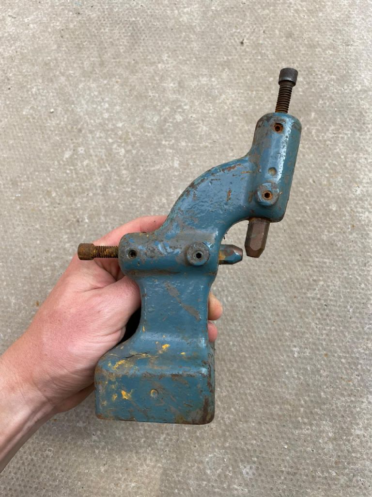

                    Am I missing something here? As a steady it's orientated the wrong way, can't say I've ever seen one like it.

                      I initially thought it could be but all later castings (at least) were embossed with part numbers. Almost certainly was not supplied with a LJMk2.
                      I expect it would fit a Mk2 LJ, if it would fit a Mk1.

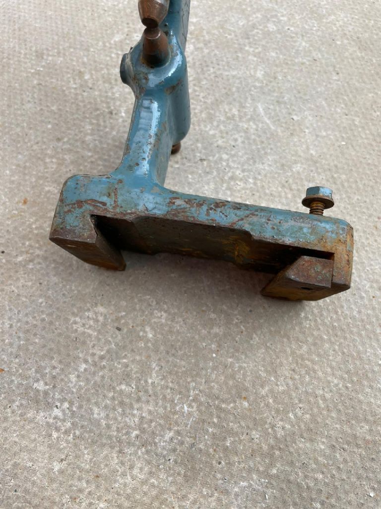

                        I wondered if there's a missing mounting plate with a matching dovetail which would give adjustment across the machine axis.
                        As it stands, the item won't accomodate a very wide range of diameters.

                              I'm guessing it would clamp onto the cross-slide dovetails? Adjusting it so as not to foul anything might be a chore, though. frown

                                Compared to Michaels link it looks a little crude / budget for a Raglan made item.
                                It would fit on the cross slide dovetails if the leadscrew chip cover was first removed.

                                  Swing over the saddle for a Raglan LJ is quoted as 6 1/2”. The lathe centre height is 5 1/8”
                                  The ways are 3 1/4” inches apart – I don’t know whether that is taken into account for the quoted swing.
                                  I suspect this OP’s steady exceeds the centre height of a Raglan, so DC31k has the answer – a crude Harrison L5.🙂

                                    Thanks guys. I think it is indeed for a Harrison L5. Great teamwork! 😃
