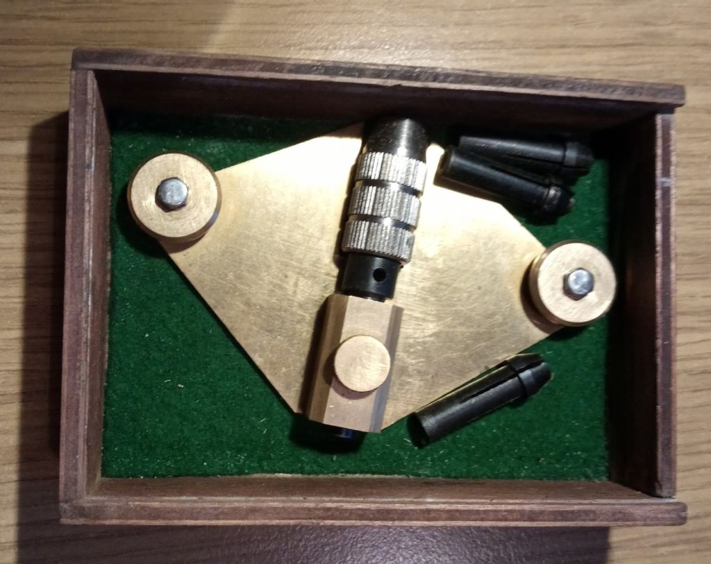

      Hi,
      I bought a second hand Myford super 7 lathe recently and the item in the photo came with it. I have no idea what it is or what it would be used for. Presumably something for model engineering as the chap I bought the lathe from was into making model loco's.lathe accessory.jpg

        #519748
        Alain Foote
          @alainfoote90915
          I think it is a drill sharpening tool.
          #519754
          Alexander Smith 1
            @alexandersmith1
            Look up wishbone drill sharpening jig. It's for very small drills. There's a thread on this site but I don't know how to reference it. Perhaps someone could add a link please.

              #519902
              Hopper
                @hopper
                Plans for a similar 4 facet drill sharpening jig were in MEW a good few years ago. Might be in the index online.

                  Thanks all for your rapid replies. I'll follow the link above to work out how to use it.
                  Take care.
                  #519957
                  Bizibilder
                    @bizibilder
                    The picture is of John Wildings home-made version. Full description was in ME a few years ago.
