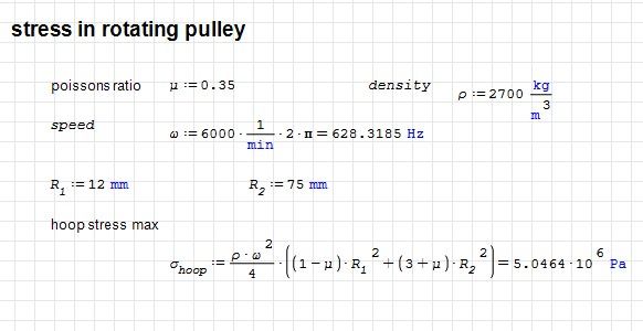

                    How critical is the application in terms of load and RPM? Aluminium pulleys are usually cast, not fabricated, because die castings are less likely to burst. And if the pulley will be worked hard, or take snatch loads, the alloy needs to be tough enough not to fail at the shaft fixing.
                    No problem making small diameter slow RPM pulleys from 6082 stock where the stresses are low, but I'd buy the commercial product if the pulley was to be spun fast or heavily loaded. Big stress difference between a 3" pulley fitted to a 1000W lathe chugging along at 600rpm, and the same item pushed over 6000 rpm by a 50kW car engine.
                    A genuine Picador pulley is probably significantly stronger than a home-turned copy.

                                  Several people have stated that a high speed pulley will need a very strong material. It's worth doing some sums. This is not going to cause me any sleepless nights, less than half a ton/sqin. It's not surprising really, at the other end of an IC engine is a much larger flywheel, which is made out of a much denser material which seems to survive OK. In case you feel like exploring further note that some sources use the reciprocal of Poisson's ratio, so instead of (1-u) they have (1-1/m), which causes a bit of confusion.

                                    I did take Dave's warning with a very large pinch of salt. So thanks Duncan for the supporting calculation!

                                                It is what I meant.
                                                The grain structure of extruded or rolled metal stock runs longitudinally, and making stock stronger lengthwise than across the diameter. Not ideal slicing stock to make pulleys, because pulley forces run the other way – centre out
                                                Stock is strong enough for a slow turning, small diameter pulley, but unwise for a large diameter pulley spinning at high RPM. It's better to make pulleys with a process that makes the item strong in the right direction, such as by casting or drop forging. In the past the flywheels on big steam engines often burst because they weren't strong enough.
