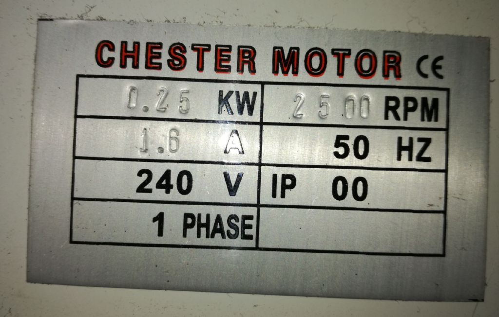

      I've just blown the fuse on the front panel of my conquest super lathe. I can see the fuse is F rated but can't read the current. Does any know what size fuse is required.

                Hi Eric, you should have a ratings plate somewhere, which should tell you the amps that it takes. I have the standard Conquest lathe, and the ratings plate on mine is on the motor cover at the back of the machine.
                I think these machines are very similar, and mine has a 5 amp fuse fitted.
                Regards Nick.
                #650120
                  That all seems very logical yes
                  1.6A < 5A < 10A … in all the right places.
                  **LINK**
                  https://uk.rs-online.com/web/p/cartridge-fuses/5413108

                    Hi MichaelG, I suppose I should have said it is a F5/250V 6 x 30mm (1/4" x 1-1/4&quot glass cartridge fuse, but I guess it's electrical characteristics are the same as the one you've linked too.
                    Regards Nick.

                          I've just called Chester and they said a 13amp fuse would be ok. seems a bit high as the motor on my WM14 mill is protected with a 2amp fuse.

                            Arc Euro sell fuses dor the C2 and C3 lathes (Which is what your Chester Conquest is; a Sieg )
                            They shpuld be able to advise you, and supply what you meed.
                            For a motor that is reported to draw 1.6 Amps, a 2 Amp might not withstand the start up surge, but asl Ian or Ketan at Arc.
