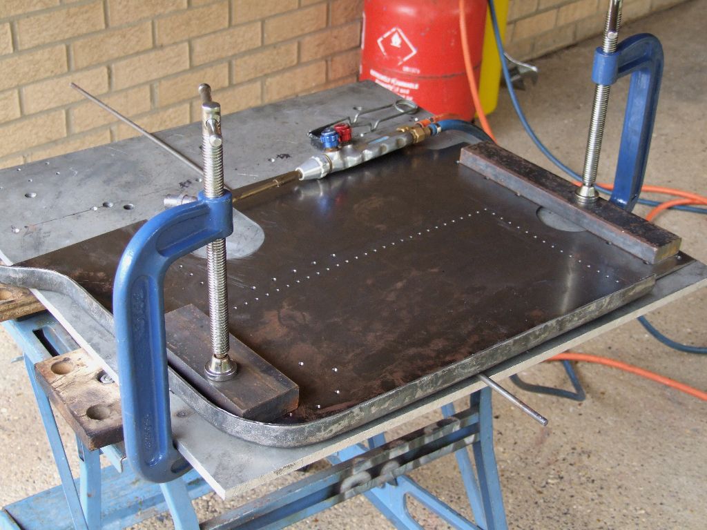

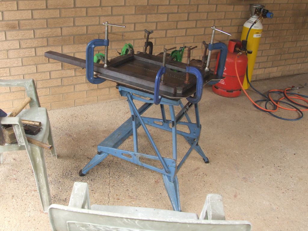

                        I stopped posting about progress on my traction engines on here some time ago. However, yesterday at the Forncett Steam Museum model engineers day, I got a flea in my ear about not posting. Sadly I didn't get the name of the gentleman that gave me said flea, or more likely I've forgotten it.
                        Over the summer I have been busy in the garden and flying. For both gliding and power I needed to do revalidation flights, and CAA paperwork in the case of power.
                        More recently I have been working on the tenders for my engines. The first job was to machine, and flange, the sides from 3mm steel sheet. For economy reasons I used oxy-propane for heating rather than oxy-acetylene. Previous duff attempts had shown that I needed to use a lot of clamps. Initial flanging was done with a home made wooden mallet, followed by a steel bolster and copper mallet to tap the flange into close contact with the steel former:
                        After forming the sides were convex, due to the flange shrinking as it cooled. Ideally I wanted the sides to be slightly concave as this would make assembly easier. The distortion was removed by clamping the side over a steel rod, heating the flange to red along it's length and then letting it cool. Excess concavity was removed by heating an inch or so of the flange and letting it cool with the plate unclamped:

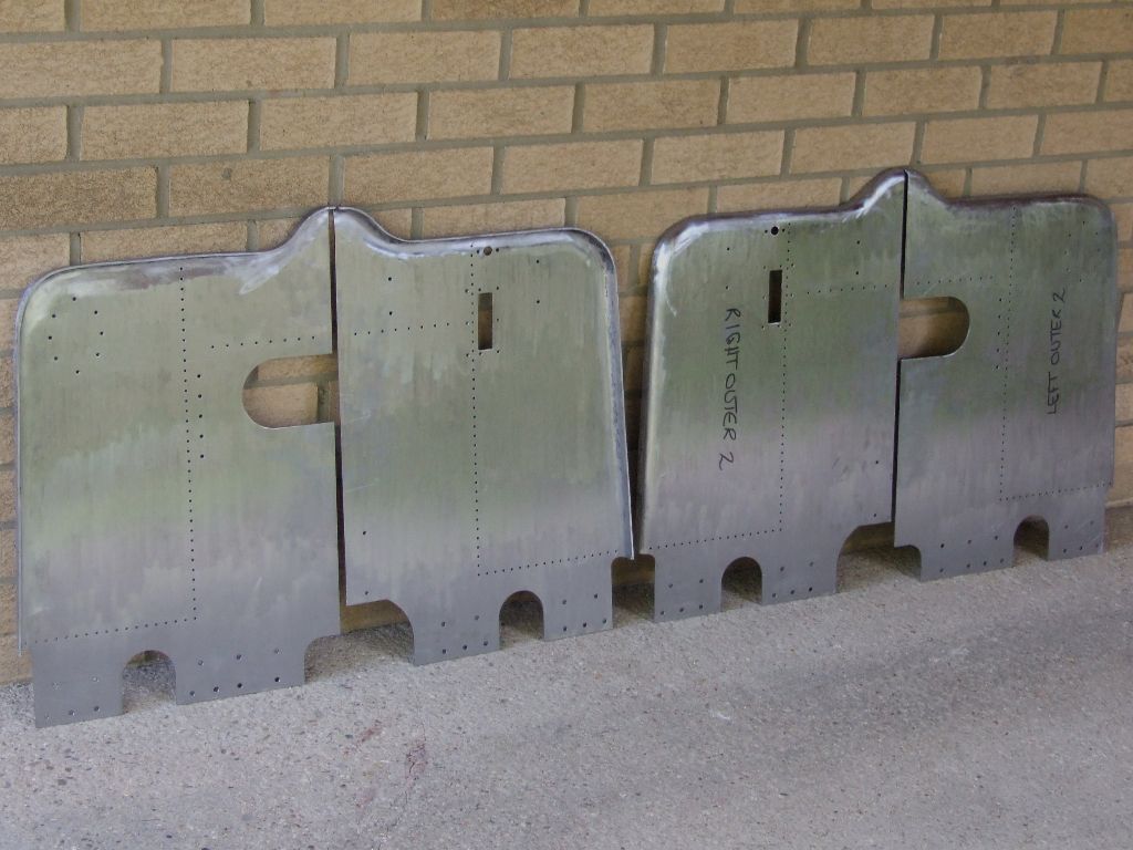

                        All four sides flanged, the flanges machined to size and cleaned up with files and an abrasive rotary wheel in the electric drill:

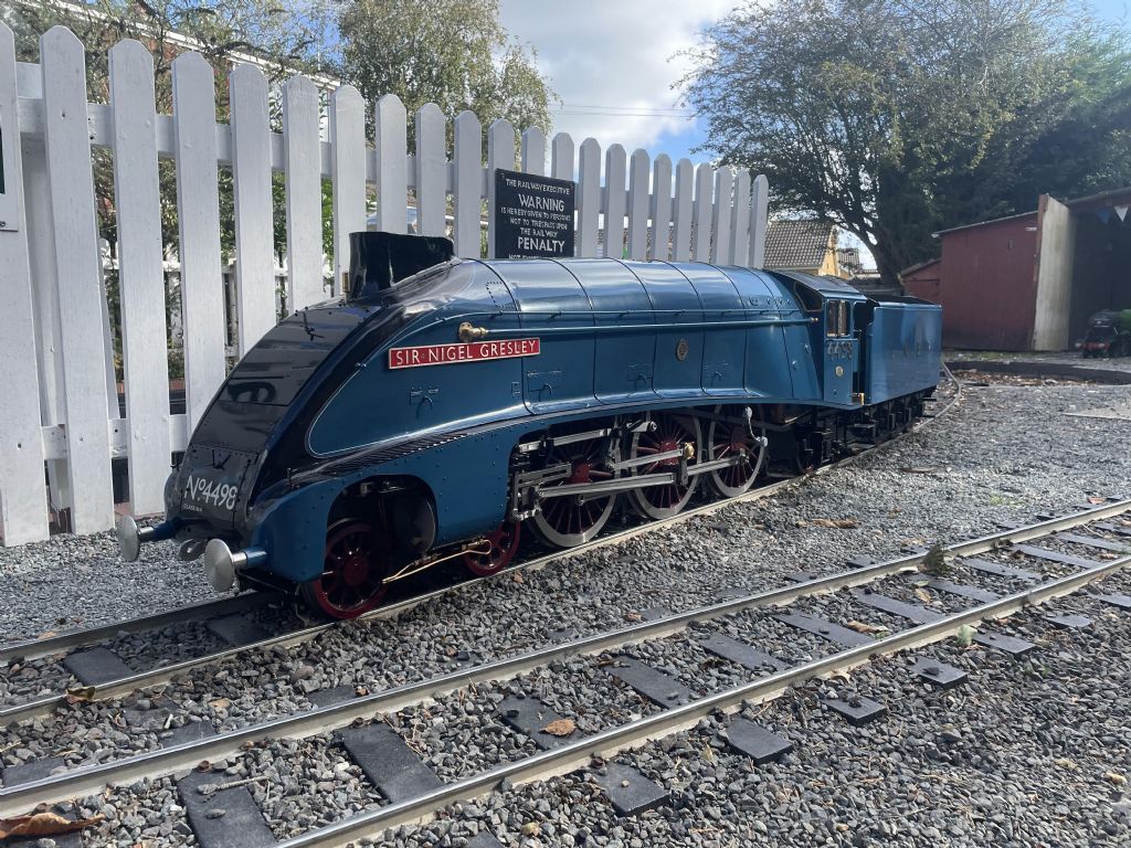

                                  Hi Andrew, nice looking work you've done there. Don't let those snidey ones get to you, they are probably just jealous. Keep on posting about your traction engines as they are interesting, and the methods you use can help a lot of people.
                                  I like your Sir "Nigel Gresley" Brian, I've travelled behind the full size one a few times.

                                            Andrew, looking at the pics of the tender sides leaning against the wall, it looks llke you will have a RH and LH set, judging by the cut outs. Just curious why that should be.
                                            Keep up the good work. Chris Gunn

                                                    Anonymous
                                                      Posted by Chris Gunn on 03/10/2023 21:43:23:
                                                      …it looks llke you will have a RH and LH set, judging by the cut outs.
                                                      I'm not sure I understand the question?
                                                      I am building two engines, hence four sides in total. The right and left hand sides are different. The RH side has the rectangular cutout for the water pocket. The LH side has the bigger cutout at the top so the driver can get into position without damaging himself.
                                                      Andrew
