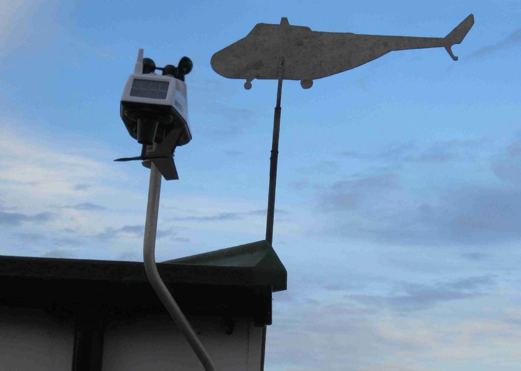

      Not exactly today, but have, at long last, finished the 'nostalgia indulgence' for the weather vane and the 'Office'. One in brass and one in aluminium. Happy days!!

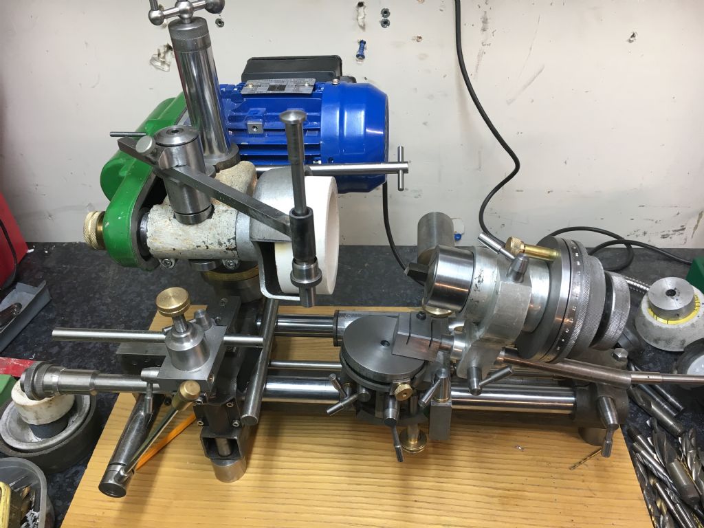

          Finally got around to a trial assembly of a much modified Quorn based on Mk2 castings. Still some work to do but the end is in sight. A trial grind on a few drills (4 facet) and HSS lathe tools showed promising results. Not quite got the right settings for the drill geometry so need a little more thought on that and maybe a setting jig for consistent results.

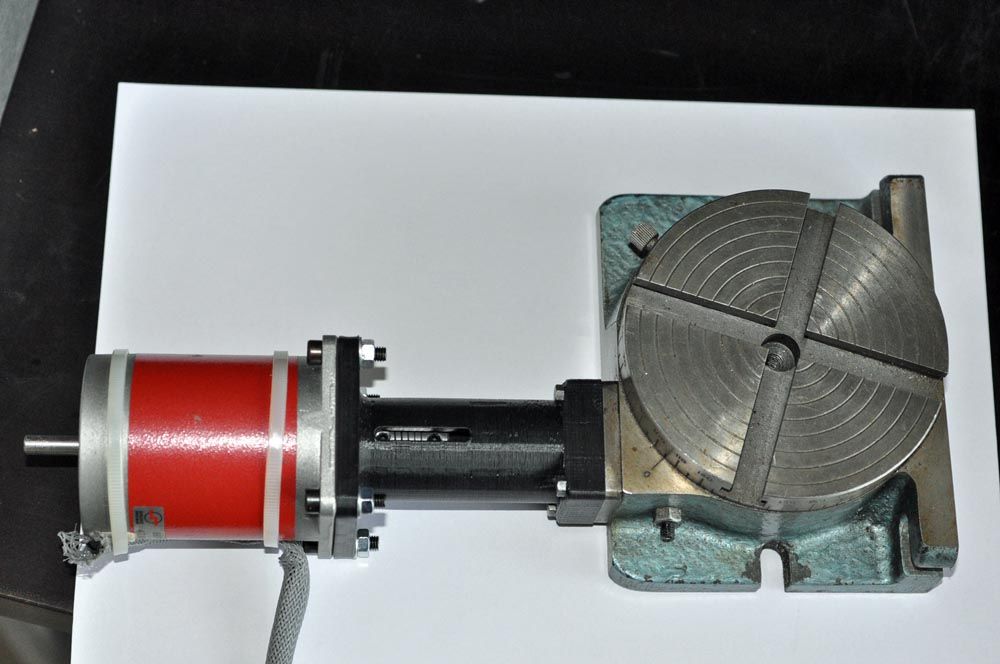

                                    I took advantage of ian p's advert on here for a Steve Ward Rotary controller to attach to my 4" Sharp rotary table.
                                    I'd really only intended this 3D printed connector as a prototype prior to fabricating something in steel but I think it might be robust enough to be a permanent fixture – we shall see!
                                    It all works really well. Ian, you clearly did a nice job of putting the controller together.

                                      Well that is a surprise, as I was not aware that I had advertised Steve Webb's controller, or anything else on here.
                                      JS (very much missed!) sold me one of his boards and a programmed ICs which I made up in a casing complete with and old laptop external PSU. The casing front and back were actually the discarded lids off two scrap ABS electrical enclosures (black rectangle on the front panel is the stepper driver heatsink).
                                      I think your printed motor mount is more than man enough for the job and a metal version would not perform any better. Is the slot purpose to give access to the coupling grubscrews?

                                        Rod… what material did you extrude on the 3D printer to make the extender/adapter for the stepper motor & rotary table?

                                          Whoops, sorry – Ian J not P. Bit of a coincidence though!
                                          The connector housing is PLA – I haven't investigated printing ABS yet. And yes, the slot is to get at the grubscrews on the flexi connector joining the 1/4" stepper shaft to the 3/8" rotary table shaft. The flexi connector was an Ebay purchase, 6.35mm to 8mm which I had to drill out to .375". The handle on the RT controls the worm engagement so I also had to make a collar with a locking screw to fit on the shaft inside the housing. That was the first engineering job in the new workshop smiley.
