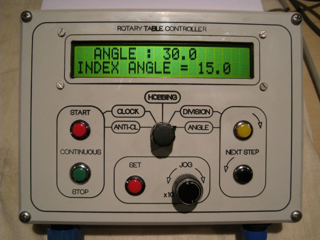

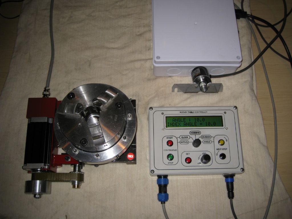

                      Have finally completed my stepper driven Index table/hobber mechanics and the associated electronics/controller.
                      Photo below shows the table, stepper powers supply and driver enclosure, and the controller unit.
                      The controller is based on an Arduinio look-alike – the NUCLEO, using a 32bit STM processor. The module costs around US$10.00. The control box is a plastic box, 200mmx150mmx35mm.
                      Modes are:
                      RPM mode – rotate continuously clock or anti-clock at a selected RPM ( up to 30RPM)
                      Hobbing – normal continuous Hobbing mode, using the encoder above, driven by the hob spindle.
                      Division Mode: – Set the number of segments to divide a circle into and step clockwise or anti-clock segment wise. The current segment is also displayed.
                      Angle mode: – Set the angle to step, and then step that angle clock or ant-clock. The accumulated angle is also shown.
                      The Jog encoder wheel also rotates the table for manual positioning to a specific point or angle.
                      Now, what to do with this thing…

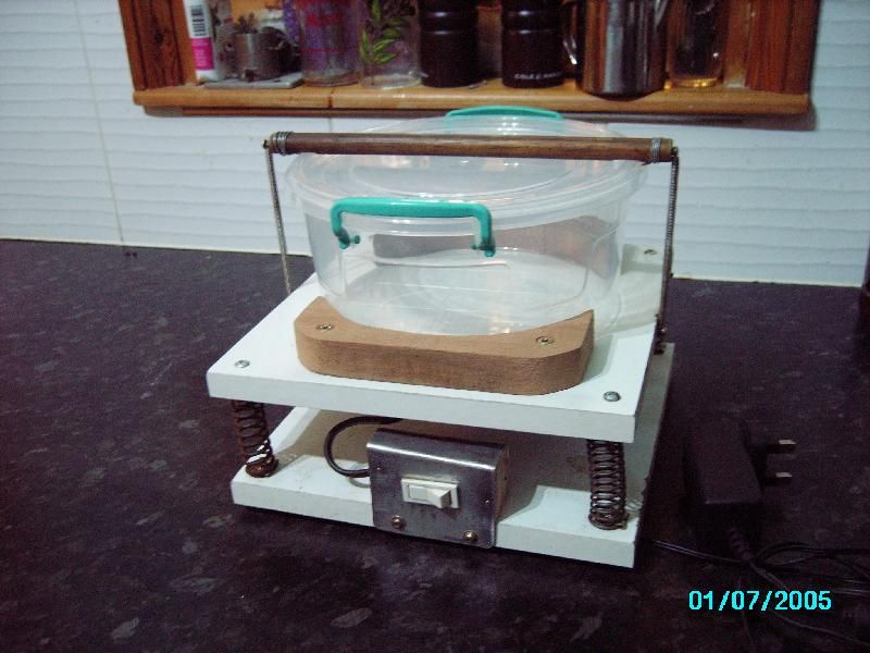

                                    Phil Whitley
                                      @philwhitley94135
                                      Made a vibratory polisher for my daughter to polish her special stones with! the plastic container lifts off so that she can have different polishing medium in seperate bowls, thus avoiding the mess!

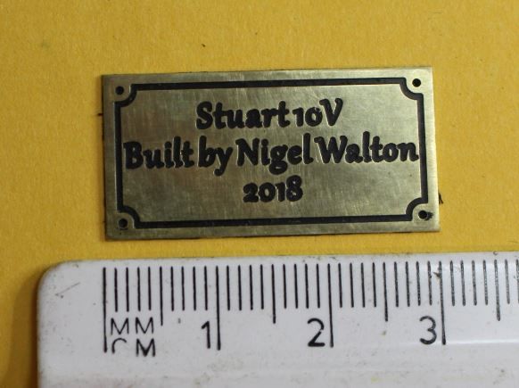

                                              Another small name plate done on my home converted cnc mill. Very happy with this result.

                                                Posted by Phil Whitley on 06/12/2018 19:42:10:
                                                Phil
                                                I'm intrigued, how is the vibration generated? Is it a simple eccentric weight on a motor driven shaft of some description? Also how do the plastic containers stand up to the ravages of the various polishing mediums?

                                                  Posted by tractionengine42 on 07/12/2018 10:59:07:
                                                  That's very neat. What size/sort of cutter are you using?

                                                      Andrew, I'm using a 0.2mm/20 deg point carbide engraving cutter at 20k rpm.
