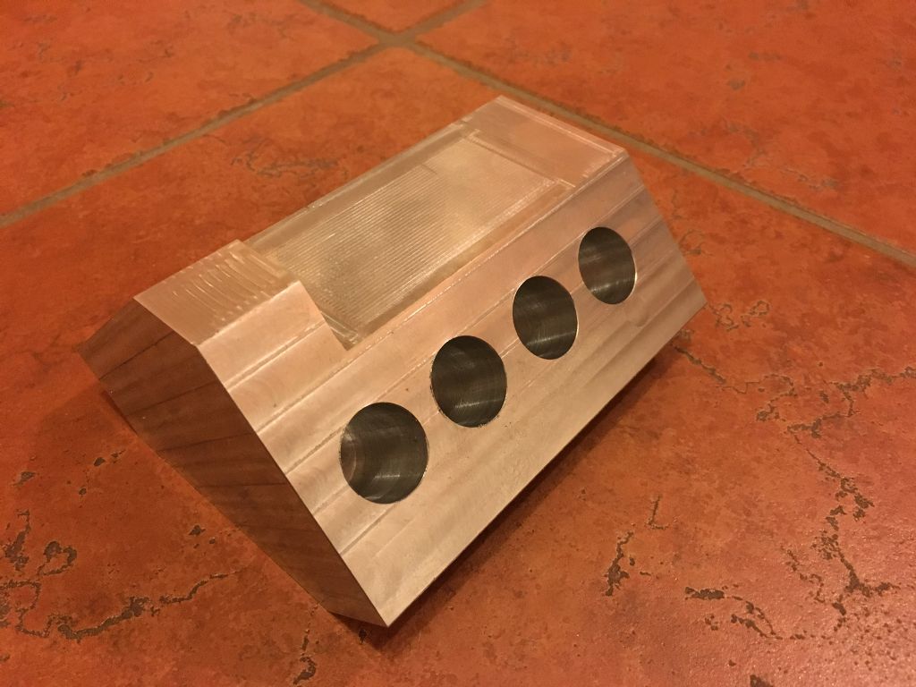

            I bought alength of 7075-T6 bar a couple of months ago because it looked like it had the block for a V8 engine buried inside. After making a considerable amount of swarf, look what I found. I have roughed it out to allow any built-in stresses to relax before machining to final size.
            Rough Block
            There is a lot more swarf still to be removed, but it is at least starting to look the part.

              I take it that is a 'small block' V8 wink

                If I have done my maths right, it should come in at under 50cc. So yes, a very small block V8!

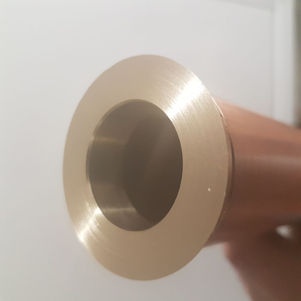

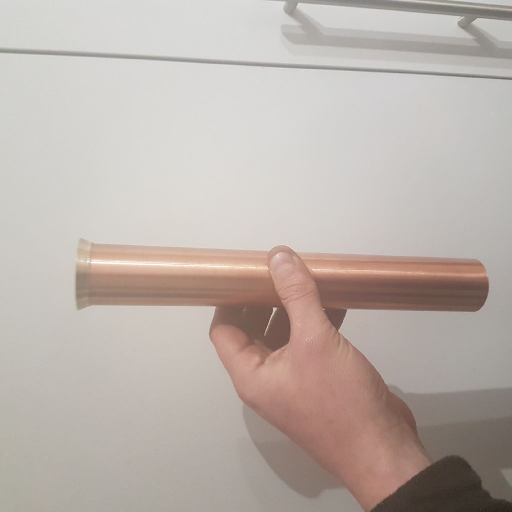

                                  Don't ever try and thread the end of an aluminium tube overhung by 7", it will bend away from the cutter and make it VERY difficult. i had to surrender and move the steady, even though it meant ruining the surface finish of the last 10mm so I had to rebore it 10mm deeper.

                                    Could be worth turning up a top hat shaped plug to fit in the tube so you can use a tailstock centre to steady things.

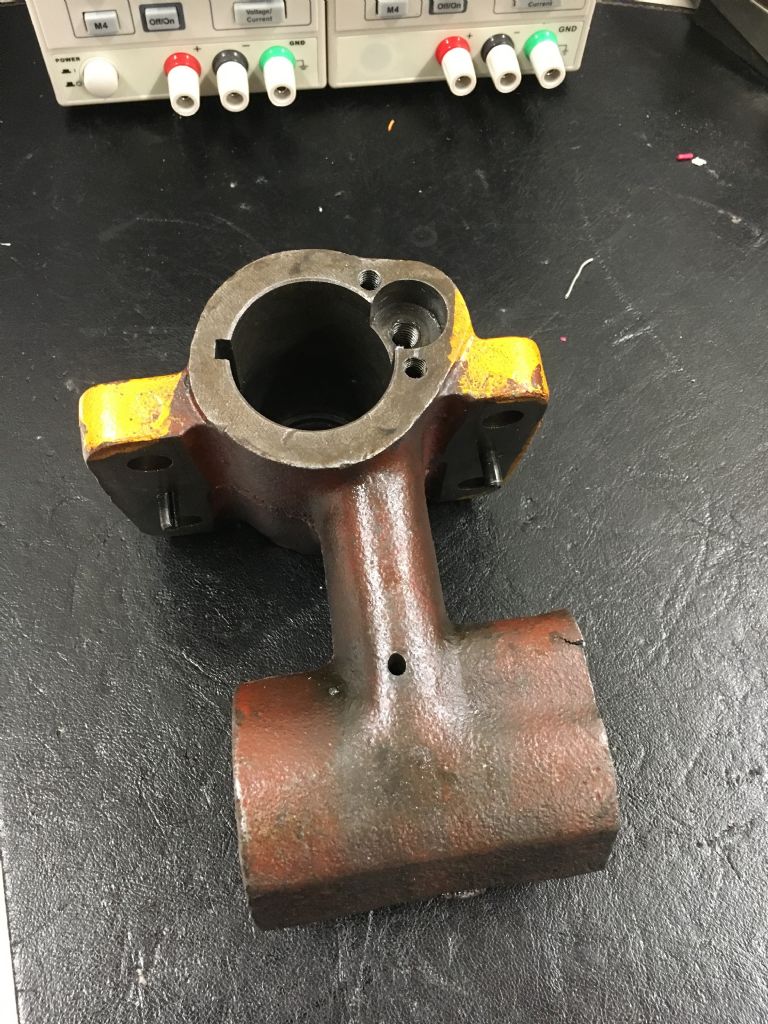

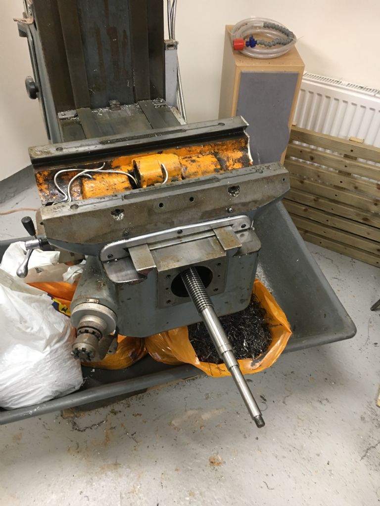

                                      Went out into the workshop last night and stripped down the table on the Bridgeport clone. I have had new ballscrews for the X and Y axes waiting to be fitted for several years now. The CNC conversion was delayed by our move back to the UK, then by the purchase of a proper CNC machine. I have 90% of the conversion parts made now and the original leadscrews have pretty much had it now. A DRO makes up for a lot of the backlash but surely the ballscrews will be a vast improvement and will allow me to make some progress with the conversion to CNC. I have to retrieve the "yoke" that holds both the X and Y axis nuts so I can machine it out to take the very slightly larger diameter ballnuts.
                                      Took almost exactly an hour to remove the DRO, power feed, handles, leadscrews, table and finally liberate the yoke. Biggest challenge was sliding the 42" table across to the left to disengage it from the dovetails, given the lack of space. I may move the machine out from the wall before refitting but for now it gives me more space to work.
                                      Here it is. I checked previously that it is small enough to swing on the bantam faceplate. I need to bore both them out to 40mm bore, so annoyingly, that's only 1/4mm – so near and yet so far. But I need to add fixings for the flange of the ballnut anyway.

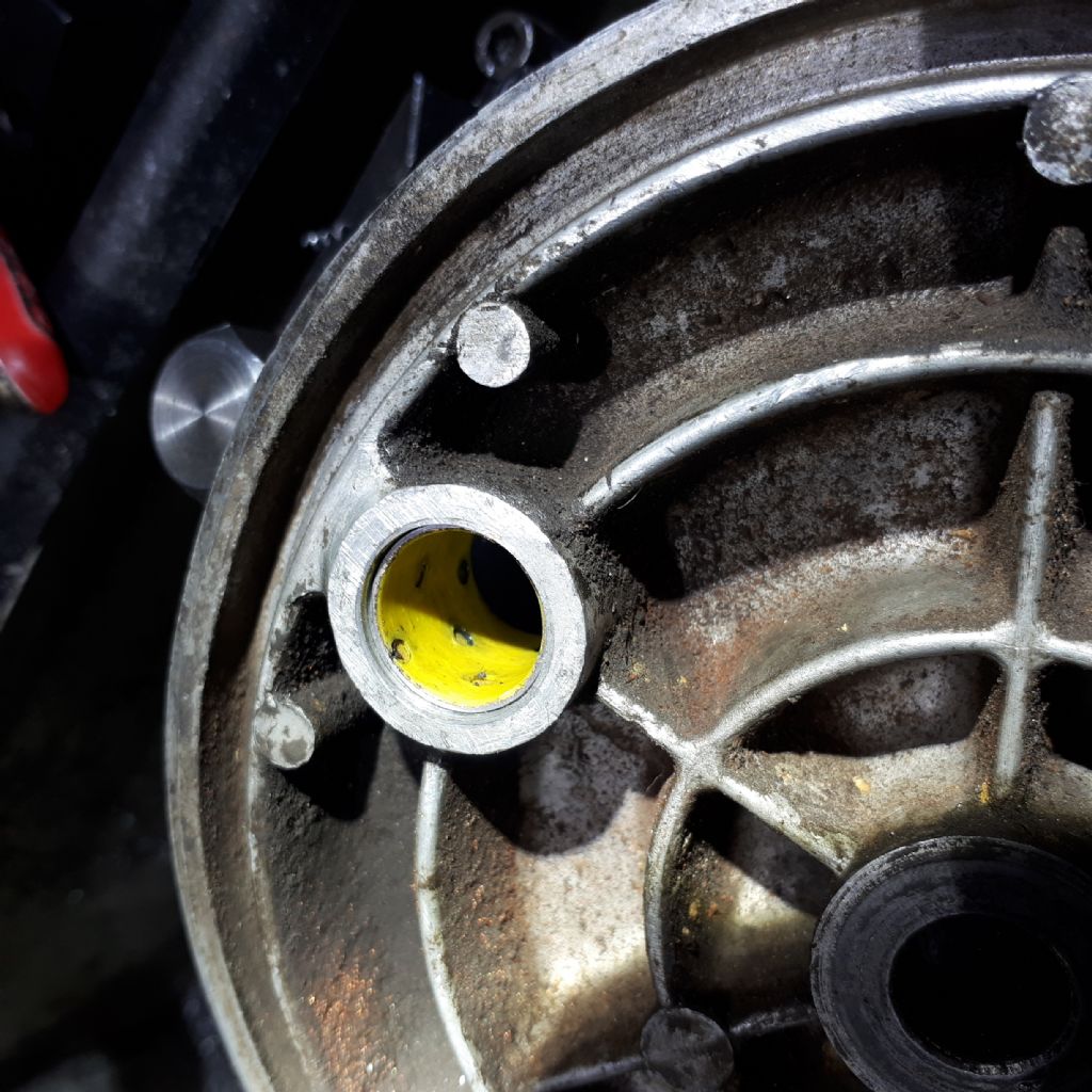

                                            20180127_120701.jpgNoticed there was a bit of slop in the brake arm shaft bearing, runs direct in the alloy. So fitted a bush. When I tested with a piece of 14mm SS bar there was no free play but when I refitted the brake arm shaft there is still a little bit of play. You can see the wear on the shaft. Thinking of getting a TIG welder with my 25 years of servitude money and have a go at TIG brazing!

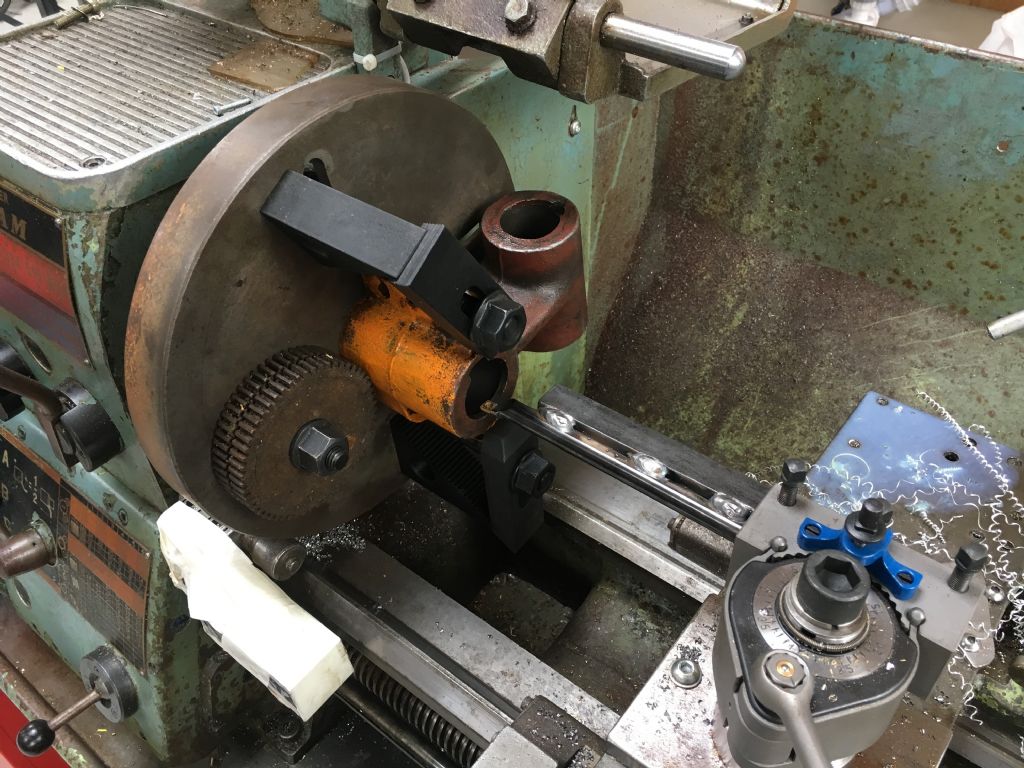

                                              Machined out the bores in the yoke (see earlier post). Had to make up a long boring bar by welding one of my SCLCR bars onto a piece of 3/4" square BMS. Worked very nicely and I took them out to 40.1mm which gave a nice sliding fit.
                                              Long boring bar
                                              Refitted both ballscrews and reassembled the machine. No dramas or grievous cockups. I'll need to make up a spacer for the X axis handwheel, as I designed the ballscrew to accommodate a toothed pulley which isn't fitted yet. Although I haven't formally meassured it, the backlash on the Y axis has gone down from a large fraction of a mm to something of the order of 20um (~1 thou). That's a massive improvement.
                                              Back together
                                              I'll refit the DRO, way covers etc later. Been up since 7, so time to call it a night.

                                                Posted by Mark Rand on 27/01/2018 22:05:33:
                                                Internal thread!
                                                A better approach would have been to thread it with support before turning that outside, which is effectively what I did, fortunately it was long enough to lose the last 10mm.

                                                  Posted by Neil Wyatt on 29/01/2018 07:40:22:
                                                  Internal thread!
                                                  Oops, wouldn't have worked very well with a tailstock centre in the way…
                                                  Then you have the problem that aluminium extrusions are never round, so you neeed to turn the outside to use a steady anyway. crying.

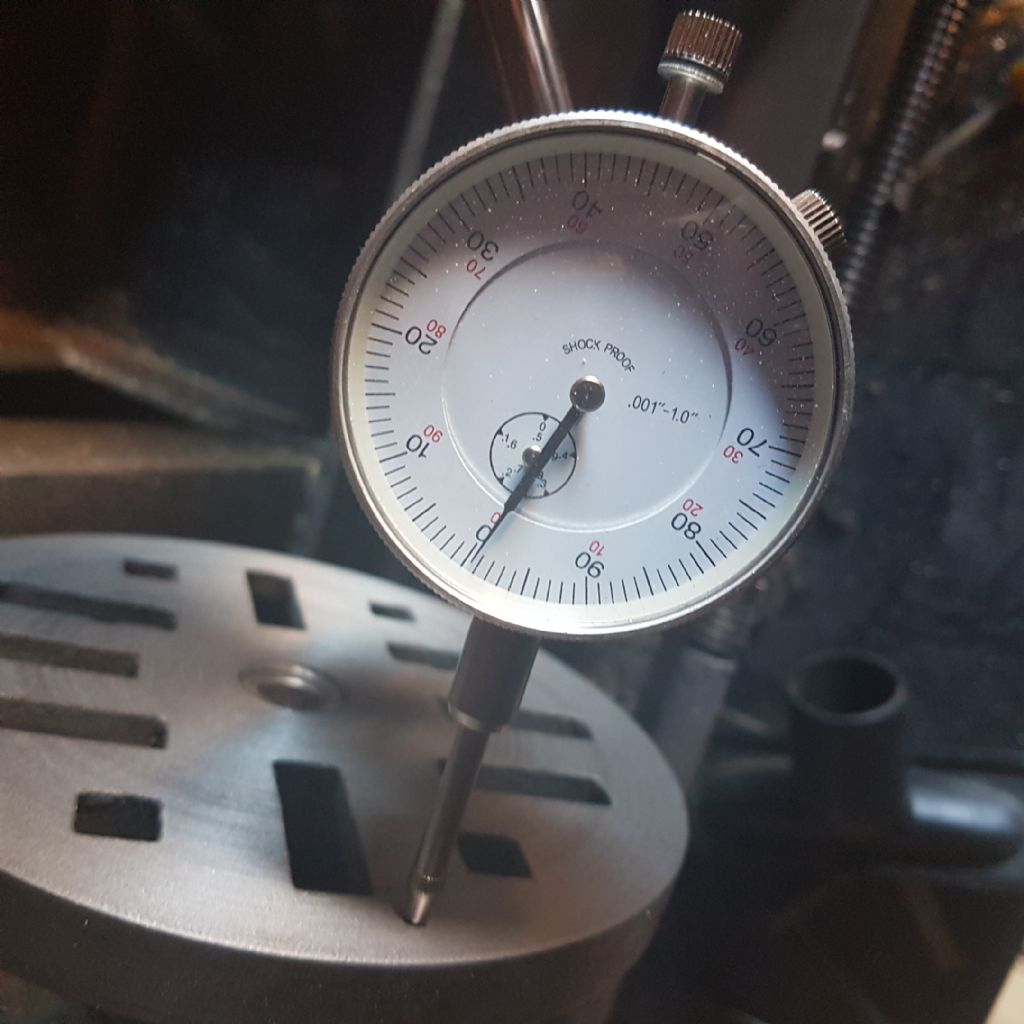

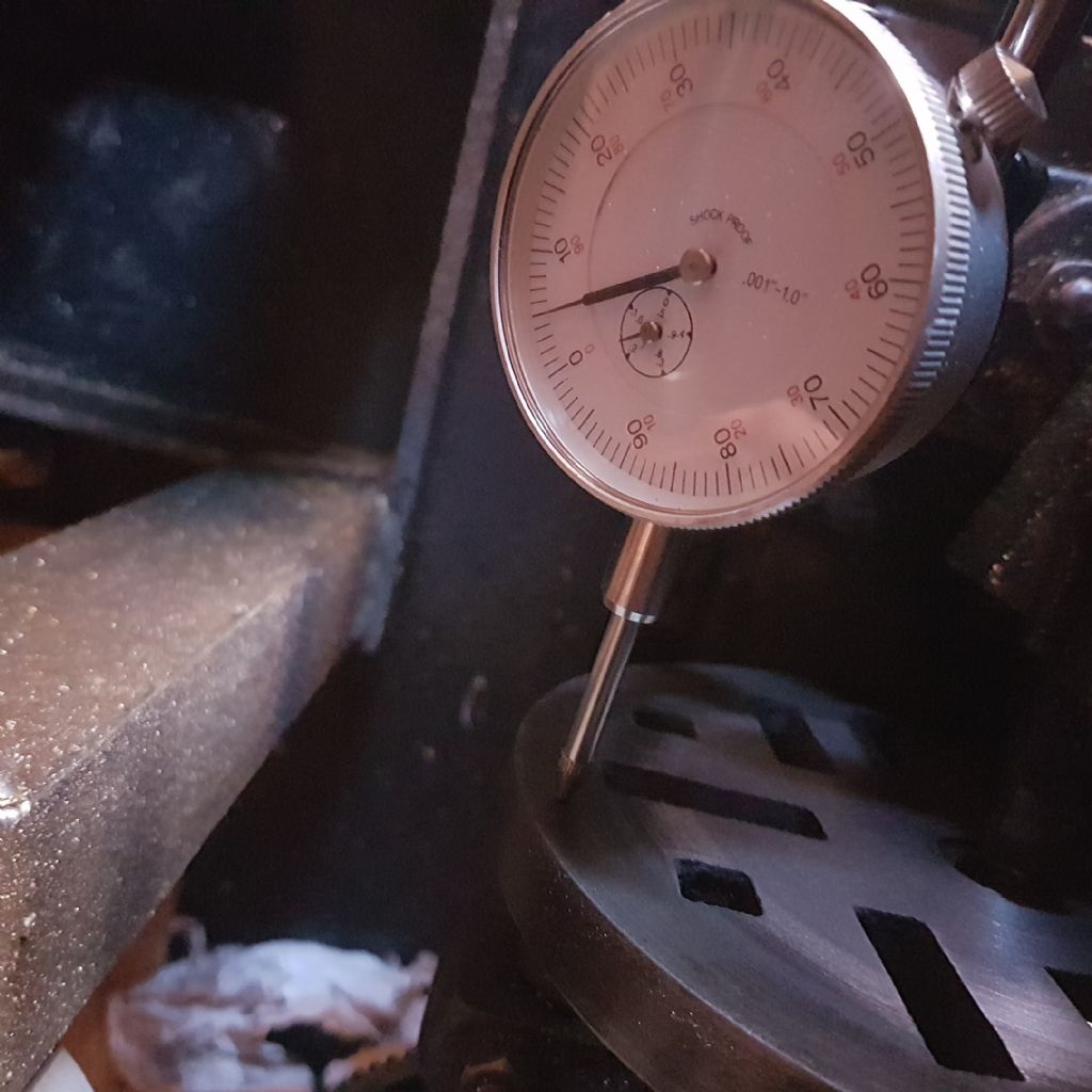

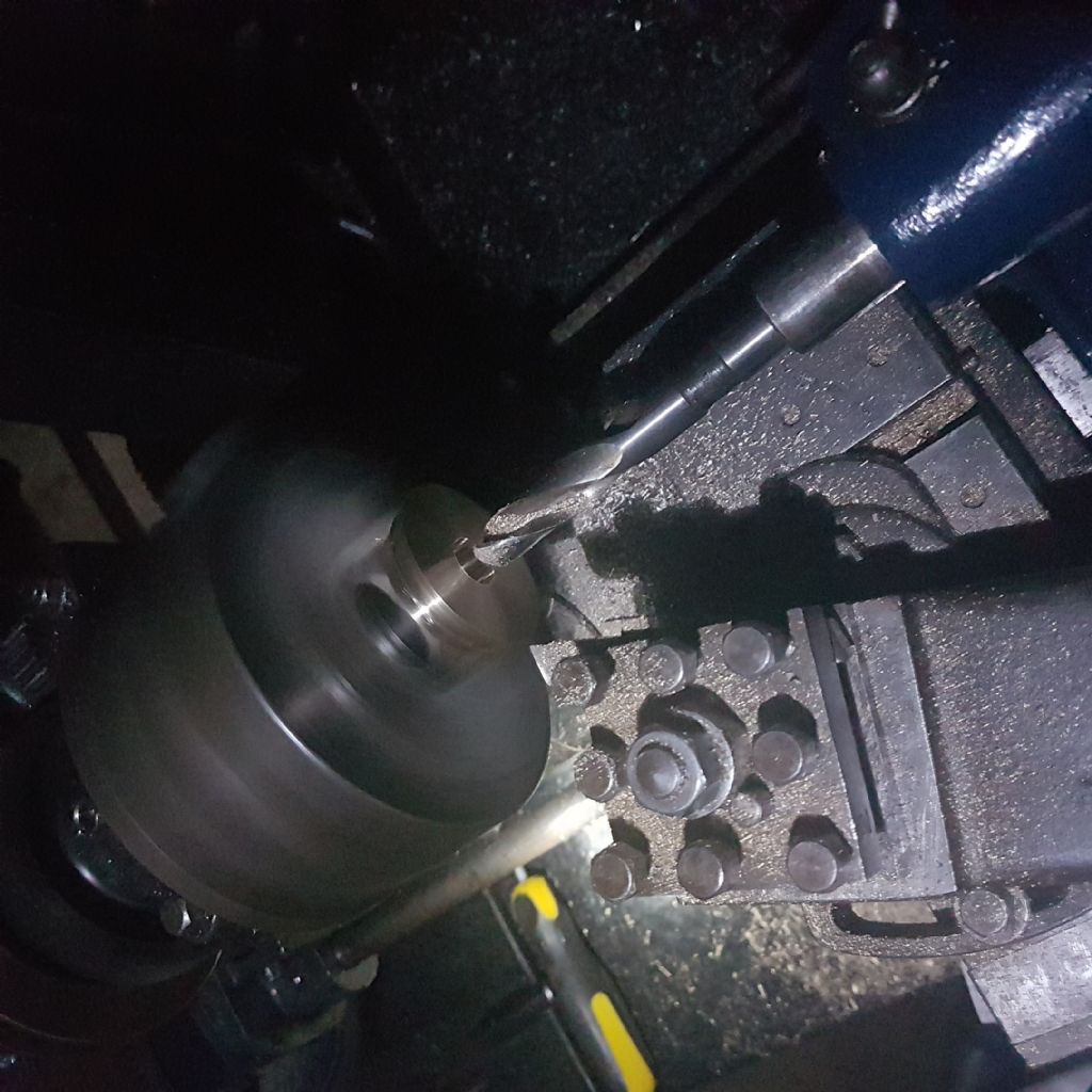

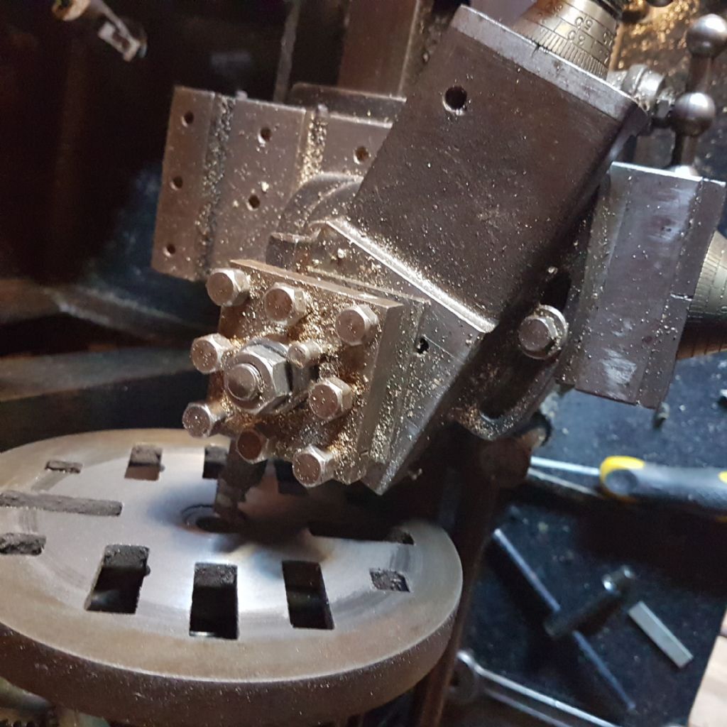

                                                      Faced off my faceplate, the faceplate didn't look as though it had ever been skimmed.
                                                      Before
                                                      During

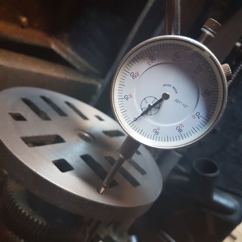

                                                      And after. Less than 1 thou out over the 7" faceplate. Not bad for a knackered old machine
