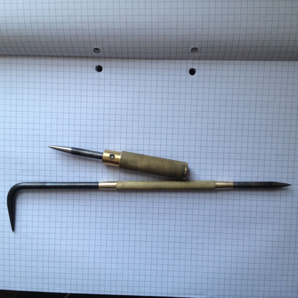

        Slow start to the year, no progress on my engine but, I decided that I NEEDED a scriber. The bent one is a little large but it was what I had. I will sound daft to a proper engineer but I'm quite pleased especially with the hot oil blue using recycled vegetable cooking oil. The straight one was made with my Unimat4, now under the bench some time ago. Week-end sadly busy with 'domestics' Roll on Monday when I shall get on with Brian Rupnow's beam engine.

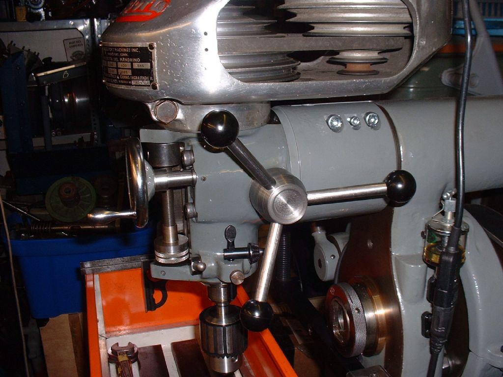

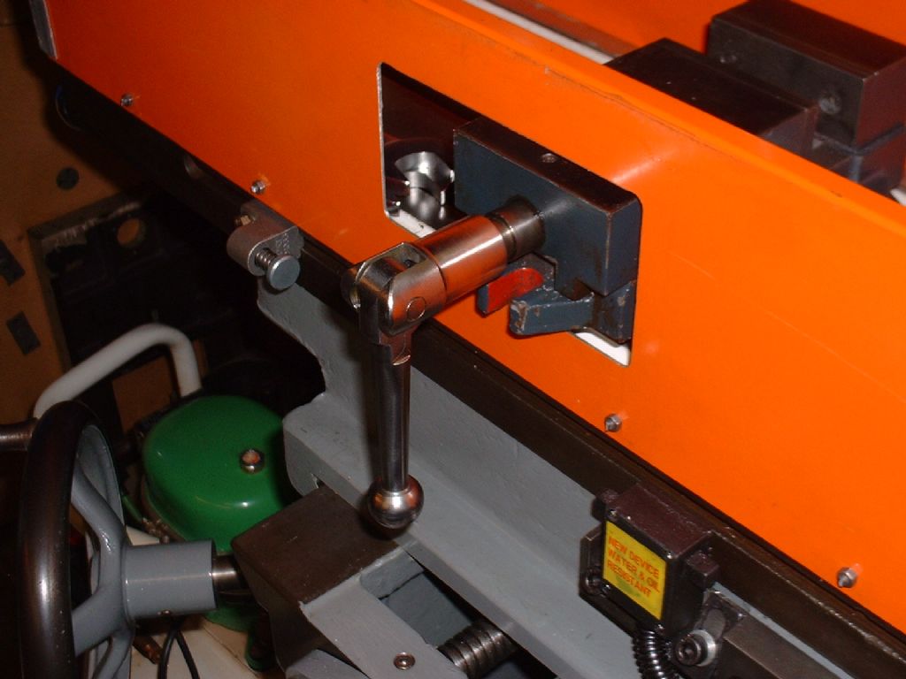

                                              Ancient milling machine improvements.
                                              Made a new downfeed handle inspired by my bench drill and vise handle inspired by Kurt.
                                              Don't know why I didn't do it ages ago!

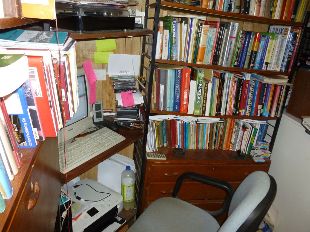

                                                'Scoop' Theasby's lair/mancave/publishing empire hub/ all tidy (Well, three days ago it was…)zpublishing hub.jpg

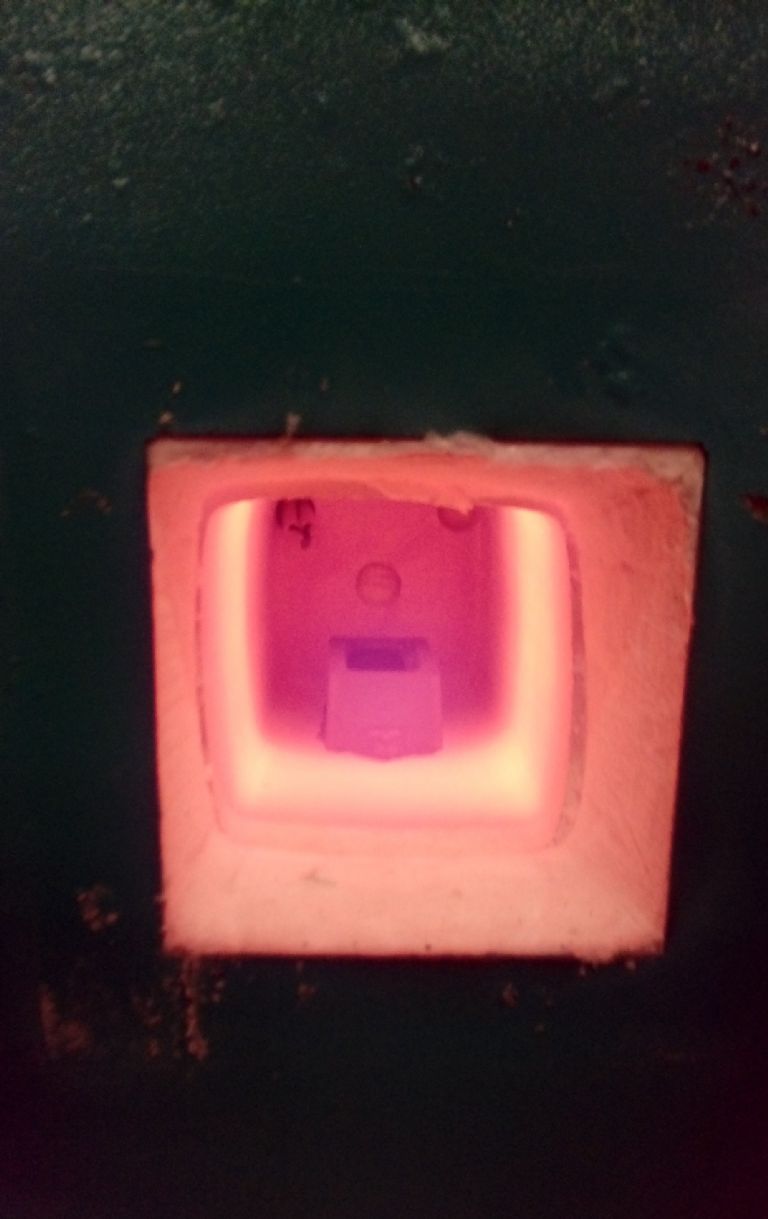

                                                  I also experimented on a few of the iron castings to see if I can stress relieve/anneal the iron castings in my muffle furnace:
                                                  So that's the door open, standing back a little distance, at over 700 degrees Celsius. I will leave it in there over night and when it's cooled off the following day I shall see if it has worked at all.

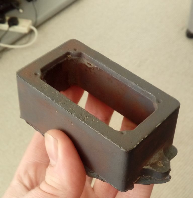

                                                    Just an update on my casting annealing experiment on a Stuart V10 casting.
                                                    So it's been roughly 12 hours since I left it in there at 700C. I checked the temperature gauge on the furnace to make sure it was safe to remove before I touched it. It was at 15C so it was safe to open it and take it out.
                                                    It has taken on a slightly dusty rust coating, all thanks to the cold night we've just had. But I think it has done something to the metal, because it has noticeably dulled in colour. and takes a cut very readily from a file. It no longer has the glossy coating.

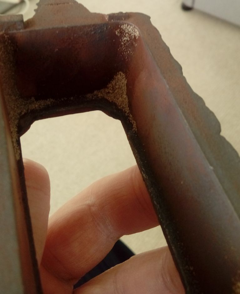

                                                    Another interesting thing…
                                                    The sand that was sitting just beneath the glossy coating has separated and completely dried out, revealing it's true colour and it rubs away too. So with a quick once over with a wire brush before cutting it will save my tools needing to go through the excess.
                                                    The real test of course, will be in the cutting.
