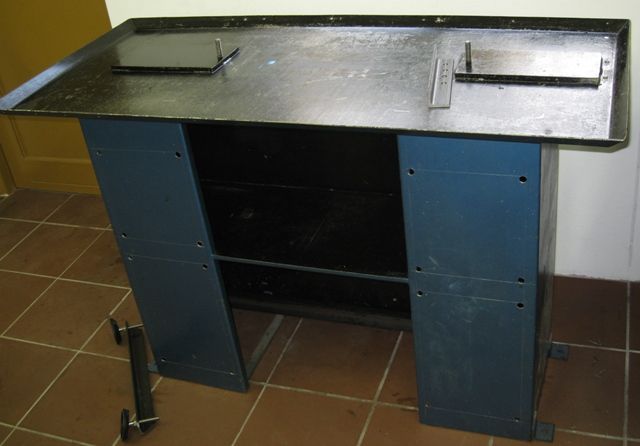

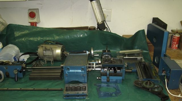

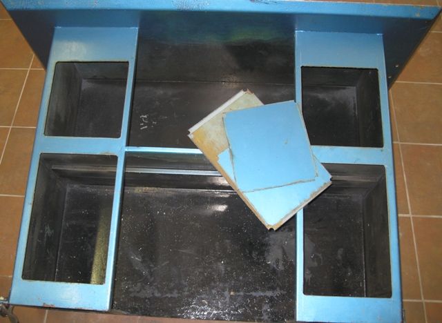

                    Progress at least..>>
                    My EMCO V10P refurb is underway. Aim is to strip and repaint everything, replace all leadscrew nuts, as well as cross slide leadscrew, fit my DIY Electronic Leadscrew system, fit the fancy Splash/Swarf guards, and completely upgrade the cabinet to add drawers and cupboards/doors, as well as a foot brake/switch system.>>
                    The headstock will remain intact as new bearings were fitted about 4 years ago and the lathe has not seen heavy work since. All other bearings ( screwcutting box, etc) were replaced at the same time as well.>>
                    Here is the lathe on its cabinet before all this starts:
                    The lathe stripped down ready to start stripping the paint. Anyone know of an easy way to strip hammerite paint???

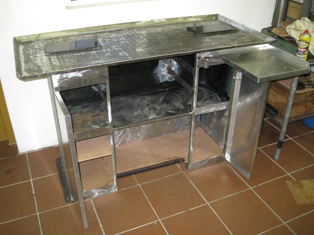

                    The start of the Cabinet Mods – making the cutouts for doors.
                    Door cutouts done – courtesy of the plasma cutter:
                    Cabinet partially sanded down to base metal – Now THAT is a dirty back breaking job! Bracing and shelf support have been welded on.
                    The aluminium fabricated doors and the swing-out tool tray have been added.
                    Showing doors open and tray swung fully out – place to put the vernier, mic, specs and espresso cup. And the remote control to turn Pink Floyd up louder!
                    Showing doors open and tray partially swung to closed.
                    2 drawers still have to be made and fitted. They will fit in below the swingout tray – the supports for the drawer slides are just visible 2 photos up..
                    Then to strip the lathe mechanics of paint, and then complete the sanding of the cabinet, and then prime and paint, and re-assemble all…
                    What a job!
                    joe

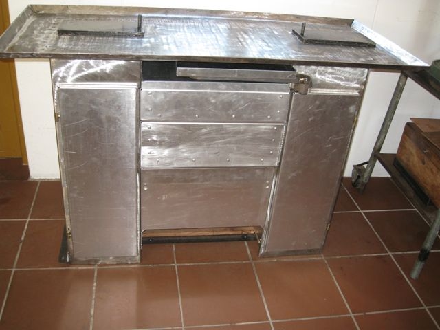

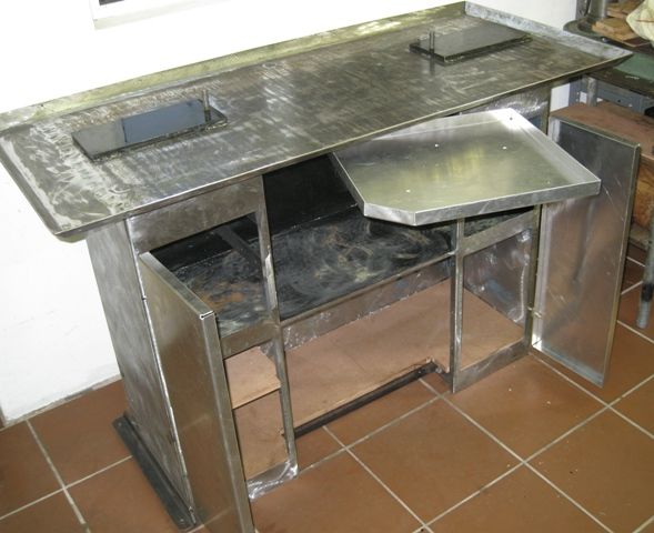

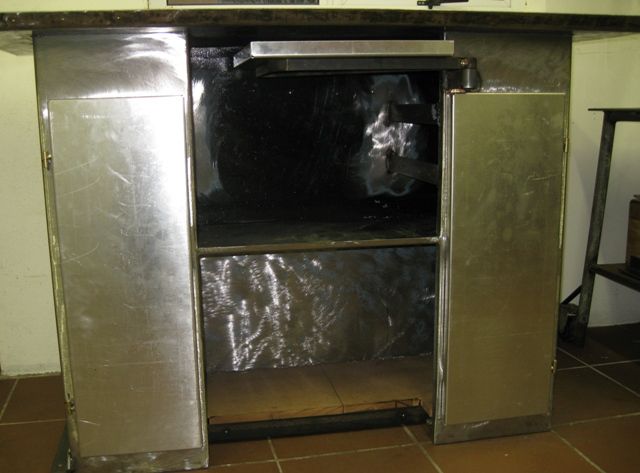

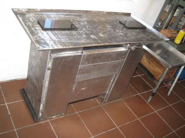

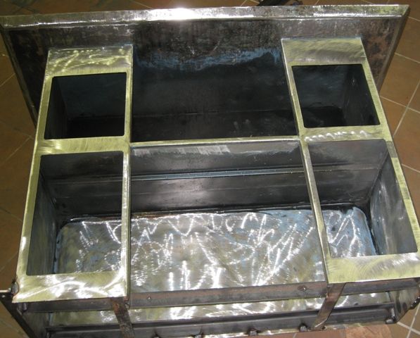

                                      The EMCO V10 Cabinet update is about done…>>
                                      Drawers were made today, and all the cupboard dividers made and fitted – all done now and ready to paint. Covered in plastic again till the rest of the lathe is paint stripped and ready for painting. The painting means that one car is moved outside, and the garage is decked out with plastic sheeting – walls and floor – Spray painting using a high pressure airless sprayer, so its a huge palaver. Therefore all the bits are prepped ready to spray in the one day!>>
                                      Full Frontal View…
                                      Lower draw is 150mm deep, upper is 120mm. Swingout tray is 35mm deep.Cupboards are 300mm wide.
                                      Every thing open:
                                      Swingout Tray open
                                      Swingout Tray going closed:
                                      Nuff of the cabinet – won't bore you all with more pics till the whole machine is all done, painted and together!
                                      Joe
