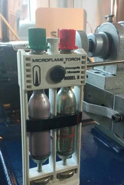

      I got a Microflame torch in a bot of bits at an auction a while ago:
      Thanks to JasonB (on another forum) for pointing out I can use squirty cream NOX but the torch wouldn't work. Turns out the needle on the NOX valve was broken and wouldn't puncture the canister. The torch is easy to take apart, Here is tThe NOX valve:

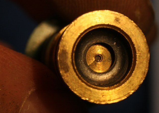

      And here is bottom view – a needle should be poking out of this hole:

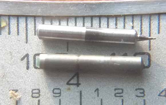

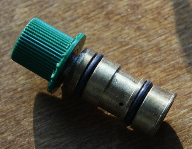

      The needle is glued to the valve knob assy in but I could pull it out. Here is first attempt (top) which I knocked up on a watchmakers lathe with a hand graver. Old broken one is below.
      2nd attempt gave better control but still room for improvement.

            Microflame torch – Does NOX = Nitrous Oxide? It does not in my language and I cannot see Nitrogen Dioxide or Nitric Oxide acting as an oxidizing agent.

                But found an old thread where someone else suggested the whipped cream which does seem to be NOS here

                      On research restricted to one product **LINK**
                      https://www.puregusto.co.uk/isi-cream-whipper-chargers-genuine-isi-n2o-cream-bulbs-10-pk-p531801-x719262.html?gclid=CPvd4Y3mxNACFUWfGwodNLUNGg
                      They are described as being filled with N2O
                      Some useful info. here:
                      http://modeleng.proboards.com/thread/4994/gas-cylinders-microflame-miniature-torch
