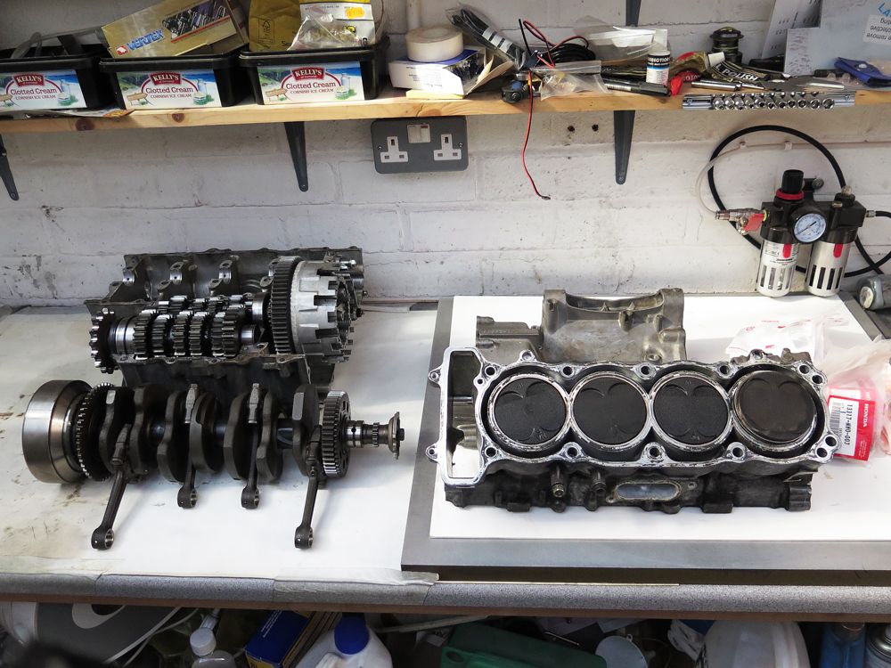

            Hi Sam,
            It's sort of ended up on my bench by default somehow. – It arrived in it's stripped state as you see with other boxes containing ( hopefully ) all the other parts. So it's presently just plonked there.
            What has happened is the owner who is a friend of mine has made a custom bike and it's power unit was the above engine. The bike looked great except for the grubby engine. First time out on it he rode it some distance and it started playing up with trouble changing gear and the clutch. – He decided to try to get it home. ………. Big mistake.!!!
            Turns out the clutch plates had started to disintegrate (so he says) and the fragments ended up blocking the oil pickup and filter. This of course resulted in oil starvation to the engine. ………. Engine seized.
            He then decided to strip he engine himself. This was never going to end well as although Jake is a really fantastic guy a mechanic he ain't unless it is something that can be fixed with a lump hammer.
            In brief the crank and it's bearings are destroyed in a right royal fashion. Incredibly there seems to be no damage to the camshafts and bearings or the pistons, liners etc.
            Enter Paul who is another friend of mine and a mechanic with many years of working upon bike engines. Who normally would not even glance at an engine somebody else had stripped. But as it's for a friend of mine he will sort it for him. Hence me in the middle and why it's ended up on my bench with Paul having his own projects on the go presently upon his bench at home.
            Another crank and conrods have been obtained as I am told these are matched with each other and then colour coded bearings each having a very slight diff in tolerance are purchased with each individual engine requiring a different combination. i.e. there is no 'off the shelf' standard set that can be purchased, they have to be purchased individually as required.
            Paul has also insisted that he is not willing to rework the engine unless it's totally stripped and all the casings sent away to be vapour blasted into cleanliness first. – Obviously other parts will be needed either as an essential or precautionary such as timing chain etc.
            So that is how it's ended up on my bench and me in the middle who's only active role in it's rebuild will be making coffee. wink

                Nick
                Vapour blasting. ? Presumably something like superheated steam to clean any stains etc so all the parts come up like new. Seems like a good idea
                But if you strip the lot how does he get each bit back to its matching part, or are they all machined so accurately that they will fit anywhere, Apart from the bits being bought in of course
                Matching it all up if one has not stripped it would be a nightmare if one did not know a lot about that engine
                Must be a good mechanic
                #251305
                Nick_G
                  @nick_g
                  Posted by Sam Longley 1 on 18/08/2016 10:48:46:
                  Nick
                  I am not sure on what vapour blasting entails, but it's just being done to any external cases. Perhaps someone more knowledgeable than me could explain this.
                  It was not 'totally' stripped. i.e. the valves are still in the head and the pistons and original conrods are still in the bores. These can thus be marked for final stripping.
                  It will of course end up being totally stripped.
                  I am also not sure why each of the mains and big end bearings is an individual size. Perhaps someone could also explain this.
                  Nick

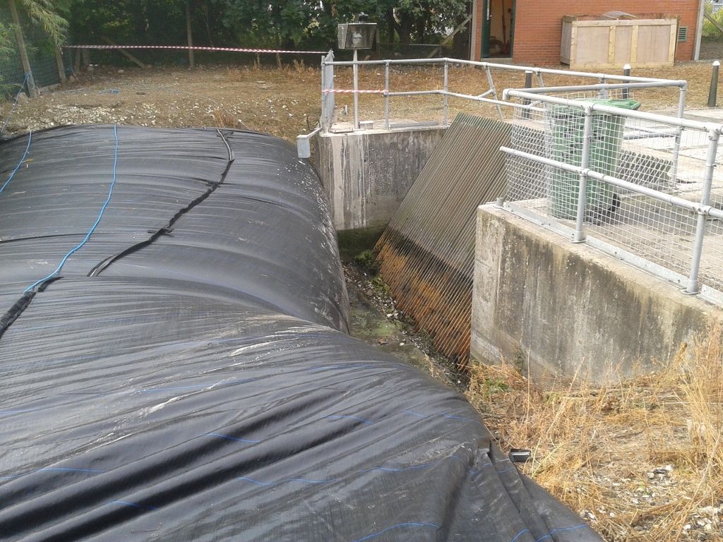

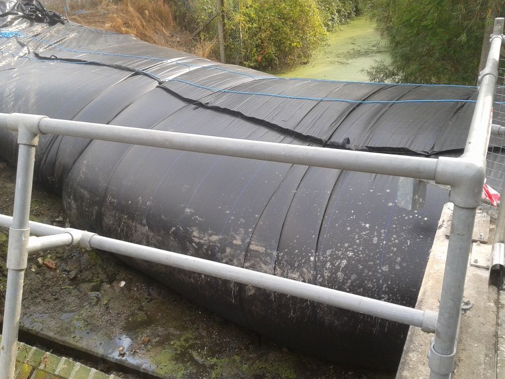

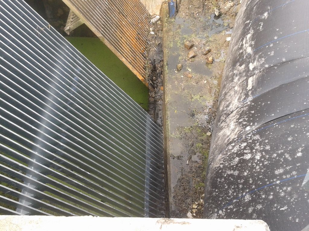

                        Hi DMB and Michael Poole, you are both spot on, Drax is the power station and Tesco's in Barton Upon Humber is the supermarket, from where you can see the two towers of the Humber Bridge.
                        We returned to site today and were happy to find the Aqua-Dam **LINK** that the main contractor had installed was holding.
                        This made it possible for us to replace the old weed screens for new ones that were made in our workshop, which is part of the pre-installation work before a weed screen cleaner is installed.
                        All good fun.
                        Regards Nick.

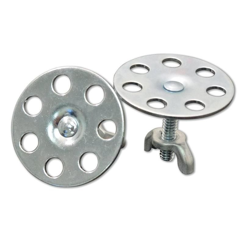

                              Just spent another half hour of my lunch break trying and failing to find a replacement "sink anchor". I wonder if anyone has any idea where to buy them?
                              Looks like this. It is glued (presumably epoxy) to the underside of a granite kitchen worktop and holds the metal sink in place under the opening. Usually there are something like 4 or 6 of them around the circumference.
                              As ever, the first challenge is knowing what they are called, then trying to find a supplier. Given that there must be many millions of them used every year, it can hardly be a minority sport yet I'm not coming up with any answers.
                              So far I have found only 2 suppliers, both in the US. They call them "sink anchors" which sounds fair enough but I'm guessing we have a different name for them on this side of the pond. I've tried anchor, glue plate, granite fixing, sink anchor, sink glue plate….
                              Can anyone help to tell me what they are called and ultimately where to get some? I'm sure there is probably a large bag of them sitting within a mile or so of me, laughing at me. My kitchen sink is hanging by its pipework at the moment as far as I can tell….
                              Thanks

                                    Jason – it's an undermount and was well and truly planted in the kitchen (about 10 years ago), so I'm not wanting to remove the giant granite surface.
                                    Aha. Big Head fasteners look just the ticket. Thanks Malcolm! All I have to do now is find a stockist to sell me them…
                                    Something like this. £40 for 25.
                                    Edited By Muzzer on 19/08/2016 14:53:27
