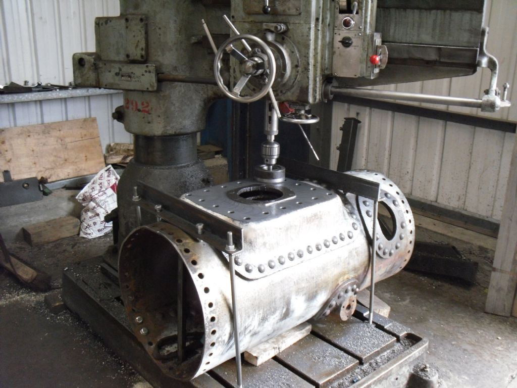

                Aveling & Porter.I used this radial arm drill at work to mill flat the convex mounting face for the cylinder block on this full size Aveling & Porter steam roller boiler. It was then finished off by sanding while still mounted on the drillAveling & Porter.

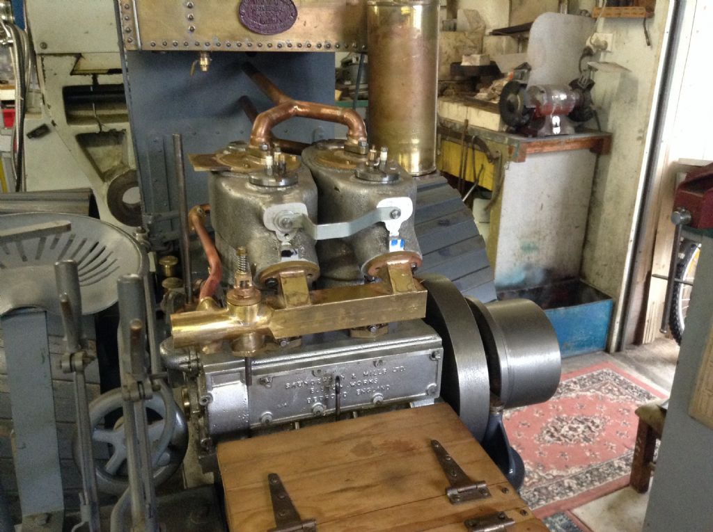

                        image.jpgJason what a great collection of castings for the IC engine must have been your lucky day. This weekend I have been making the carburettor for the tractor. It's not the usual type of carby as it has a built in "snifter' valve, a heater to vaporise the paraffin ( a dummy on the model) and throttle vane. I have yet to make the float chamber and float and then attach it to the main body. Both manifolds will have to be given the treatment to make them look like castings – a case of elbow grease and emery cloth! The left hand side of the engine will be quite busy as it has yet to have the points,distributor and magneto fitted. As it has been raining all day and the workshop has been the best place to be. We need the rain as most of Queensland had been drought declared and also I have just planted up the veg garden.
                        George.

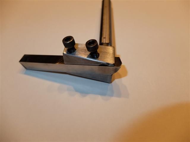

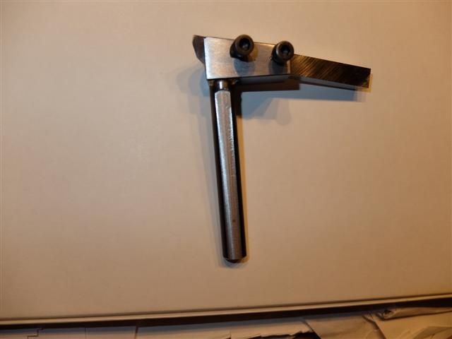

                              Having seen an advertisement for a "Wimberley toolholder", I thought that I should try something similar. This toolholder is almost like a tangential tool turned 90 deg. anticlockwise. I admit the first version I did came out wrong, mostly because the point of the tool came out much too high when used in a quick-change holder.
                              So that's what my effort #2 looks like:
                              And does it work? Very well I think, although I have to experiment a bit more with the tool angles. Maybe I even will do a #3, but for smaller tooling. The 10 mm square is a bit overkill (and needs a lot of grinding…). I did a few cuts in steel, alu and brass, over 1 mm DOC is easily possible (but 0.01 mm also).
                              Regards, HansR.

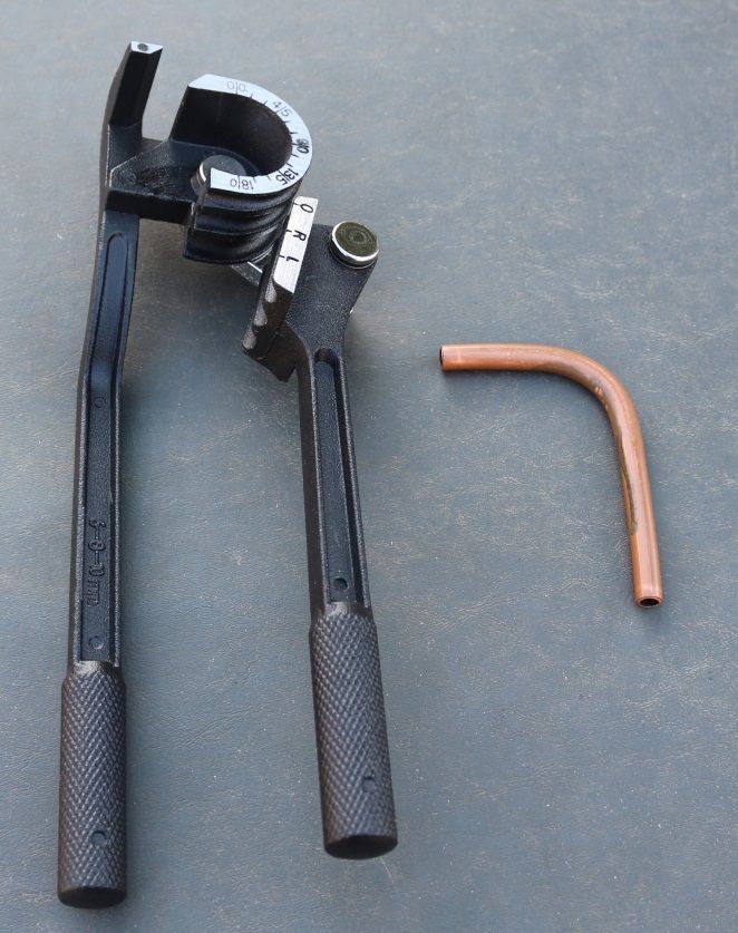

                                      In ALDI today found these pipe benders reduced from £9.99 to £4.99 so I grabbed one. It will do 6mm, 8mm and 10mm. I did this bend OK on 8mm copper tube, it flattened it a little on top of the bend but a quick squish between the vice jaws bought it back again but increased my target bend angle from 45 to approx. 50 degrees.
                                      Found that by decreasing the bend angle from 45 degrees to about 40 degrees and THEN squishing gave the required 45 degree bend.
                                      Not a bad bit of kit for less than a fiver.

                                          Posted by Rik Shaw on 19/08/2014 20:04:07:
                                          I am not employed by ALDI
                                          I am not a shareholder
                                          Neither am I co-habiting with the daughters of Karl or Theo Albrecht (even if they deny it! )
                                          Rik – click!
                                          Edited By Rik Shaw on 19/08/2014 20:08:53
                                          Now they look worthy more so at that price, will be keeping an eye out for them here when they land down under.
