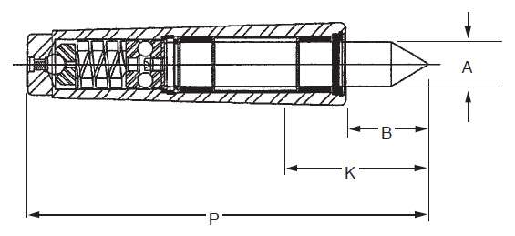

                                #814555
                                  According to Google AI, the Concentric/Riten patent is a ‘trade secret’
                                  We can’t be having that, can we !?!
                                  Herewith I present:
                                  IMG_1031
                                  Ref.
                                  https://www.penntoolco.com/17303/
                                  #814560

                                      Your idea of using Belleville disk springs would make for a more compact package, Michael’s very clever find of the internal workings of those Concentric / Riten centers show a coil spring. But there’s generally a good reason why design choices like that are made. And since those Belleville springs have been around since 1867, they were certainly an available choice when the Concentric Tool Corporation invented that spring loaded center. I have to think there might have been a good reason why Belleville springs weren’t used. Cost between the two designs of spring doesn’t seem to be a real factor, so there may have been some definite design reasons for choosing a coil spring instead. I just can’t think of any logical reason for what that might be yet other than just one. A coil spring would allow more length of compression than a Belleville spring. That could or may have been the only reason.

                                          On Pete Said:
                                          […] so there may have been some definite design reasons for choosing a coil spring instead. I just can’t think of any logical reason for what that might be yet other than just one. A coil spring would allow more length of compression than a Belleville spring. That could or may have been the only reason.
                                          I haven’t done the maths … but someone might like to try
                                          I suspect that the reason is to do with the force vs displacement curve
                                          A long coil-spring will give only a trivial change in force with the displacements we are considering.
