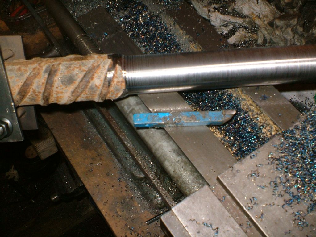

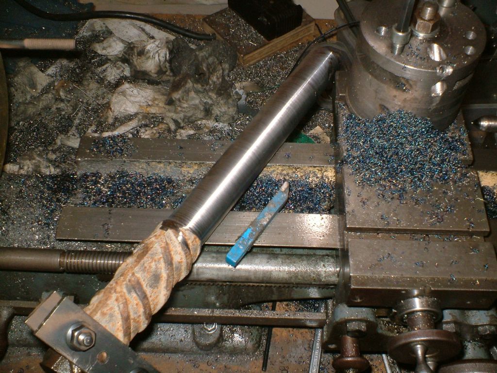

                      In reply to the post above, all you need is reasonable stiffness and you can take advantage of carbide.
                      A seventy year old 3.5inch Myford Mseries can munch down a concrete reinforcing bar with carbide, this would destroy a HSS tool.
                      Carbide is just another tool you have to learn to use, it’s not some mystery voodoo material.
