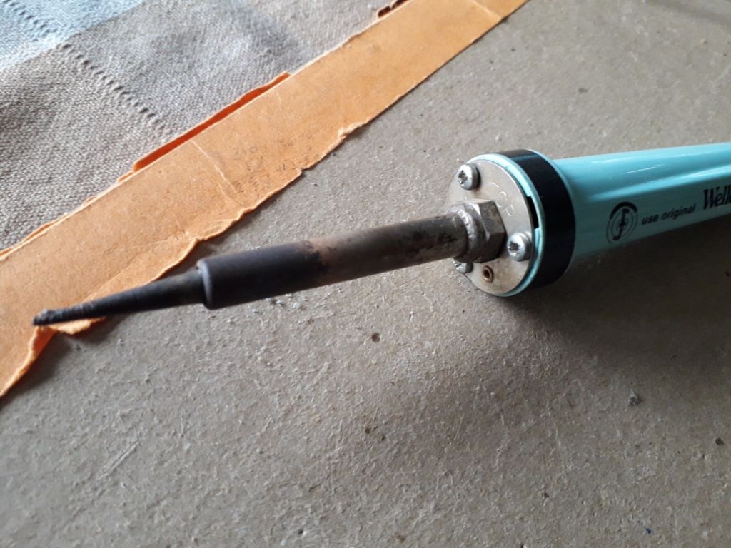

      I have a Weller TCP soldering iron from the 80's I guess – it was being thrown out at one of my previous employers due to it not being the same as their newer ones.
      It works fine but the tip has seen better days so I'd like to replace it but I'm not sure how to get it apart! Any advice would be appreciated as I have a little job for it!

          The tip is held in by the end of the long shroud over the heating element. Unscrew the big nut at the bottom, it shouldn't be very tight (mine is a knurled nut that can only be done finger tight), pull off the shroud and pull the tip out from its recess.
          If the tip hasn't been changed for many years they tend to be very tight due to stuff build up where it sits in the socket. When you get a new tip a little cleaning will most likely be needed. Back in the day Weller ( I think ) supplied a grease to prevent this locking. At RARDE we had something to wipe on.
          When you get a new tip make sure the temperature range is correct for the solder you intend to use. Mine are for old style cored solder, of which I have a 3 lifetimes stash, and struggles with the modern stuff. Undoing a joint is OK but if I had to solder a board with new style solder I'd get a new tip of appropriate rating.

                as linked to by speelwerk these weller irons control their temperature by choice of curie temperature of the bit – modern non lead solder generally requires a higher temperature than the old lead solder hence I suspect the reason for the disposal of a very good iron.

                  The No8 tip is set for 430 deg C (800 F)

                    I knew I could rely on you chaps! Thank you all very much for the excellent replies! I was a bit worried about where to start with the disassembly – old plastic and corroded parts but will have a go later and see how I get on.
                    Also thanks for the tip recommendation, there seems to be lots available so will check what it says on my solder.

                        Well, that went well! It all came apart easily enough, even the tip came out without too much of a fight. After a little clean up I can see a 7 etched on the fixed magnet. As that works ok with the solder I have I'll get a new one and see how I get on…
                        Thanks for the tip (!) Clive, I'll check that out also.
                        Thanks again all, I'm very chuffed to have been able to get it back into service…
