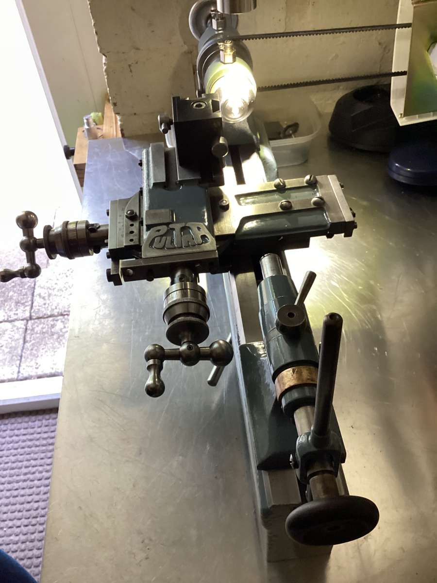

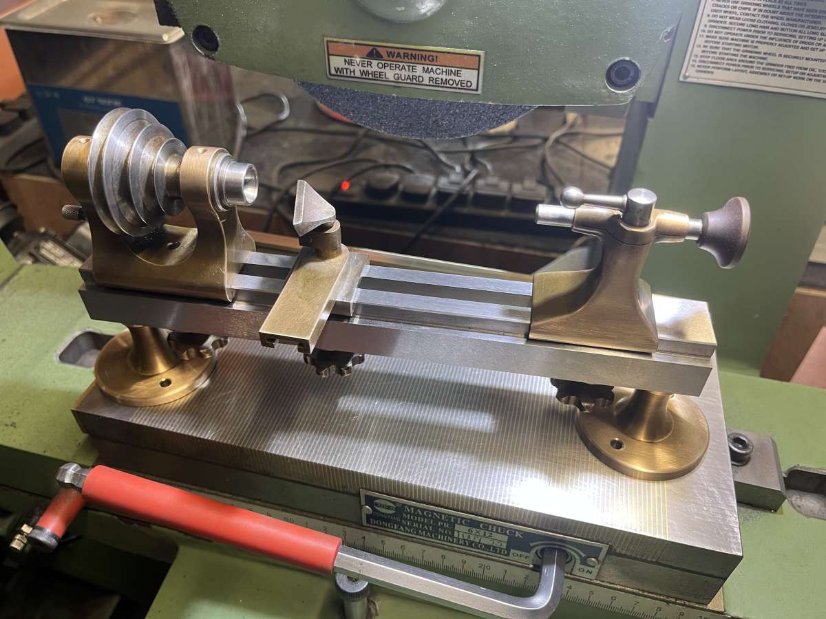

      I have just finished refurbishing this neat little watchmakers lathe and wondered if anyone can advise me what type of collets are likely to fit in the headstock spindle and similarly what type of tooling fits in the tailstock – not even sure if there is a taper in the tailstock bore?
      Also any advice about what kind motor rpm I would require to drive the lathe.
      The main aspect of the refurb was making a complete new lathe bed out of gauge plate. Most of the milling was done on my Tormach CNC which just goes to show these hobby machines are capable of milling more than just plastics and aluminium!
      Thanks in anticipation.

        That looks like a nice job, I think watchmakers collets go by the largest capacity ie 6mm/8mm 10mm but overall dims must be avail somewhere try lathes.co.uk site. If you look up COLLETS on that site theres quite a bit of info and diagrams.

          Watchmaker collets are defied by the diameter of the parallel portion of the collet body.  While many makers made 6/8/10 mm collets, the head angles and draw tube threads can be subtly different so careful measurement is necessary to determine the correct collet.  Have you any idea who made the original headstock/spindle?

            All I have measured is the bore of the headstock spindle and its clearance on 8mm diameter. I can make a draw tube in due course. There is a key in the spindle bore as one would expect to see.
            Alas, there is nothing to identify the maker of the lathe.
            I will get my loupe out and look up the bore of the tailstock barrel.

              That appears to be a homemade bed for a common mfr’s headstock. The maker’s name is often on the back end of the headstock. If missing all I can say is it is not Boley-leinen.
              The tailstock barrel is often interchangeable ie a watchmaker might have several with and without taper.

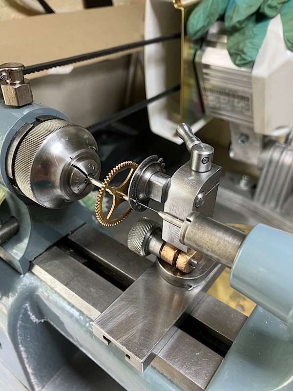

                        The tailstock might take “runners” which are just straight shanked tools usually held in place by clamping a lever on the tailstock.

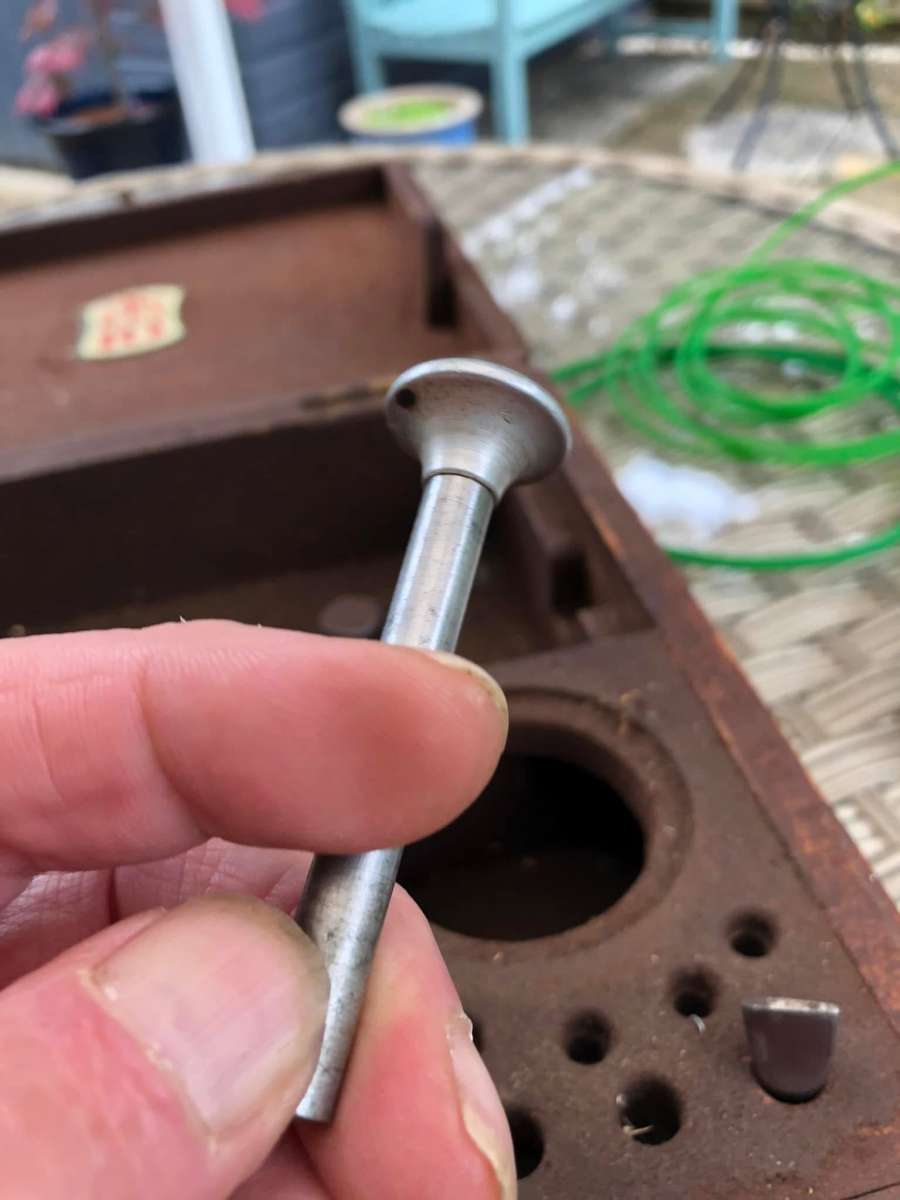

                          Sounds like the headstock takes 8mm collets & the tailstock is just for runners , if you use the tailstock for drilling then you would need something like this.
                          the runner usually has a 2 deg taper
                          IMG_3629IMG_3630

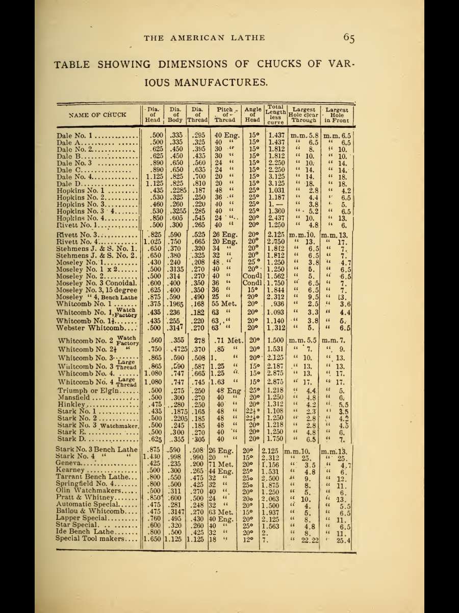

                              This handy table has been plagiarised elsewhere, but I believe it is due to
                              Ward L. Goodrich.
                              The Watchmakers’ Lathe
                              Its Use and Abuse

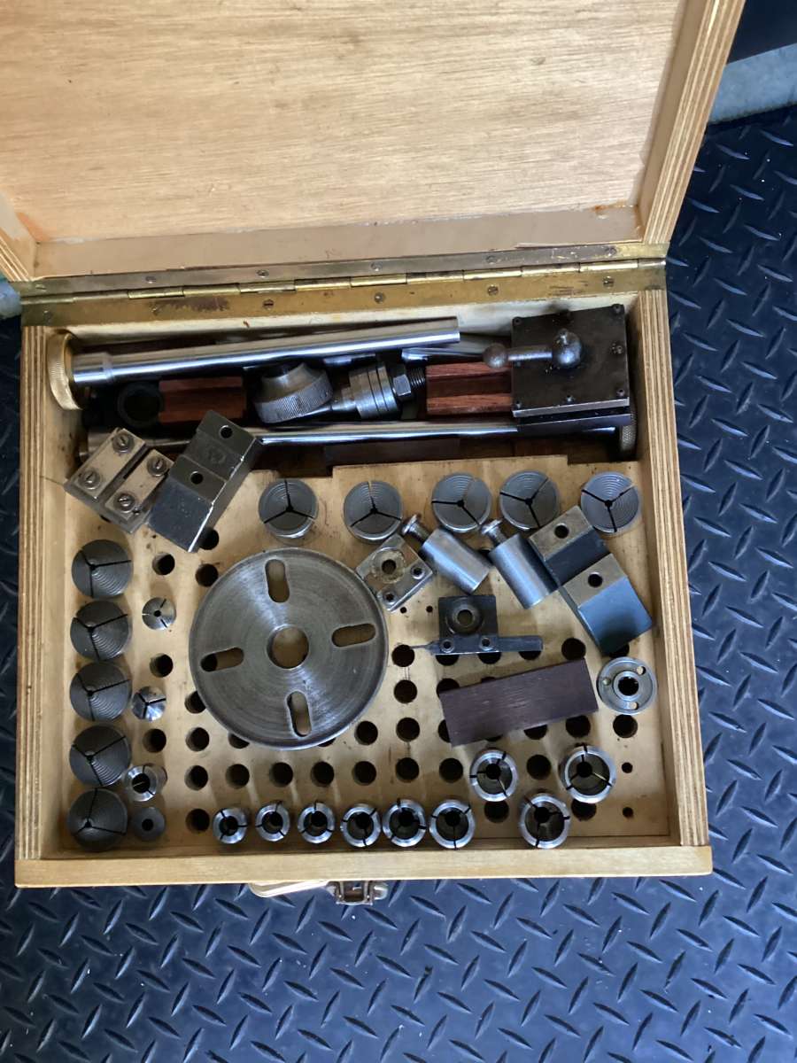

                                    Michael’s table showing DIMENSION OF CHUCKS OF VARIOUS MANUFACTURERS illustrates an awkward problem, which is that Watchmakers Lathes aren’t standardised!
                                    Less of an issue when the lathes were new, because customers knew what they were buying.  And the lathe came with a set of accessories, often seriously expensive:

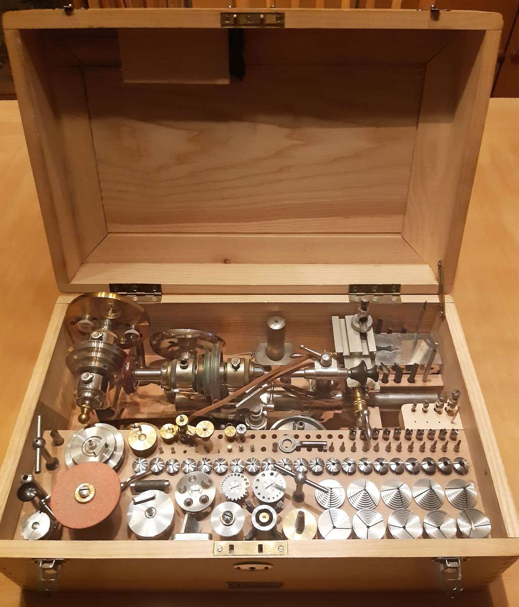

                                    Though I came close to taking up clock-making as a hobby and swotted up, I don’t have a feel for the minimum number of accessories needed to get going.   Building a clock, I guess much could be done with a few collets and a shellacked faceplate.  Repairing old clocks for money might need a lot more because shapes and sizes vary so much.  Can a clockmaker advise please – what else does Shaun need to get his lathe operational?

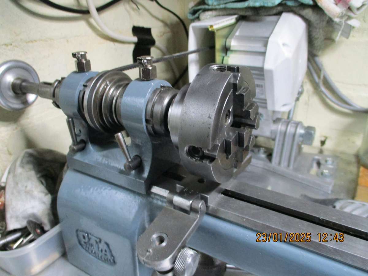

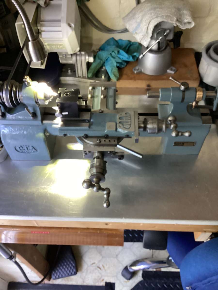

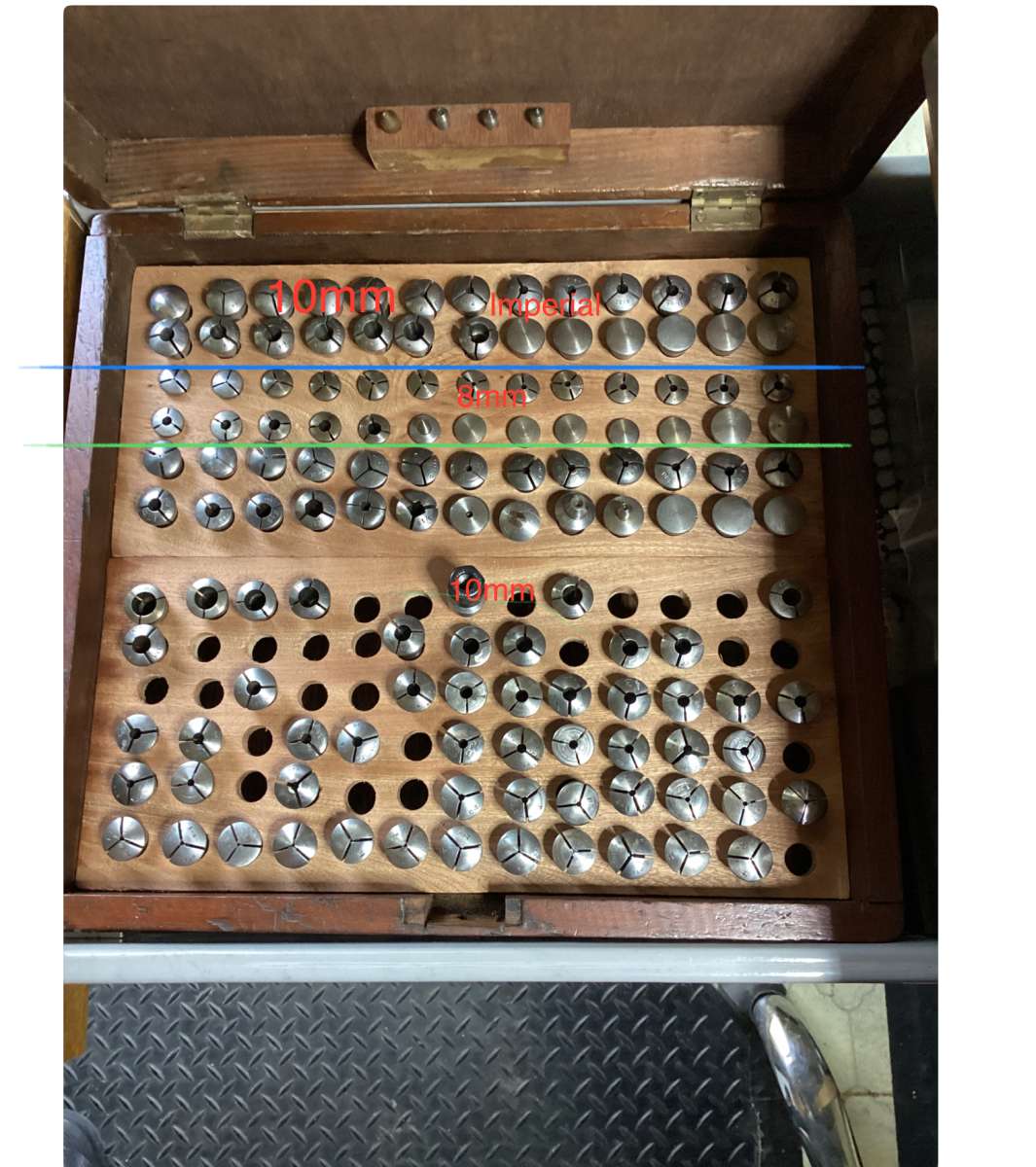

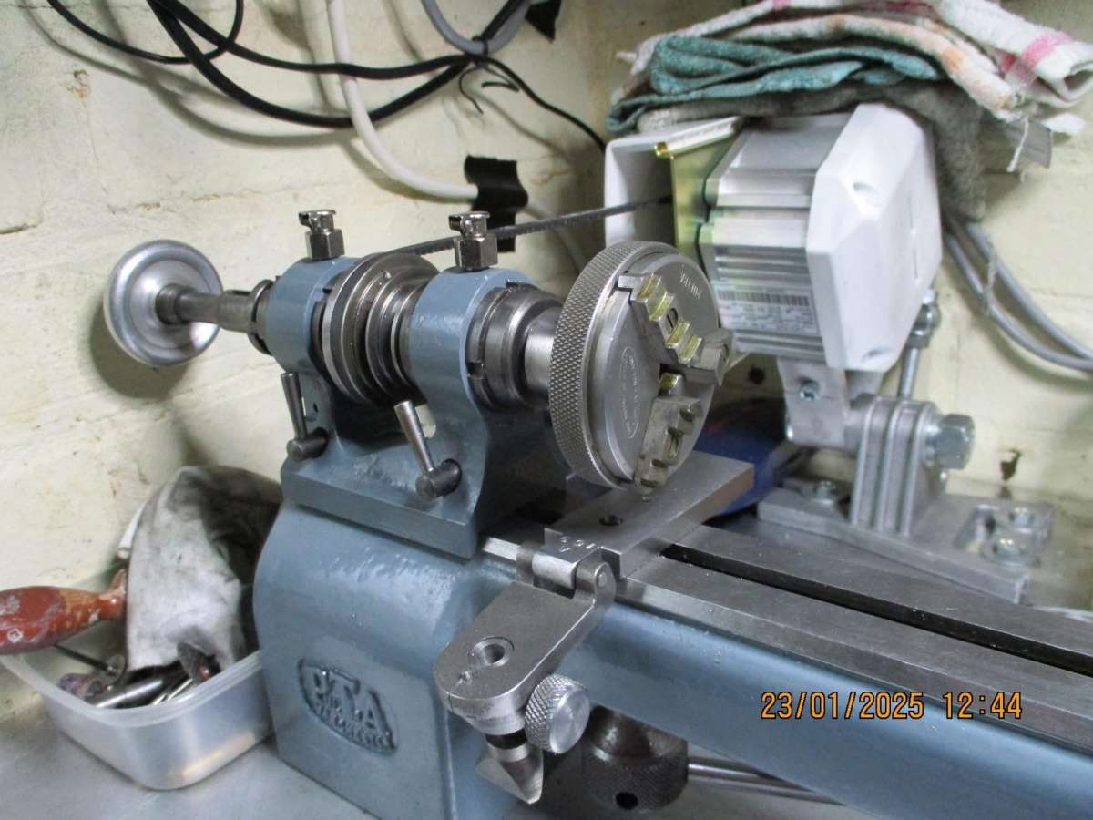

                                      Yes there are quite a few accessories here is my English Pultra P type it has a headstock that takes 10mm collets & a tailstock that takes 8mm collets as well as runners, if you use a runner for drilling the taper in the runner is a bit like a Morse taper self gripping & using the runner to drill give very sensitive feel when using sub 1mm bits, have a look at my YouTube channel @torsiondell you will see how I use my Pultra.IMG_2024-05-04-162443IMG_2602IMG_2603IMG_3490IMG_3652IMG_3489IMG_3653

                                        Very nice lathe Dell.
                                        That’s not the first time I’ve seen it mentioned that some accessories for watch maker lathes may not be standardized for some items. While I’ve never used those 6/8/10 WW designated collets. I’ve also read posts where the collets threads between the various manufacturers may not exactly match for there finished thread flank profile and thread minor diameters. So not all draw tubes can be used for all collets even when there the same O.D. and taper. If I recall correctly, T.D. Walshaw mentioned the same in one of his books. Maybe something worth keeping in mind for anyone buying used collets.
                                        Fwiw and if I wanted to be 100% positive of what I had for a spindle or collet taper. There’s a product designed to do exactly that. A low melting point alloy. The common brand name in North America would be Cerrocast or Cerrosafe. It might also be known elsewhere as Woods Metal. https://en.wikipedia.org/wiki/Cerrosafe There’s multiple temperature ranges from about 117F – over 400F. The better brands have controlled alloy amounts with known percentages for shrinkage rates immediately after casting, or on a percentage graph for the hours since it was cast. Because of that, very accurate measurements can be taken.

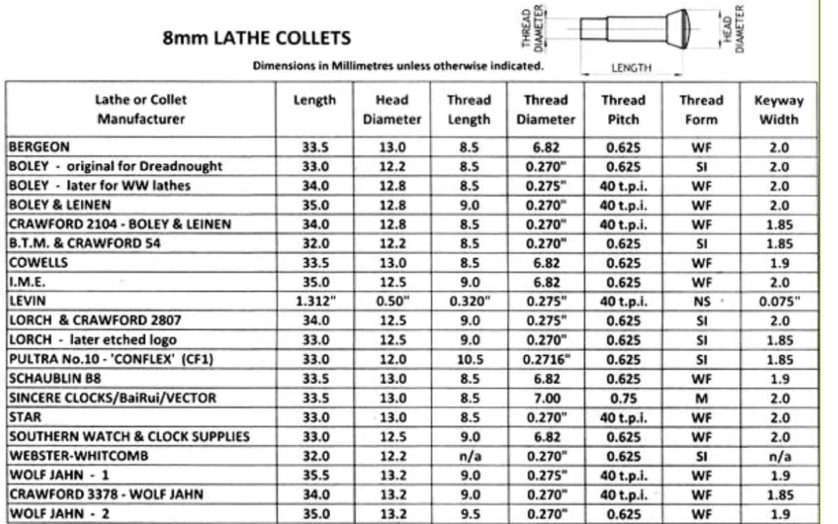

                                          If your headstock turns out to be 8mm then this maybe of help but the most common thread is 275 X 40 tpi.IMG_3755

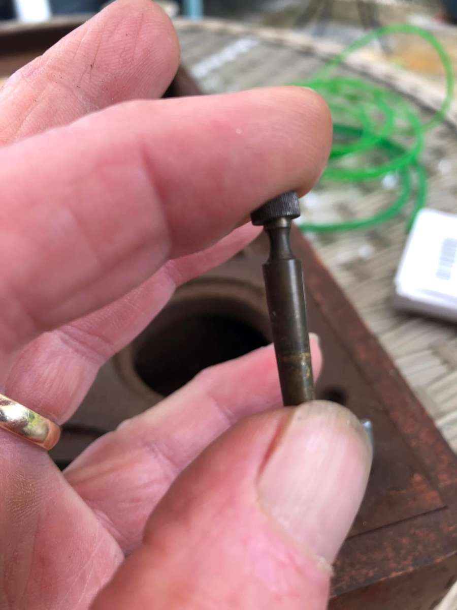

                                            A drilling runner will usually have a knob on the end which you literally just push through the tailstock to advance it into the workpiece, your grip is all that stops it spinning.
                                            You have to understand that a watchmakers lathe is a very light duty machine. Most users will only ever drill very small holes, often just a fraction of a millimeter. The maximum size of drill bit used probably never exceeds about 6mm.
