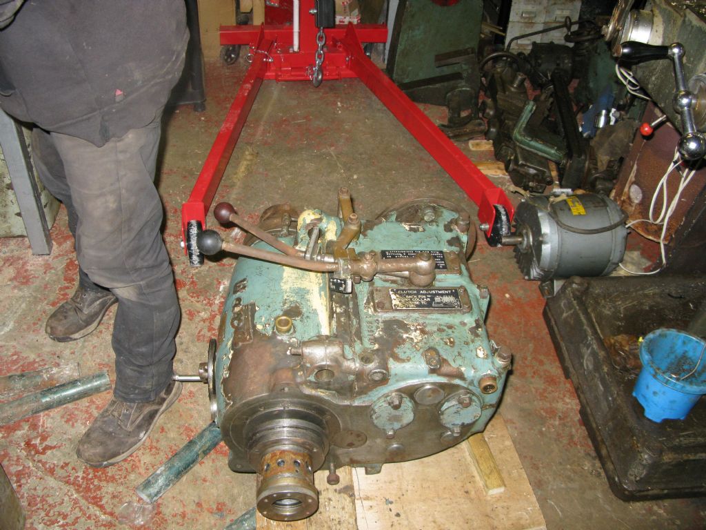

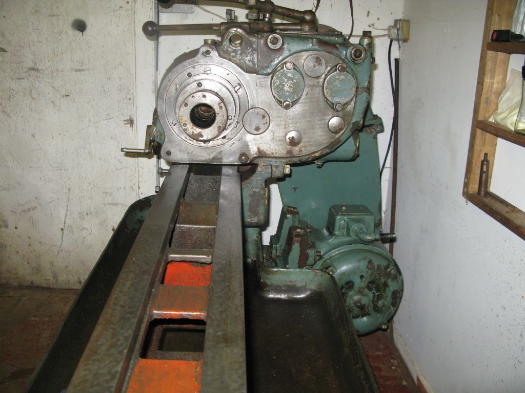

      Ward 2A, would like to hear from other owners. Lots of collets but no 3 or 4 jaw chuck. Few hours a week putting it all back together. The 3HP 6 terminal motor needed to be ramped up slowly on my inverter to work. (thanks to Steve) Oil like toffee, many sheared bolts, a few bits siezed but generally absolutely Beautiful. The last photo was me moving up my range of hammers until I used the small slege hammer, it was too big.
      Edited By Bob McDougall on 23/12/2017 20:38:24
      Edited By Bob McDougall on 23/12/2017 20:41:50
      Edited By Bob McDougall on 23/12/2017 20:46:32
      #18780
      Bob McDougall
        @bobmcdougall63250
        reconditioned in 1961 , dismantled 25 years ago .

                  Bob McDougall
                    @bobmcdougall63250
                    Great to hear about how these machines are fpndly recollected.I will check on the spanner robjon44 mentions.
                    The forward gear feels like its lost teeth so it only runs in reverse (I just run the motor in reverse).
                    The re-assembly is progressing broken part welded and seized parts freed. Apart from … the double gear in the carstan feed gearbox which I believe is supposed to slide along the slotted power feed shaft but because its seized to it we cannot move the capstan saddle which is stuck almost at the furthest end of its travel away from the chuck.
                    So still at it! . Would anyone have a manual with a full exploded diagram ? or operators manual. still not sure what a few levers and knobs are for.

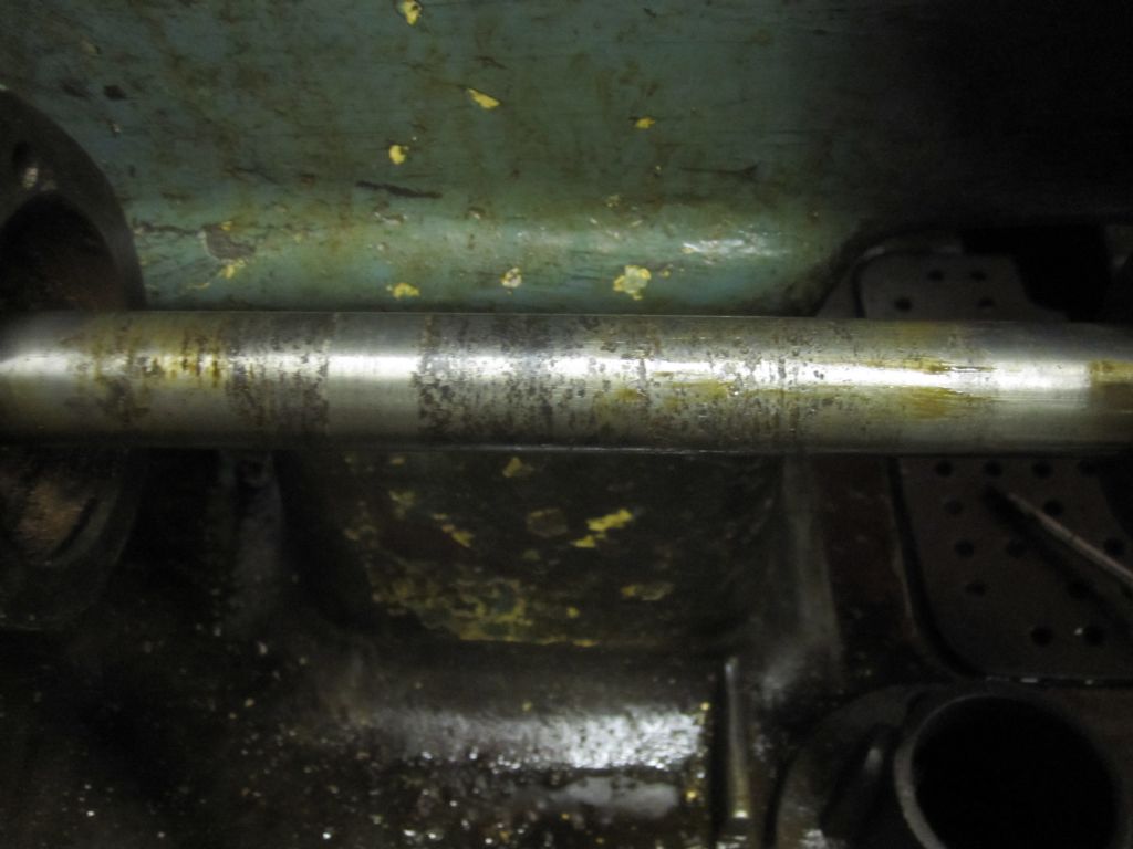

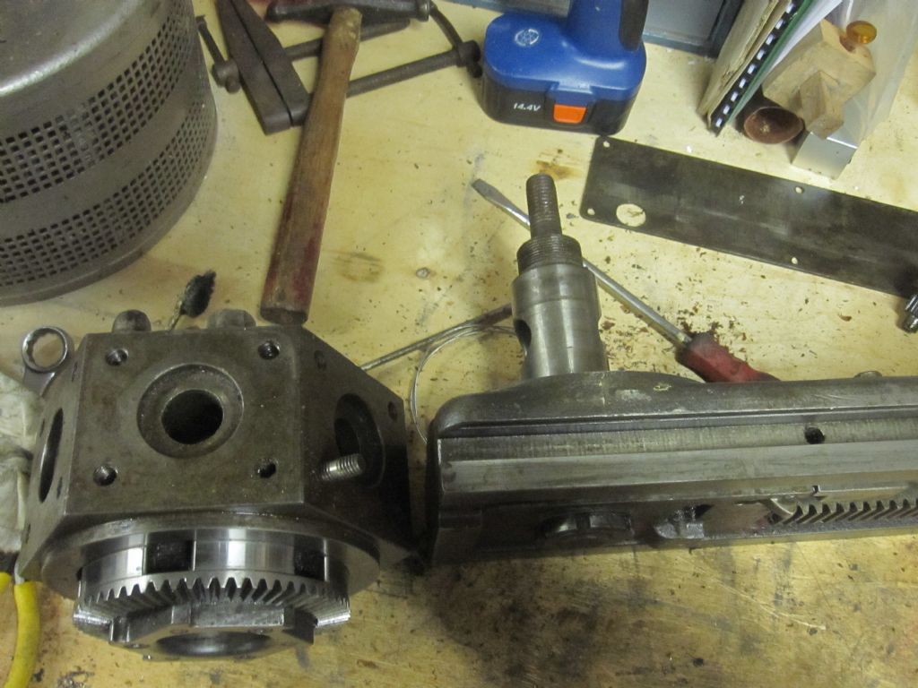

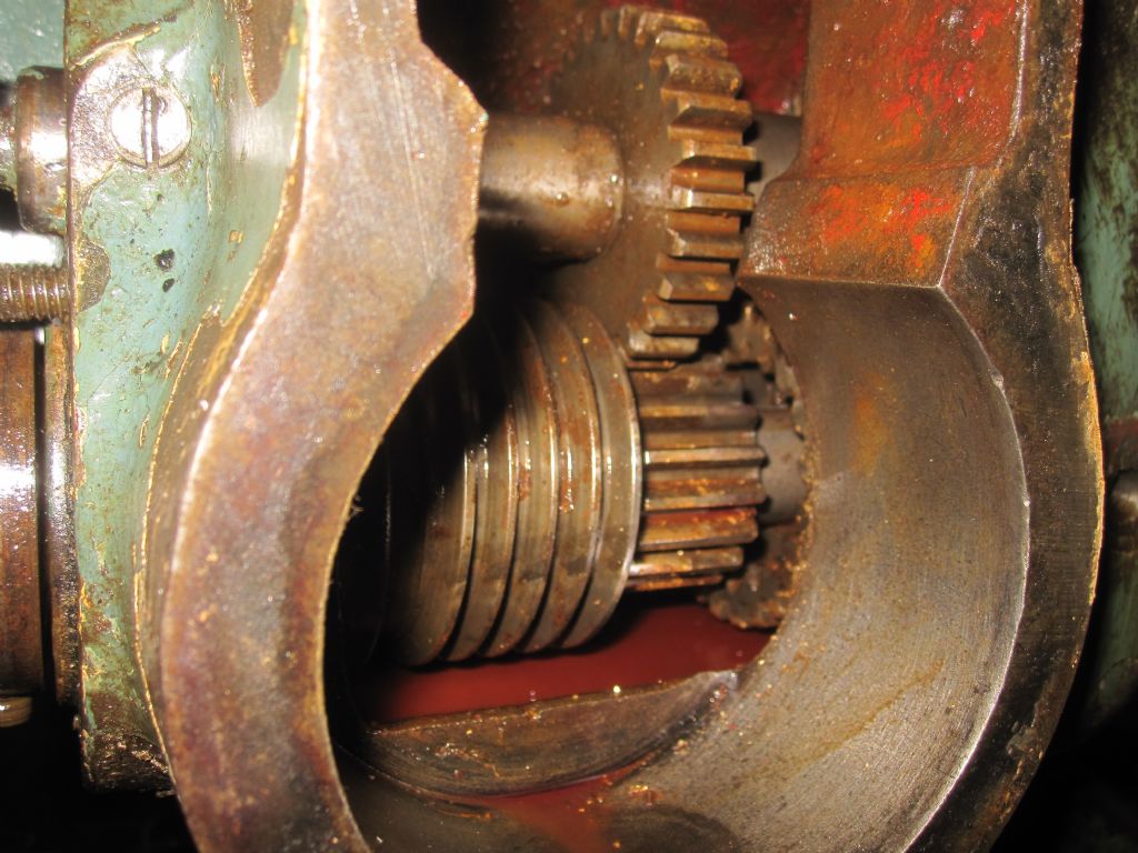

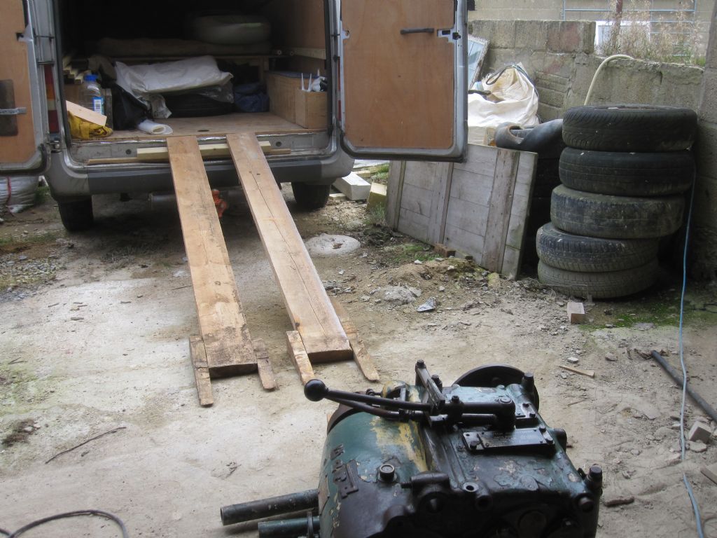

                                  Bob McDougall
                                    @bobmcdougall63250

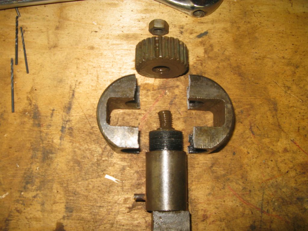

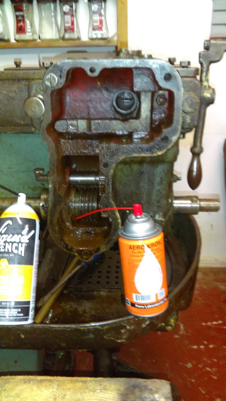

                                    Another night of Kroil . In three hours we moved the capstan power feed gear on the horizontal shaft 10mm. But also cut some 15mm steel bar to 12.48mm so we are making things.
                                    Great to hear about the history of these machines, this had Birmingham on the bed. My Grandfather was a pattern maker from Dudley and could have made the pattern of parts of the lathe I now have.
                                    #338450

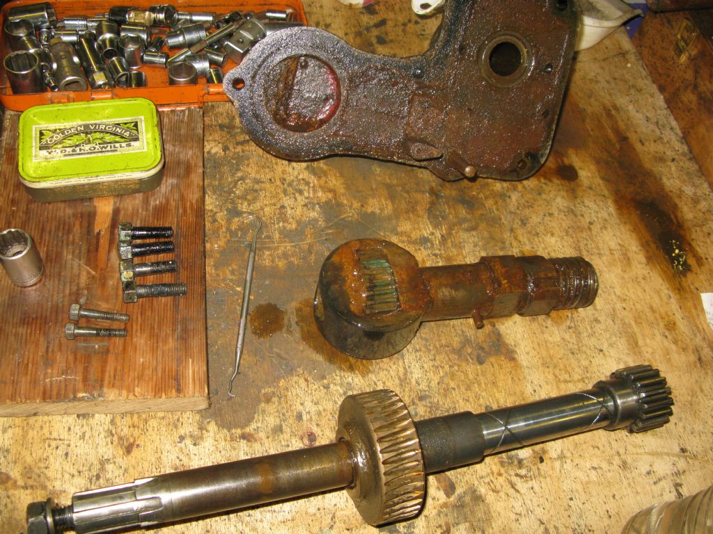

                                    Bob McDougall
                                      @bobmcdougall63250
                                      Ive added some photos of ward to my album ward 2A. The turret gearbox was heavily contaminated and rusted. its all free now except the double speed change gear ? is this what it is I wans't sure if it was a reverse gear.
                                      Saw a local friends ward 2a which had a power feed to the main saddle and a gearbox at the head end.
                                      can now knock the woodruff key up and down inside the double gear but still the gear is siezed to the shaft which means we cant move the turret saddle more than a few inches, and it is set at an unusable distance from the collet

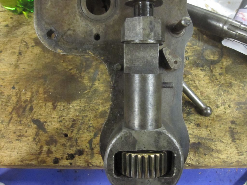

                                      Bob McDougall
                                        @bobmcdougall63250
                                        The problem was the turret was so far from the chuck it was unusable. The turret saddle had a gearbox to recieve power feed from a horizontal slotted shaft parallel with the bed. A gear engaging the slot via a woodruff key had seized to the shaft so the saddle could not be moved along the bed. As a fisherman once said, "we are going to need a bigger hammer" I only used my small slegehammer but it did the job, the seized gear moved. Last night two of us moved it 0.5mm in an hour, 1mm in two hours and 5mm after 3hours. I hit it with the big hammer today and it moved mm , then some more. and finally the saddle can move freely along the power feed shaft. Probably 10 hours of KROIL and hammering over four weeks. wow it felt good.

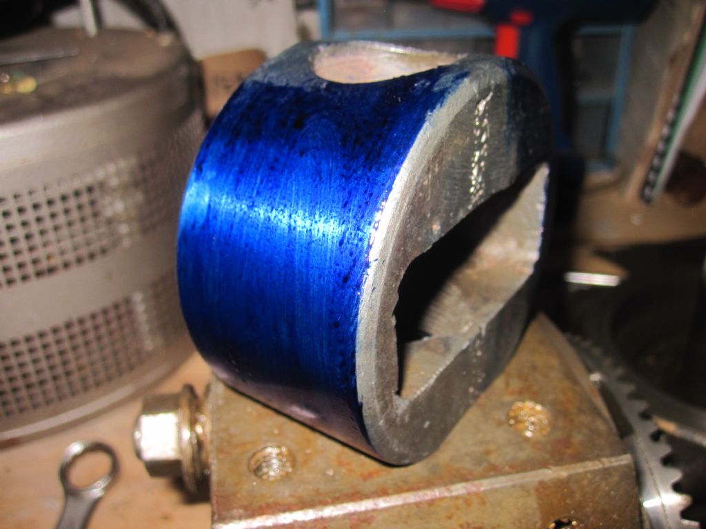

                                          Bob McDougall
                                            @bobmcdougall63250

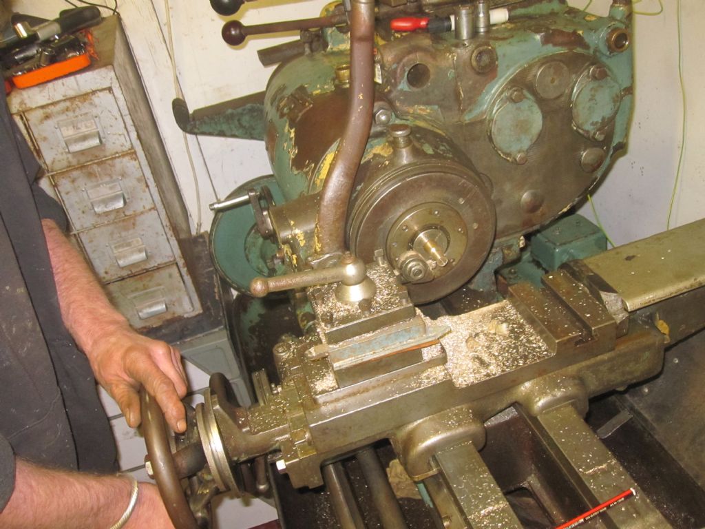

                                            Turret , what a beautiful single part.
                                            The corrosion on the horizontal power feed shaft to the turret. This is what the turret gearbox was seized to for 25 years and took weeks of kroil and hammering to free. But we did it !!!
                                            re assembling the vertical shaft, we (I) had split the lower gear case and had it welded back but it was swolllen and didnt fit so lots of sanding to get it back in, only on re-fitting did we realize it actually hindges on the lower round casing and pivots to engage on the upper gear.
                                            finding the binding points on the housing after the welding fix.
                                            the outer casing has an arm with a cam to push the vertical shaft onto the upper turret feed gear fixed to the manual feed.
                                            still making bits, although under load the spindle slowed considerably so still serious motor/gearbox problems.
