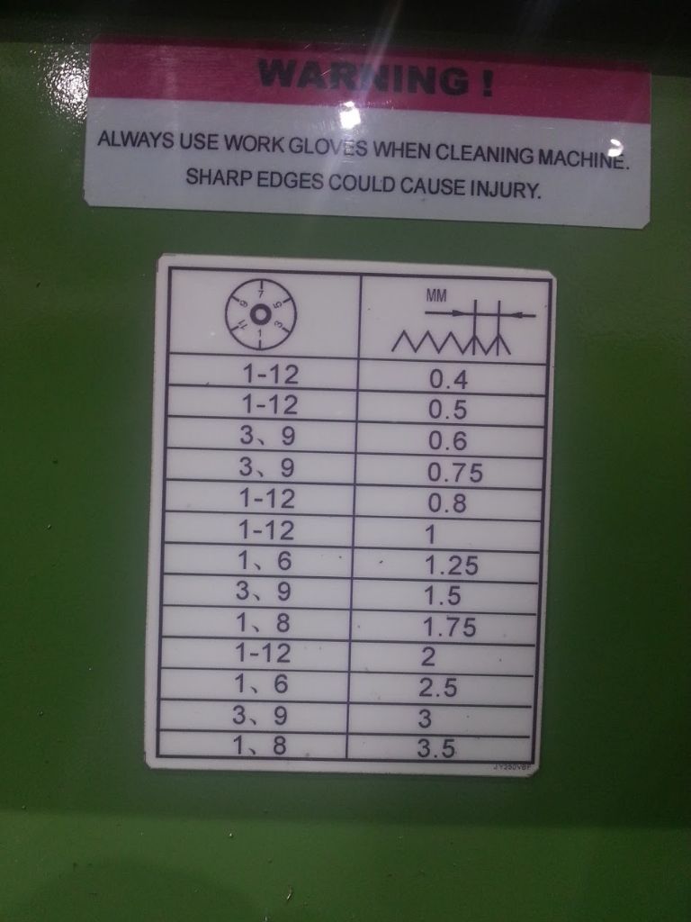

                      Could somebody please post a picture of the sticker on the splashback that lists the threading dial positions?
                      Like a fool I forgot to note what they were before I binned the splashback(I don't have room for it on the bench), and although I have the change gears set for the 1.5mm pitch thread I need, I have already ruined two workpieces.
                      Mine's a metric lathe if that helps.
                      Thanks,
                      Nick

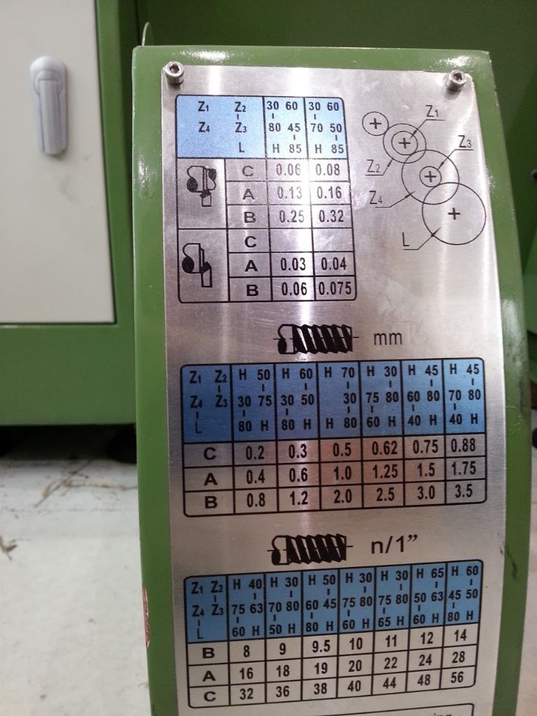

                      Jimmeh
                        @jimmeh
                        Here is the threading chartfrom my WM250V-F Metric lathe. Just in case you need to calculate your own change wheel combinations the lead screw pitch is 2.0 mm and the gear on the headstock is 40T. Hope the picture attaches okay (just check my album if not).
                        Cheers,
                        James
                        Edited By Jimmeh on 10/02/2016 21:52:12
                        Edited By Jimmeh on 10/02/2016 21:53:20

                        Jimmeh
                          @jimmeh
                          Sorry… Just realised which chart you really wanted and put it in my album. For a 1.5 mm thread pitch you can pick up on 3 or 9.
                          James
                          #224827
                          Nick Wheeler
                            @nickwheeler
                            Thanks very much Jim, you're a star.
                            That would explain why using 1 didn't work.
                            I can finish my adapter tomorrow.

                                    Looking at James's other chart
                                    Things should be quite simple, as john says take the setup for 2mm pitch and half the gear on the end of the leadscrew.
                                    You have a 40T on the spindle so with a 40T on the leadscrew you will get 1 turn of the screw per 1 turn of the spindle. You have a 2mm pitch leadscrew (I think) but by having the gearbox in position B this has a 2:1 increase so 2 x 2mm = 4mm. The gears between the spindle and 40T leadscrew can be anything as they are just idlers in which case you should have something to fitsmiley
                                    Edited By JasonB on 11/02/2016 17:21:53
