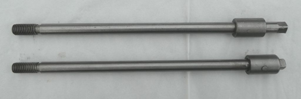

          I usually have no problems installing and removing 2MT fittings to my WM16 mill until this afternoon. I wanted to remove the collet chuck but after several attempts the thing remained firmly stuck.
          In the end I removed the draw bar and did not twig at first but comparing it to the other metric draw bar supplied with the machine I could see the problem. The large diameter short sleeve had come adrift and had ridden up to the top near the square because the pin that had secured it had sheared. If this IS supposed to be a shear pin rather than a retaining pin I cannot understand its purpose other than to give me grief.
          If keeping material costs down was priority in this components manufacture then this might explain why it had been made this way. My feeling at the mo is that I’ll turn a replacement in the solid and avoid the problem in the future.

            The same happened to me, shortly after I got my new milling machine (Weiss WMD25) the pin holding the sleeve on the drawbar sheared. I cleaned the inside of the sleeve and the bar, and drilled a larger hole so I could use a larger diameter pin and silver soldered the parts. It has worked without problems since. I guess the pin wasn't big enough or too soft.

              This has happened to me too, after some pesky tapers were well and truly lodged in there it shifted the retaining bush on the draw bar, i gently knocked it back into its original resting position and cross drilled the bush and bar together in two places and riveted them ontop of a metal block. i filed and ground the rivets flush with the barrel.
              You could try the above silver soldering method if you can draw enough heat into the bar and have a super strong drawbolt. An extreme solution would be to machine a new draw bar with the whole thing as one piece, no fabrication of two parts.
              Or.. even buy a new one! warco are very helpful with spares, and would always recommend a home solution if there was one. They dont sell for it's own sake if its not a good idea, very good service and staff i've found. But judging from both mine and Thors responses, this is a common problem once it's happened and a replacement would still need "rectification" at some point.

                Update: Nice to know I’m not on my own when shearing these pins. I Decided to give it another chance and made a replacement pin from silver steel (Stubbs not cheapo) and it sheared immediately.
                One more go I thought and turned down another pin from an old, tough as boots cap head screw. This time when I tried there was a nice satisfying “crack” as the tapers parted and my collet chuck came free. I’ll put of making another all in one draw bar for now and see how the UNBRAKO solution pans out.

                  Rik, using a HT bolt sounds like an interesting solution. Didn't think of that myself at the time, just drilled a bigger hole. Let us know how the "cap head screw" solution works out when you have used it for some time.

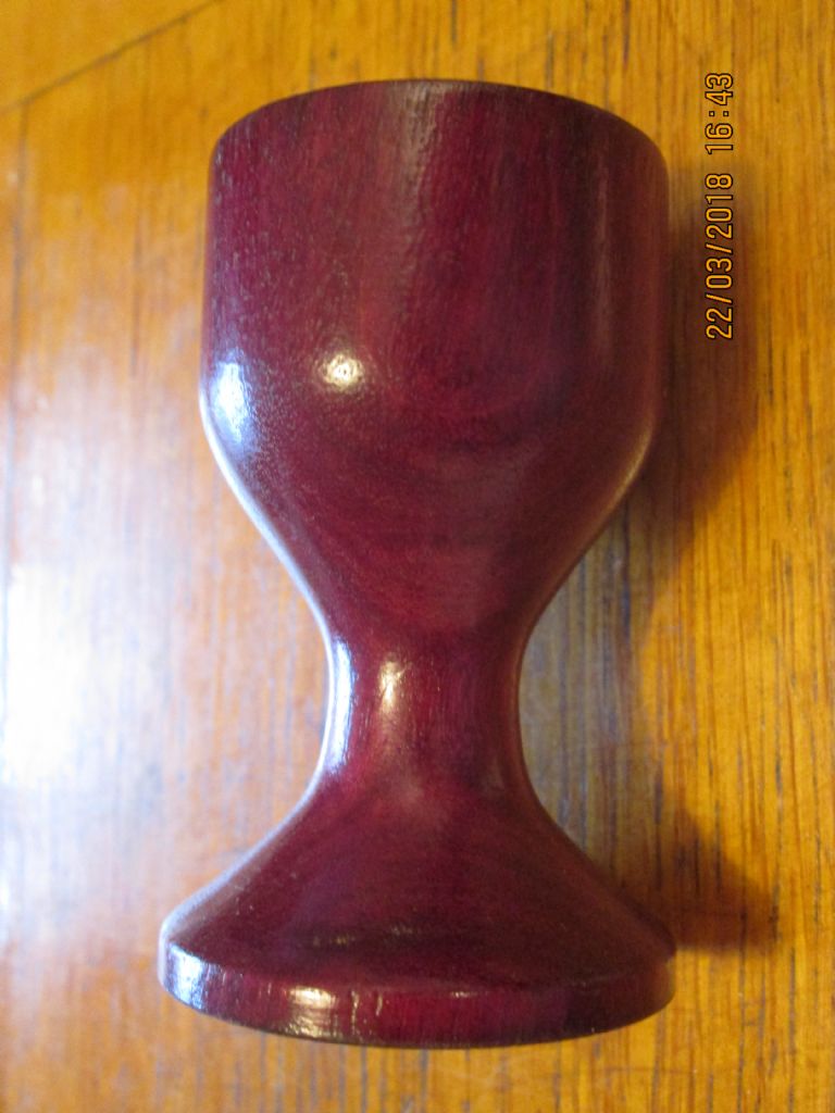

                                    Here's my purpleheart eggcup, showing wear from a couple of years' daily use. Nothing in the least special, but it shows that basic woodturning ops can be done on a metal lathe.img_1729.jpg

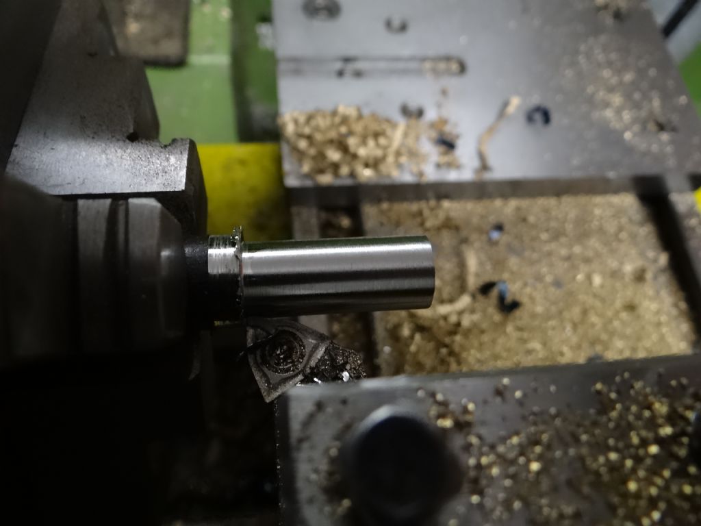

                                        Got back in my workshop for the first time since it's warmed up and wasted some time taking measurements.
                                        My lathe is a WM-280 fitted with a 1500W 3-phase motor, VFD and two continually running cooling fans. (One on the motor, one on the VFD). How much power does it actually consume in operation I asked myself?
                                        So with belts set to the high-speed range; banjo gears set for fine feed; auto-traverse engaged; and the built-in gearbox set to the finest feed-rate:
                                        • Lathe switched on (ie. with only the fans and electronics running) – 47W
                                        • Motor idling at 150rpm – 210W
                                        • Motor spinning at 1500rpm – 360W
                                        Using 13.7mm o/d steel welded gas pipe as a test piece with carbide inserts and no coolant/lubrication:
                                        • 0.3mm deep cut @ 1500rpm – 542W (A 0.3mm cut removes 0.6mm from the diameter)
                                        • 0.5mm deep cut @ 1500rpm – 540W
                                        • 0.7mm deep cut @ 1500rpm – 565W
                                        • 1.0mm deep cut @ 2400rpm – 960W ( A 1mm deep cut removes about 80 thou from the diameter.)
                                        • Parting off with a 3mm wide carbide blade @ 1000rpm – 600W, lower than expected.
                                        At the finest feed rate (0.07mm per revolution), a 23mm long cut takes about 20 seconds at 1000rpm. I'm too befuddled this morning to calculate how much steel I can remove with 1kWHr's worth of electricity costing me about about 11p.
                                        Taking 2mm off the diameter of a steel rod in one cut is pretty much the hardest I ever drive my lathe in practice. In this test doing so produced a string of smoking blue swarf from the gas-pipe rather than chips. At that rate the lathe pulls less than 1kW, which suggests that I need to drive the lathe significantly harder to stress the motor, and thus have the opportunity to make the carbide inserts work better. On the other hand an unstressed hobby lathe will last longer! (I've no idea what this lathes operational sweet spot is. My car is best if I drive it at a steady 60mph. Lots of stop-start slow speed city motoring is bad for it, as is hammering up and down a motorway at 90.)
                                        Interesting that the belts, banjo and gearbox in fine feed eat a couple of hundred watts before any useful work is done.
                                        Normally I guess I have the lathe burning about 550W during cuts. That's only a couple of amps from a domestic mains socket. I use more electricity lighting the workshop and making tea than I do cutting metal!

                                          It would have been interesting to see what happened if the feed lever was flicked over to the next feed rate up which would be double the one you were using. keep speed and DOC the same.

                                            Your wish is my command.
                                            Set up as before to take 2.0mm off the pipe. (I skimmed it before testing to make it round. Off the shelf gas pipe isn't!)
                                            • Motor idling at 2400rpm – 490W
                                            • Motor whilst taking a 1mm deep cut with the feed rate at 0.14mm per revolution – 1539W
                                            With the lathe at full power, the cut produces chips rather than coils of swarf. Bearing in mind that gas pipe doesn't machine well the finish isn't good. You can just about see traces of a 0.14mm spiral in the photo. With an eye-glass I can see what looks like rubbing.dsc05140.jpg
                                            Mains voltage today: 239V
                                            Edited By SillyOldDuffer on 24/03/2018 14:48:56
                                            #347386
                                              Thanks Dave
                                              So the faster feed makes the motor work quite a bit harder as you would expect. So as that is twice the amount of metal removed in the same time as the finer feed but only a 50% increase in wattage you will save a few pennies using the faster feed at least at these smaller diameterssmiley
                                              For gas pipe the finish looks quite good and as most of these tips are supposed to make chips when working at their best rather than long swarf you are within its best working range.
                                              Edited By JasonB on 24/03/2018 16:06:01
