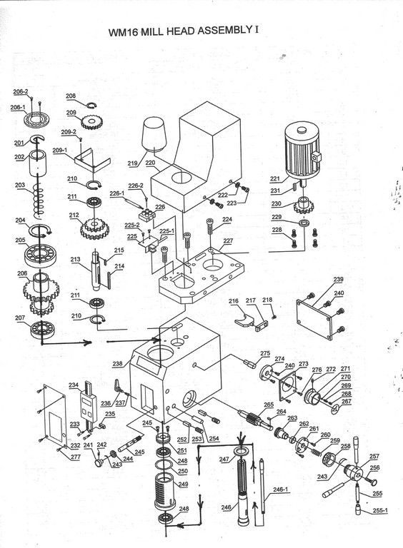

        Unfortunately I have a Warco WM 16 VS item No. 3217 year of manufacture 2015.
        I appear to have stripped a gear on the low speed option, although I cannot see it very well. Probably the famous plastic one that I have heard about.
        I have removed the motor cover & the front cover, but cannot work out how one gets to the gears to remove them & replace. Assuming they can be replaced. (Otherwise it will be the skip & a proper mill!!)
        Can anyone who has solved this, give me some guidance on how one should approach the problem (not the skip solution, although I am sorely temptedangry 2)

          I have a Warco WM 16 of similar vintage which I bought secondhand earlier this year. I found a comprehensive manual for what appears to be the same design on the Grizzly (USA) website model G0704. It has a couple of expanded drawings and parts list. If you do a google search for 'grizzlyg0704 gear' there are a few comments and YouTube videos showing how to replace the gears.

            DON'T Skip it ! they are not cheap to start with. I have a WM 16 of 2012 vintage; fortunately not in your situation ( not trying to sound smug honestly ) Look in the manual at the exploded 'head schematic' & you should be able to figure out how to remove the plastic gear (sacrificial, precisely why it's there ). I changed the spindle out of mine using the same schematic a couple of years ago due to a cracked MT taper, fairly easy to do. There are steel gears that can be substituted but can't recall where from at the mo'. If you don't have the manual I can mail a scan of said page to you if you PM me.
            Some owners have replaced the gear system with a belt drive set up which will eliminate the problem altogether giving any 'jam ups' the opportunity for 'belt slip'. IIRC there is a USA site that has the material to do this …'Grizzly' & if I remember there was a write up to do this on their version… Grizzly 0704 I believe, have a look see. I have considered doing this mod with mine but as the old engineering cliché goes… 'if it aint broke don't fix it ' so…

                Sam for your att….
                George.

                  Brian over on MEM had the same problem with is similar machine a while ago, some pics from his post may help here

                    Sam, I had the same problem with my Chester 20VS. Plastic gear stripped 3 – 4 years ago.Contacted Chester who supplied a replacement gear set free of charge. Decided to continue using the mill in high gear only until it eventually fails and would then replace the gears. Still waiting for the high gear to fail !! Never had any problems using the the mill without the low gear. There are a couple of videos on You Tube explaining how to change the gear.

                      Thanks for the help everyone. The information about the match to the Grizzly was useful as that took me to the videos. The higher gear does work still, but, presumably, that is putting greater load on the motor, which is showing signs of early departure from this world. Cannot tell why though, as it has done very little work.
                      I think that the gear failed because it seems that it was not engaging fully when in the locked position
                      Now I know how to strip the machine I will take a look inside. There is obviously something very wrong with this mill as I have not been able to do much milling with it. It vibrates so badly that just drilling holes is difficult, as it flexes like a lump of jelly.
