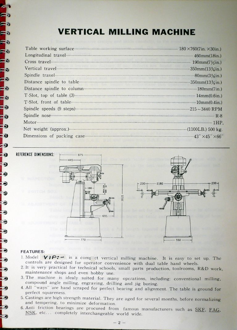

      Did a bit more digging and found a manual for a V1P that was on the Denford forum where the guy who has the manual says the words Warco A1s have been tipex'd out
