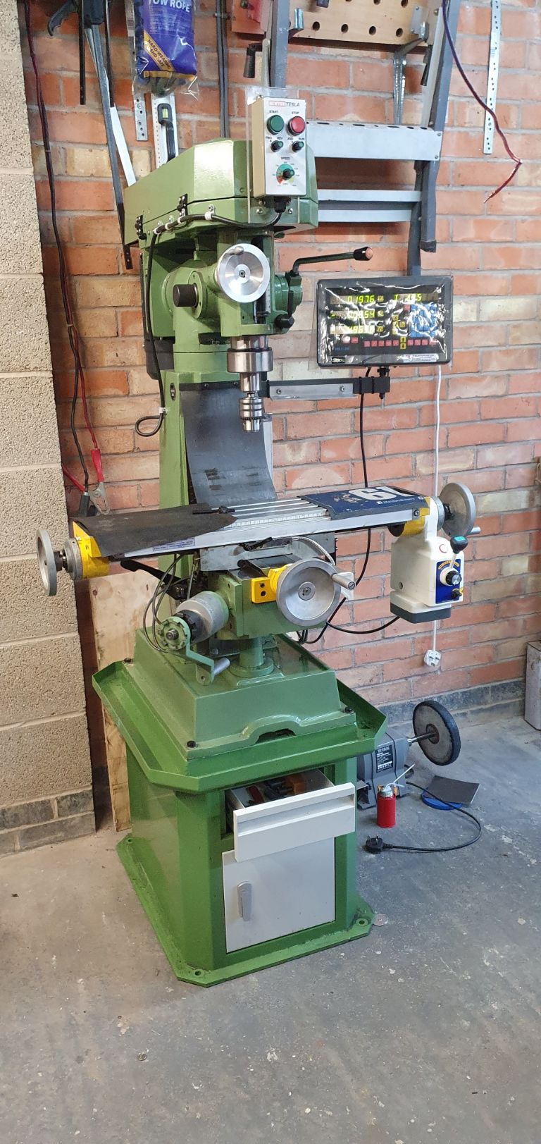

                            Andy Shepherdson
                              @andyshepherdson55441
                              Well if have bought a VMC with 3 axis DRO power traverse. I will pick it up on Sunday.
                              Thinking of a 5” vice, as I think a 6” maybe a bit big.
                              Andy
                              #549579
                              Andy Shepherdson
                                Collected the mill teamster day and it now installed in the workshop.
