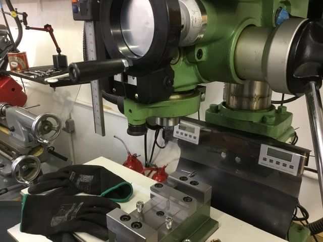

        I wish to modify my Warco Minor mill by fitting a spindle lock. I am considering doing something with the spindle pulley block with a pin and spring arrangement, but this would mean rotating the spindle by hand until the pin engages – not a very elegant solution. I have searched the forums but can find no advice. As these mills have been around for a long time I was hoping someone may have had a go a this. Any advice gratefully received.
        thanks Mitch

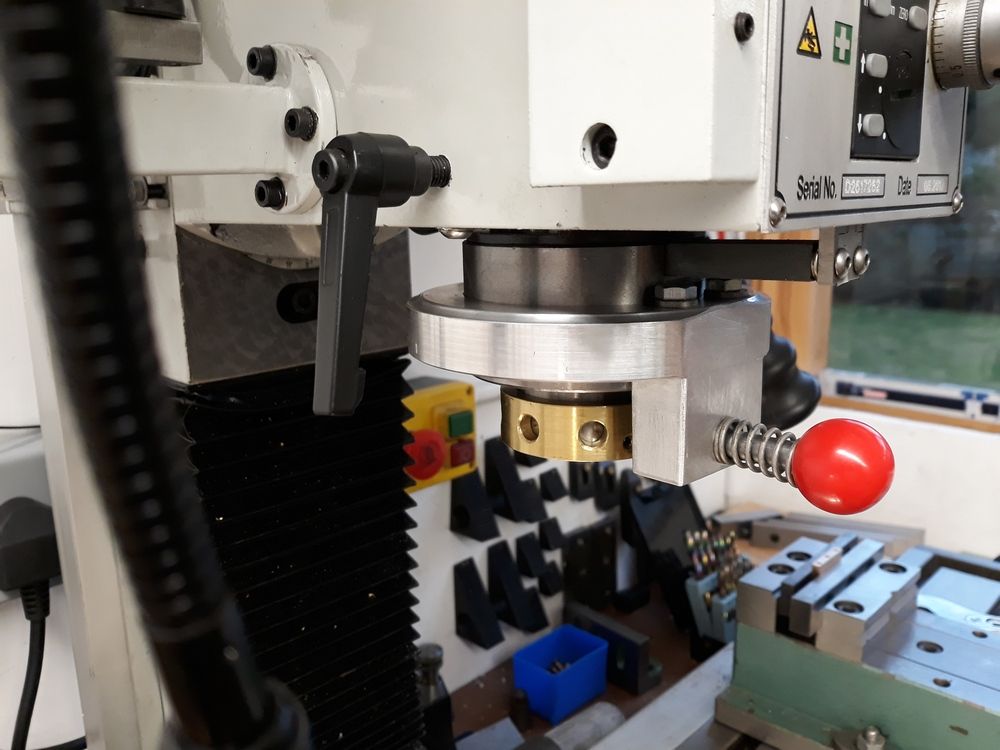

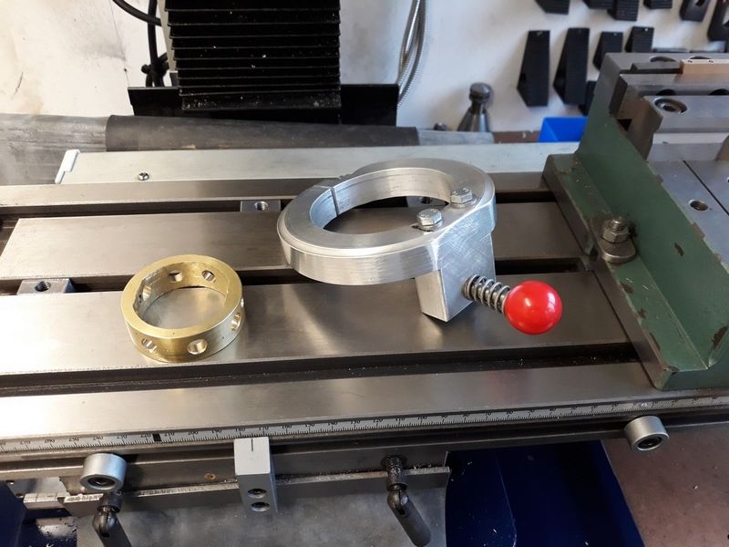

              Hi Mitch
              Below is the solution that I came up with for my Amadeal mill. Looking at pictures of your mill, I think a similar solution could be used.
              The large collar is clamped to the fixed spindle, and the smaller collar has flats cut into it which locate on the spanner flats on the quill.
              I have found it to be very easy to use, so much easier than finding the big spanner to stop the quill turning
              Good luck
              Colin

                          60d42b3e-8b66-408e-9b64-6b9d272bec58.jpegThe reason for wanting the spindle lock is to be able the change tools in the ER25 collet holder while in the process of making a part. To open the pulley housing cover means raising the head so the lid can clear the column, and unfortunately with round column mills this upsets the setting for the part being machined. I have been struggling trying to get pics uploaded – here is a try but one is upside down, but hopefully you will get the idea.
