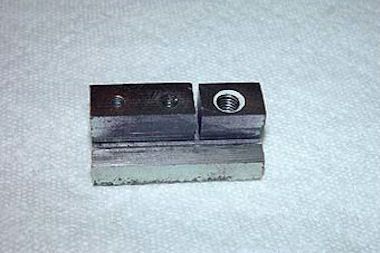

                                Journeyman
                                  @journeyman
                                  Posted by Bo'sun on 04/01/2022 09:45:27:
                                  I'm interested in Howards comment regarding adjustable pads. My WM250 doesn't appear to have any adjustment at the front of the saddle, or have I missed something? I have around 0.06mm of noticeable lift at the front and 0.01mm at the rear, which has a gib strip.
                                  The WM250 has a couple of guide blocks at the front just behind the apron. Not adjustable and one (as image below) also forms the saddle clamp, which on the older WM250 at least can't possibly work unless the block is left loose. It is possible to adjust the fit by either filing or using abrasive paper on a flat plate. I played with mine to re-make the saddle clamp *** See Journeyman's Workshop ***.
                                  It occurs to me that on the OP's WM180 with DRO the saddle clamp screw may be hidden beneath the scale depending upon how it is fitted.
                                  #578470
                                  Bo’sun
                                    @bosun58570
                                    Hello John,
                                    Thank you for that. A neat solution well executed. Although I agree, the parts could be better made in the first place. Not exactly difficult.
                                    I overcome the problem with the gib screws getting in the way, by using socket set (Allen grub) screws, with just enough thread for the locknuts. Then a shortened Allen key that lives in place all the time. Plus. it looks neater than sck hd cap scws. Done the same with the compound gib screws too.
                                    I'm going to try skimming a little from the guide blocks as suggested. If I take too much off I'll reach for the shim washers. Mind you, looking at the state of those from your machine, I might just make some new ones. I like the idea of shim washers though. If they wear in the future, just re-shim.
