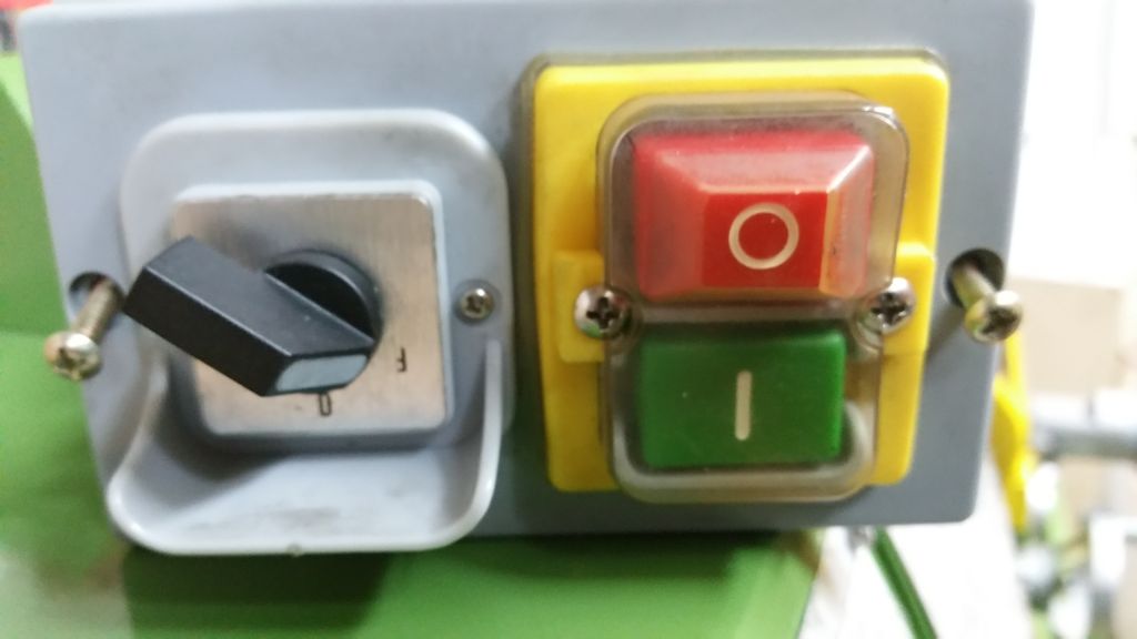

                                    Progress Update..
                                    Spoke to Don in Spares at Warco – his suggestion is that it is the switch unit although he has never had one go wrong. They have had 2 spares on the shelf for ages – they are £54 for the complete switch unit. Don was unable to suggest any tests that woudl conclusively prove the switch unit is the item at fault.
                                    I have "poked" around a little more. The picture below (if visible) is the front of the switch unit (upside down)

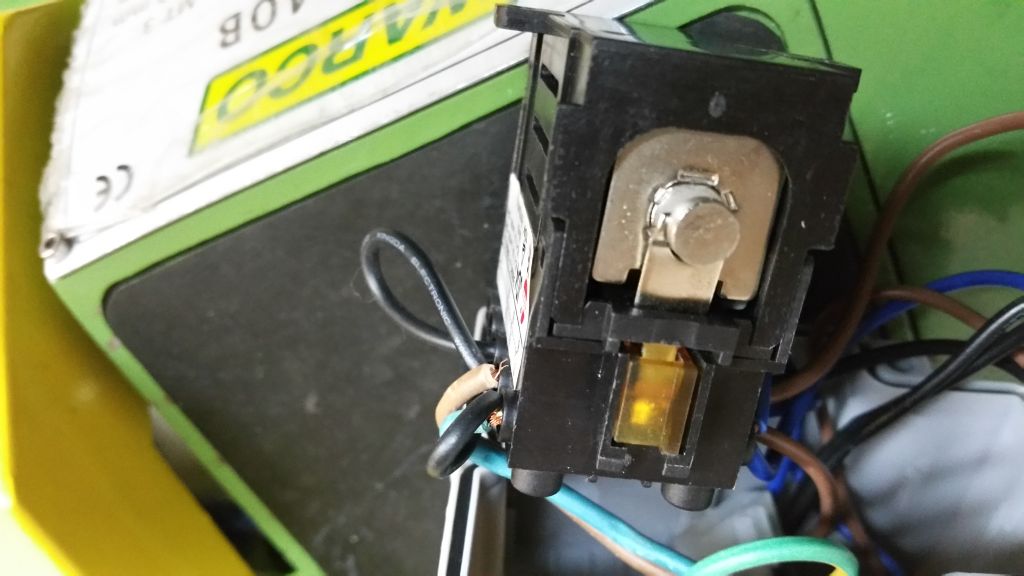

                                    The following picture is the workings behind the red/green button.
                                    The green button pushes the silver button in, making some contacts and energising a coil that holds the silver plate behind the button down (or is supposed to) The red button pushes on the yellow cover, levering the plate away from the solonoid and breaking the circuit. I assume this is what John referred to as a no volt relay in the post above.
                                    I have disconnected one of the power leads to the coil. When I push the silver button in everything runs, but it obviously doesn't stay on when released.
                                    When the power lead to the coil is connected and the silver button is pressed, it runs, but the switch vibrates violently (not buzzing) as it tries to alternately push then pull the contact away.
                                    I have checked the voltage across the coil – it is 240v AC. I don't know if this is correct – I would have expected DC in order for the solonoid to work correctly (although not certain). If this is the case, then it suggests that either the voltage is converted to DC inside the swicth (and it isn't any more) or that whatever is supplying the voltage is no longer supplying DC. or have I misunderstood.
                                    There are a number of contacts (3 i think) that are made when the switch is pressed.
                                    Edited By AndyM on 17/12/2015 14:51:37

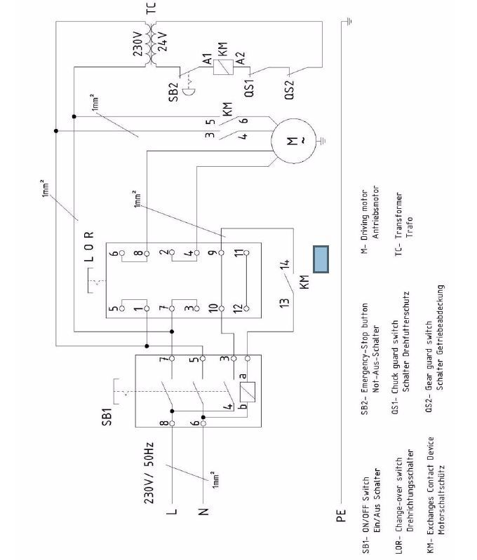

                                          Found diagram below which seems to match my lathe – not sure it's helped me much though

                                            To help you understand……
                                            SB1 is the NVR switch, 240 v in on pins 6&8. 240 v out on 5&7 going to the motor and the control transformer.4&3 switch a live feed via the LOR switch ( links or recht its german left or right fwd or rev if you like ) back to terminal a, terminal b being internally connected.
                                            Km is the contactor feeding the motor via 4&6. The contactor coil is powered via the secondary of the transformer via the E stop and the two interlock switches. 13&14 on the contactor for a latch for the coil on the stop/start buttons.
                                            If you measure the resistance between terminal 6 on the stop start switch and terminal 13 on the contactor you should read the coil resistance….if it reads ok, the check the contacts on the contactor terminals 13&14…you might have to energise the contactor coil if there is no manual means of closing the contacts via the contactor core
                                            I SHOULD POINT OUT THAT ALL TESTING SHOULD BE DONE WITH THE PLUG REMOVED FROM THE POWER SOURCE……….sorry for shouting but we dont want any accidents…..

                                                Thanks John, that helps a lot.
                                                I'd worked out SB1, but coudln't fathom out what KM was doing – you explanation really helps.

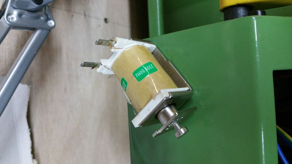

                                                Since my last post I have dismatled the switch further and removed the solonoid (see pic)
                                                I have applied 240v to the solonoid and it clicks into place nicely and remains latched, leading me to suspect the problem may with with the supply to it through KM
                                                Andy

                                                  hmmmm…. Put the solonoid back in the switch housing, left the lathe power disconnected and applied a seperate 240 feed to the coil and it doesn't latch – just rattles like before….. investigation continues but I feel were getting close…

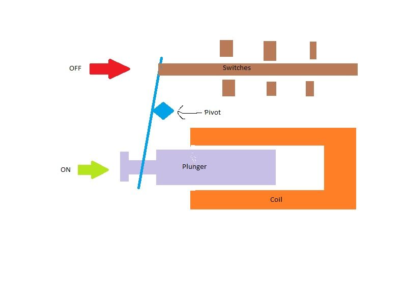

                                                      Yay – Solved it.
                                                      Please excuse the scruffy drawing.
                                                      When the plunger goes in it pulls a switch contact bar out. The plunger wasn't able to go in far enough and was hovering in the magnetic field, on the bring of latching.
                                                      To solve it I bent the blue bar above to allow the plunger to go in slightly further.
                                                      The stop button has always been very sensitive so I guess it's always been on the cusp – I don't know why it stopped working, whether it's cold in the shed and something shrunk, or whether the coil is getting tired, or whether the switch bar is getting stiff or ……. but it's working fine now – I may have bent it a little to much as the stop button now needs a good press to disengage.
                                                      Thanks to everyone for their help and guidance.
