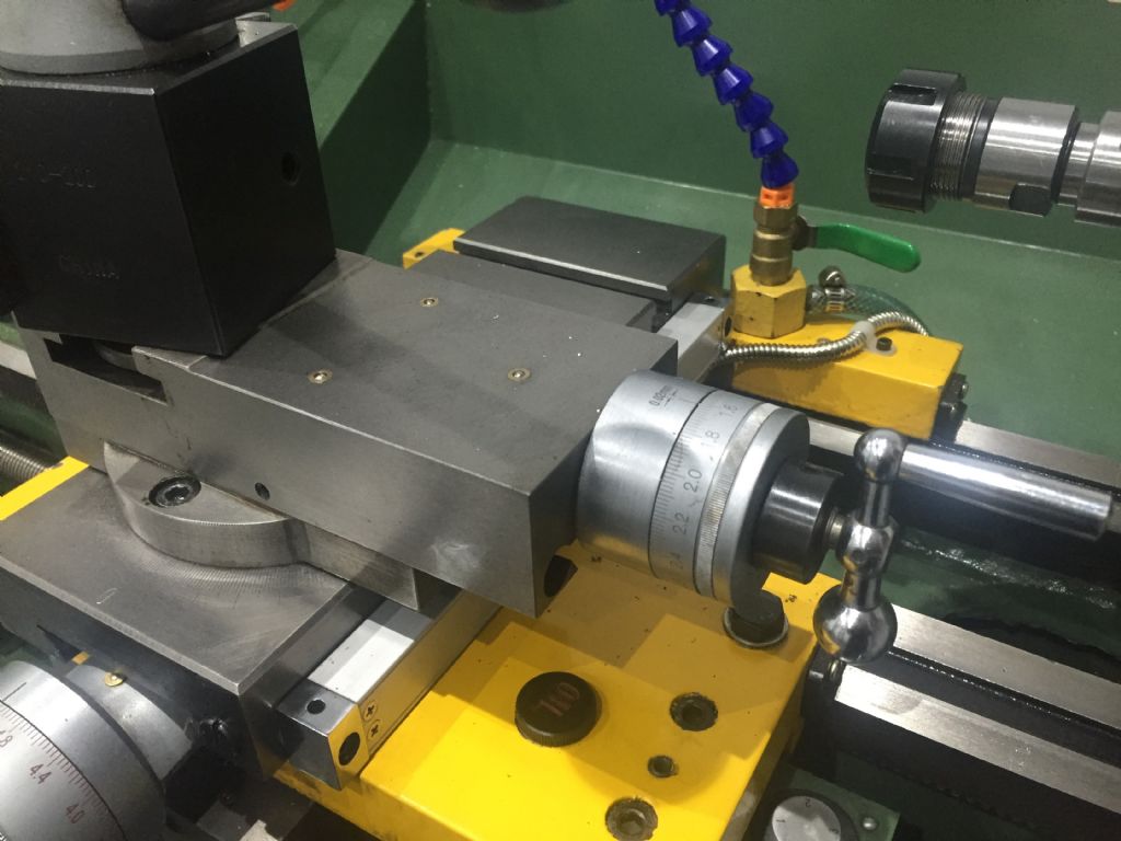

                                        My current dilemma however is the new Jib for the cross slide. I have marked out drilled and tapped the slide for the jib however in the "how to" on chester machine tool's forum the guy uses an Aluminium Bronze piston/ jib… My question is does it have to be ali bronze as its ridiculously expensive! 1/2" round by 6" long is £43 disgust could i not just use aluminium or Phosphor bronze? I Know it has to be soft enough that it doesn't mark the carriage but hard enough that it doesn't just squish after a couple of uses.
                                        Cheers
                                        Steve

                                          Use a pound coin. It is very similar to aluminium bronze and the only part that needs to be in the correct material is the face in contact. There are plenty of forgeries in circulation so if you use one of those you are not breaking any law if you destroy it.

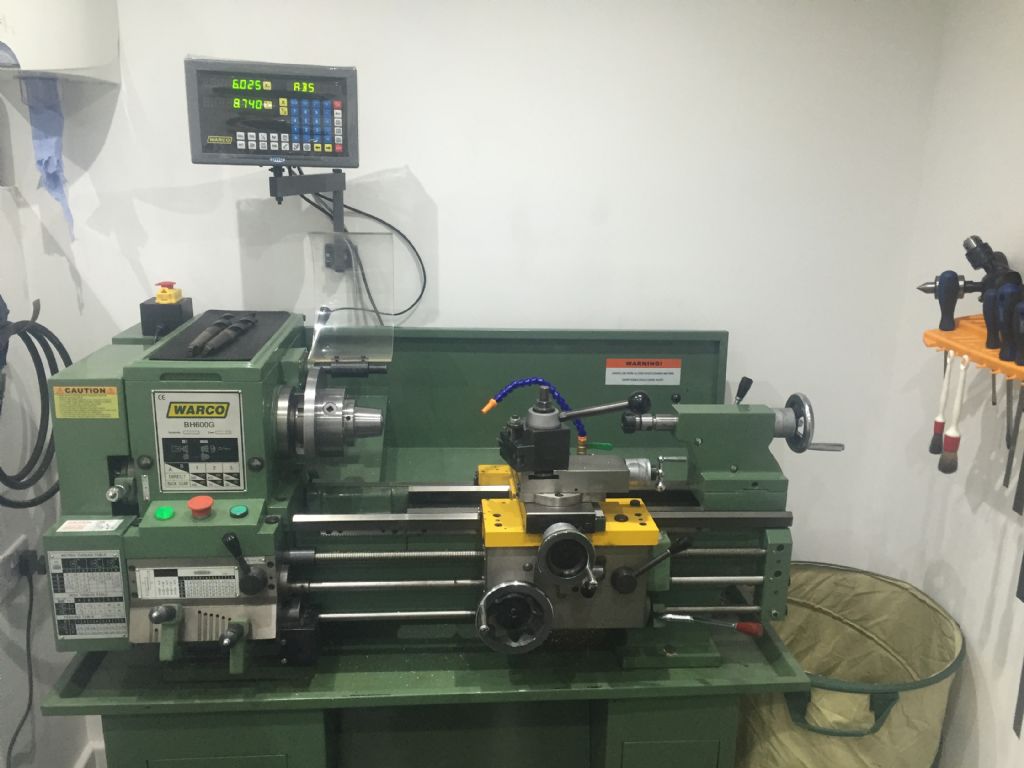

                                                Sorry its been a while guys, i have managed to get the DRO installed and working a treat! Also thanks to the mod suggested by DDT. The how to guid on the chester machine tools forum was a doddle to follow, had the slide off, drilled and tapped in no time! What i would like to know however is whats this chap called thats sitting on my surface plate? I want another one but in M8, just can't find the correct name for it?

                                                    Another question now i have a photo of my lathe up. I have finally go round to installing my collet chuck, just wondered what the tolerance should be and where its range of accuracy should be measured? I would have thought there should be 0 run out at the chuck end but should i also expect to see 0 say at 6" away? I have a 1/2" silver steel bar that i can use to test the chuck, Is this accurate enough?

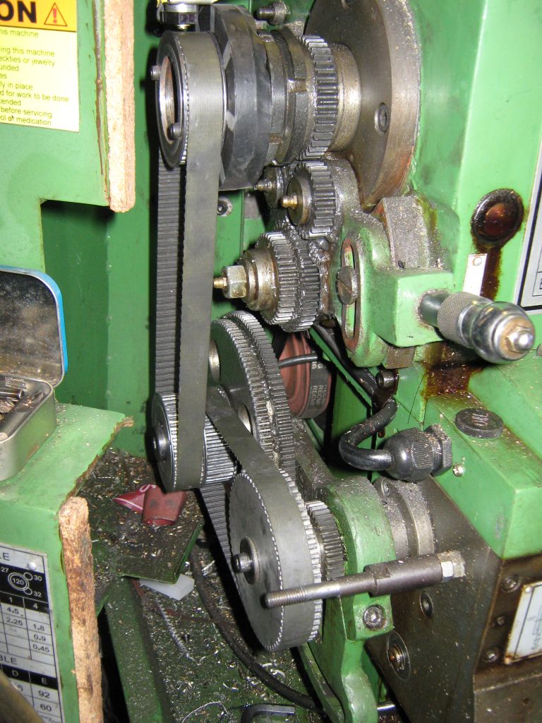

                                                      @gocreate
                                                      Hi Steve
                                                      Regarding the gear train noise I fitted 2 timing belts as shown in the photo below. With this arrangement rotation of the Banjo to disengage the gears from the spindle drive allows engagement of the timing belts and vise versa. The intermediate gears are also moved along the banjo slot to dis-engage with the final driven gear.
                                                      I use the time belts for normal feed, for screw cutting it's a quick changeover to engage the gears and dis-engage the timing belts.
                                                      I did this mod 10 years ago and it's worked without any problem.
                                                      Additionaly the time belt is arranged to give finer feeds as compared to using the gears.

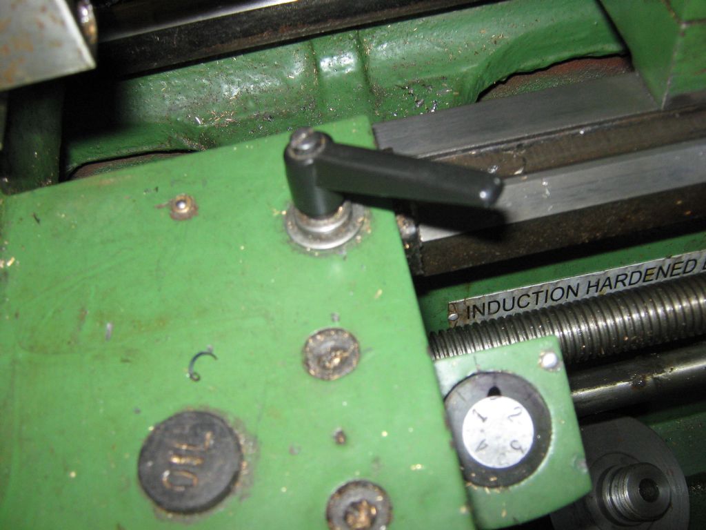

                                                      For the carriage lock I used an indexable lever.
