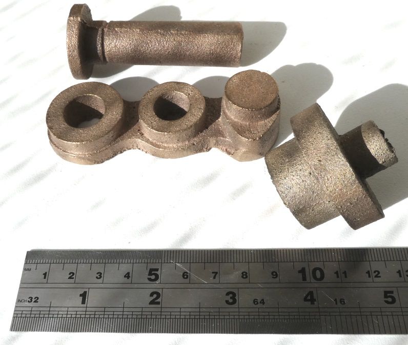

                                            A box of unmachined GM castings came with the lathe and I have identified most of them as being for a loco.
                                            However, three of the castings appear quite unrelated and I was wondering whether they might be a part of a kit for modding the lathe. I have read that the lowest feed rate on the lathe is a mite to fast for comfort and wonder whether these castings together with an extra gear/gears could be configured/machined to provide a solution.
                                            Are the castings lathe related or are they spare parts for grannies mangle?

                                              To lower the feed rate the most likely solution would be another stud on the banjo if there is room but you wouldn't use castings for that. The top one looks like it could be machined to take the two cored collars from the second. But the rhs of the middle one looks to have an oval flange perhaps combined with the bottom one to form a stuffing box on a piston rod.

                                                The castings do not look like anything related to the lathe. Possibly they were jobs on the "Round Tuit".

                                                  Thanks Bazyle – grannies mangle it is then. Thanks Howard and your 80T gear sounds like the solution. I'll have to see if I can track one down as I MUST crack on with the model I am working on otherwise it will never get completed. As they say, time waits for no man. I think I should have chosen horology instead of steam – at least I could have turned back the clock. vamp
