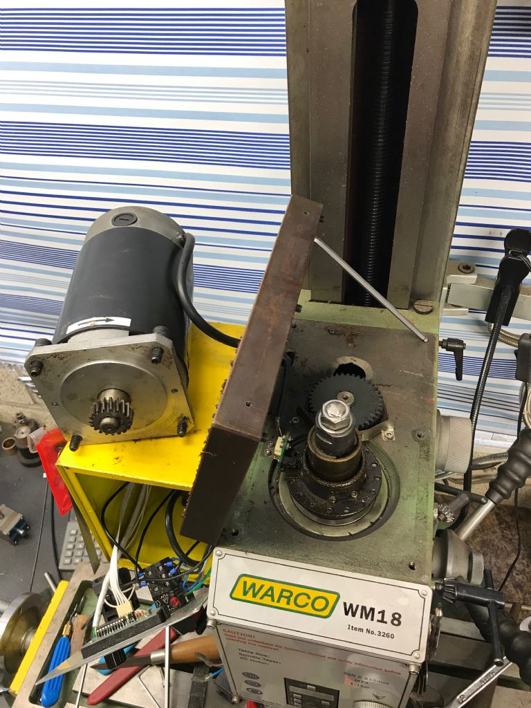

      Hi Daniel. I will have a look. It was vibrating a bit. It might have worked loose.
      Cheers
      brian

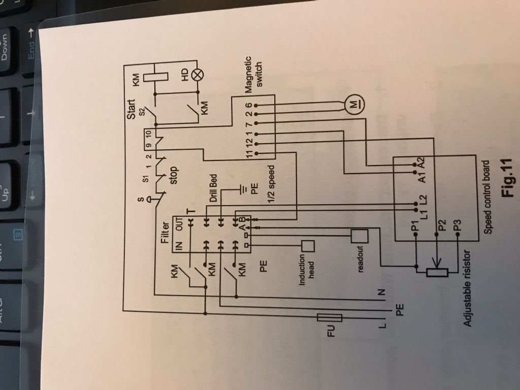

        I removed the top cover but there is nothing hiding in there.
        I also had a look in the control box, there is a ribbon cable that goes from the digital display to a small circuit board and that looks ok?
        This is the circuit diagram that came with it.
        No signs of a tacho?
        #414741
        Daniel
          @daniel
          Hi Brian,
          Can you post a photo of the top of the spindle ?
          With cover removed.
          I'm watching this space.
          HTH,
          Daniel

            ERM i put it all back together there really was nothing. Just the motor and the casting top!
            I think its generated by the filter somehow?
            Bri
            #414743
            Boiler Bri
              @boilerbri
              Just spotted that there is an induction head, maybe that's something to look for by following the wires. Too bleary eyed now and enjoying a Dads day beer beer
              Will try tomorrow

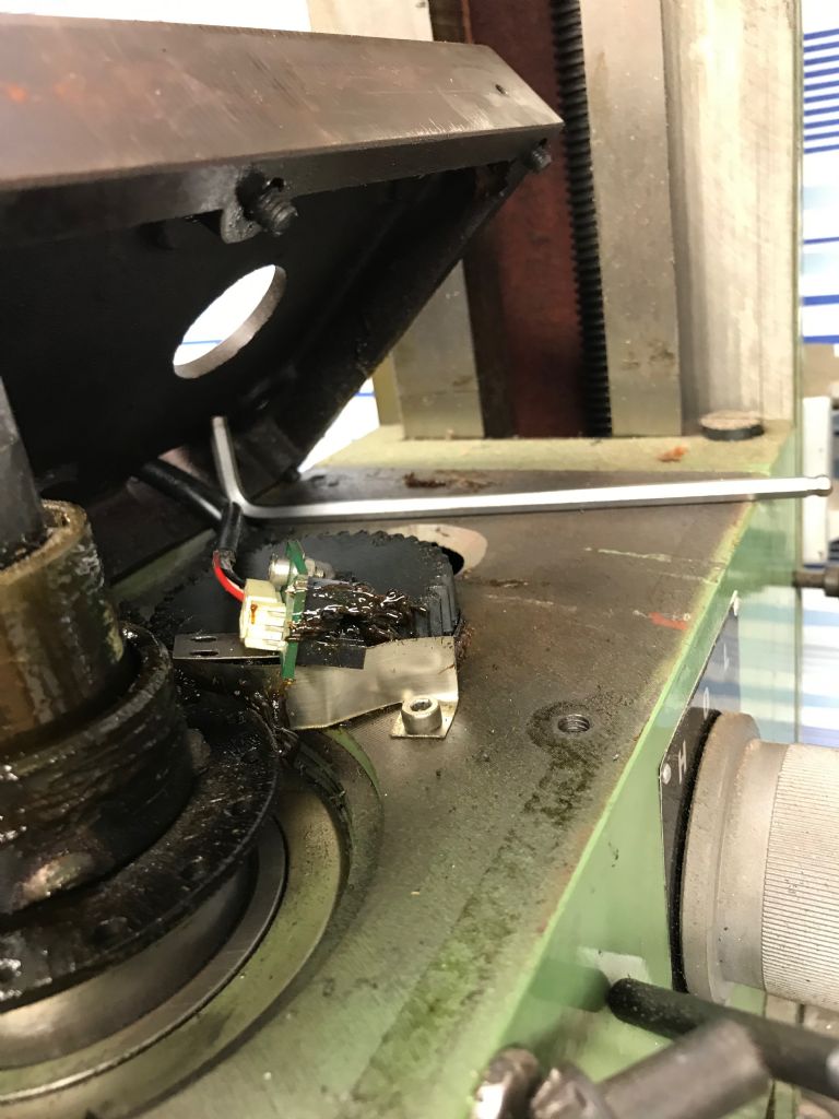

              #414745
              Daniel
                @daniel
                Hi Bri,
                I would remain convinced, for the moment, that the tacho reading is more dynamic.
                Can you post some photos of the general gubbins ?
                Hoping to help,
                ATB,
                Daniel

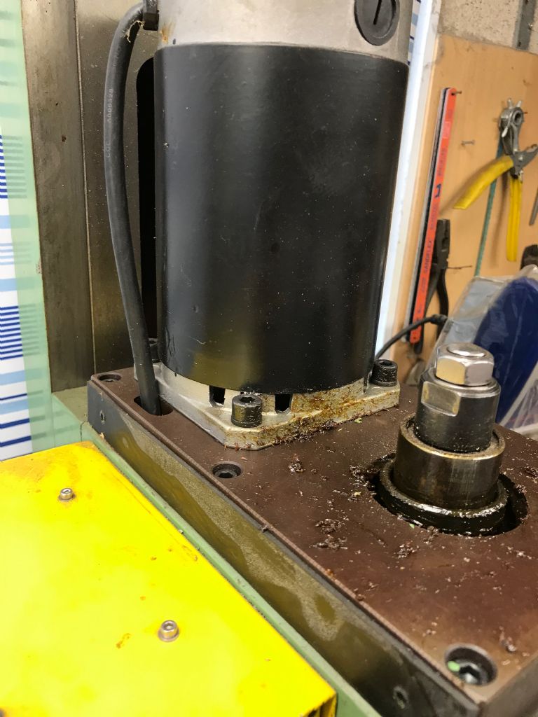

                #414789
                Boiler Bri
                  @boilerbri
                  Hello Daniel,
                  It looks like you were correct. The motor is mounted on a plate and underneath is the disk and counter unit.
                  Running at high speed has sent all the grease outwards and into the unit.
                  Thanks for your help.
                  Brian

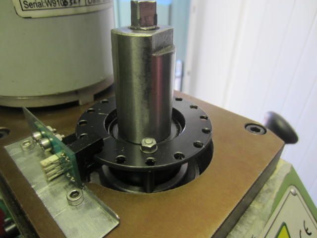

                  #414842
                  MichaelR
                    @michaelr
                    On my WM18 I altered the position of the counter unit as in photo. Mike.
                    Mod 1
                    #414845
                    Boiler Bri
                      @boilerbri
                      Thats a good idea Mike. I will probably do the same to mine.
                      For now i am up and running again.
                      Cheers
                      Bri
