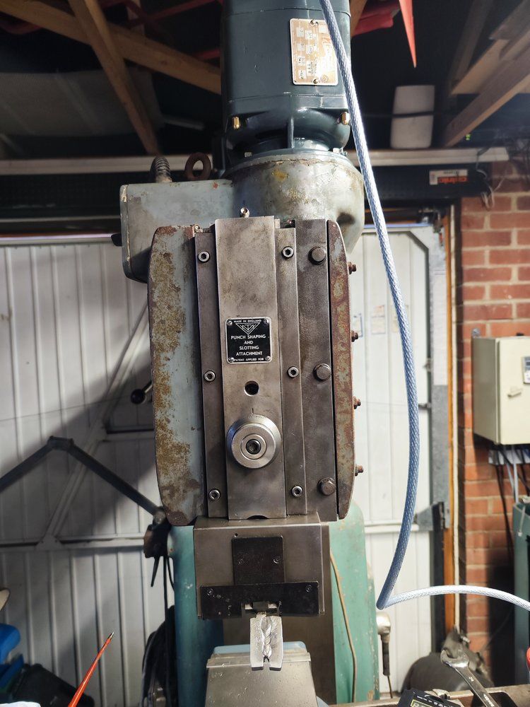

      I got a Victoria slotter/slotting attachment with my Elliott TV2 milling machine.
      The problem is, I don't have a clue how it is supposed to work/hold tools.
      Let's start with a photo of what it looks like now.
      Victoria Punch Shaping and Slotting Attachment 1

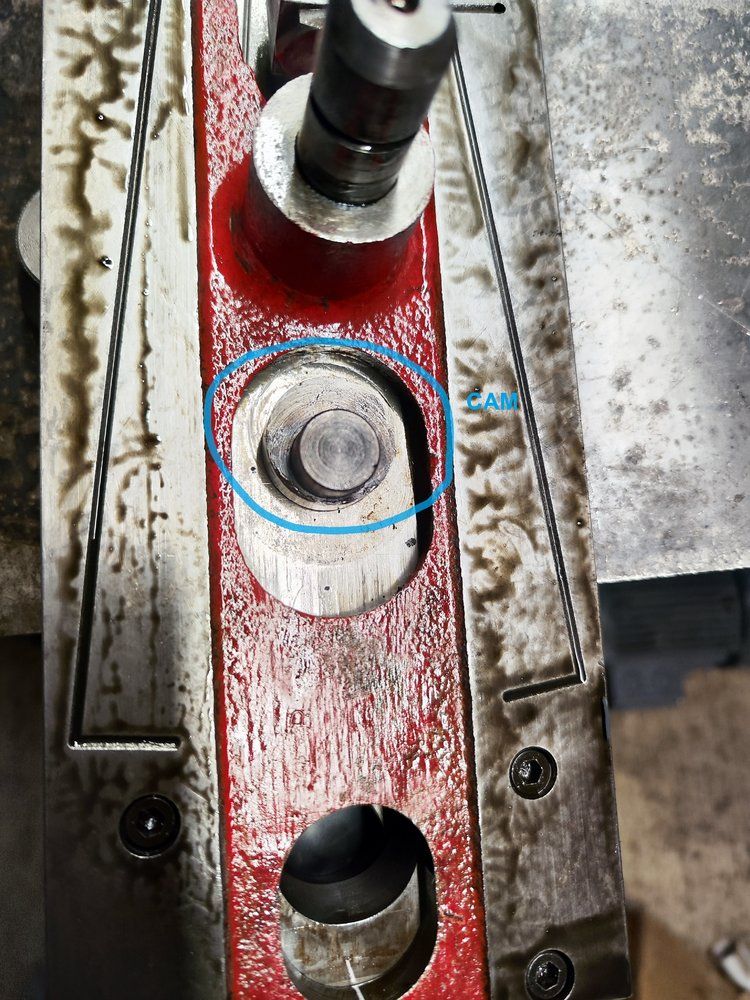

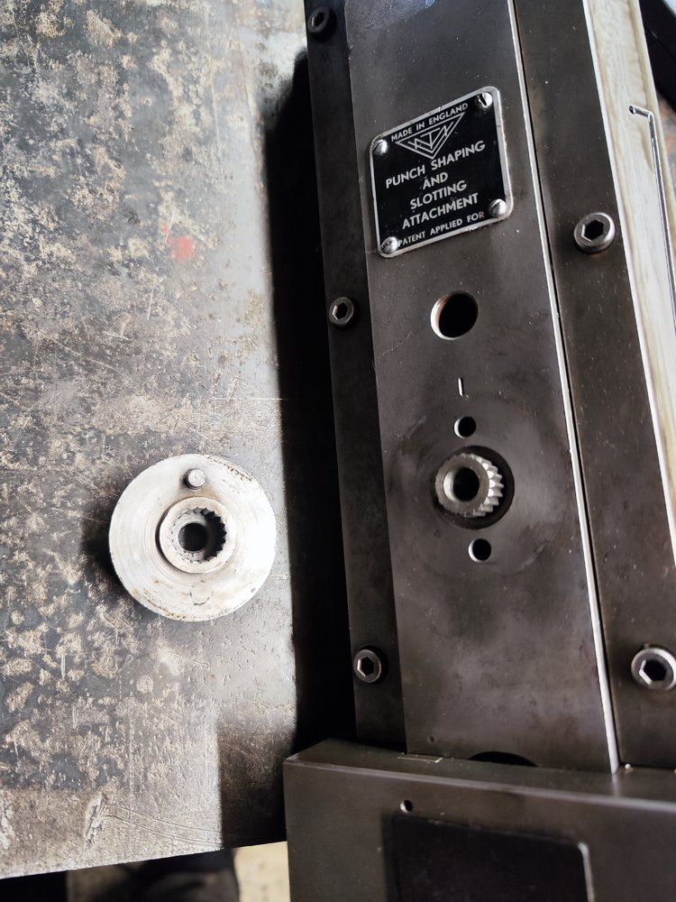

      This is the adjustment knob with the SLOT and RADIUS settings
      Victoria Punch Shaping and Slotting Attachment 2
      When I took it apart the first time to clean it all up the cam fell out so I don't know what the original setting was.

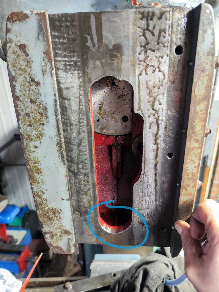

      I believe the cam operates on the bottom area of the slot on the cast housing.

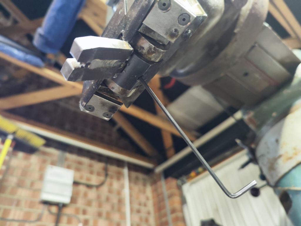

      It came with a (looks homemade) tool/tool holder.
      Which can be removed by loosening a grub screw.
      ictoria Punch Shaping and Slotting Attachment5
      Victoria Punch Shaping and Slotting Attachment 6

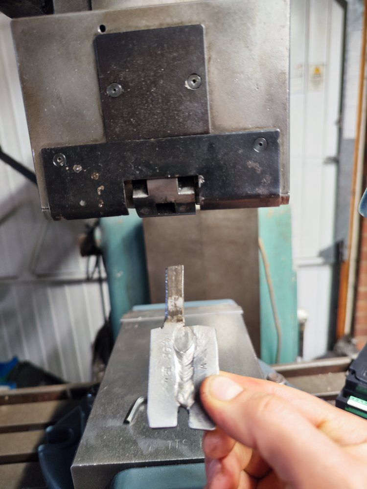

      I made a quick video to show the difference between the 'SLOT' and 'RADIUS' settings.
      Now the questions:
      How do I use this contraption (SLOT/RADIUS)?
      How do I secure tools to it?
      Any recommendations for tools to buy so I can cut internal keyways on pulleys etc?

              With regards to slotting internal keyways I don't think tooling is readily available to buy. I just grind the shape on the end of a short length of HSS, or use a push broach.

                    If you are using the radius capability you will need a short piece of tool steel held directly in the rotating shaft as shown in the patent drawings. I imagine the slot matches a (then?) standard imperial size so it can be relatively securely held by the grub screw.
                    For simple slotting I guess some sort of offset holder will be needed to put the holding shaft rotating axis in a similar position relative to the tool tip as the common clapper box system. On a normal shaper the clapper box pivot is significantly behind the tool tip position. Maybe up to a couple of inches on my Elliot 10M depending on tool size. I'm not familiar with vertical slotters but I imagine the geometry is similar.
                    Somewhere in one of my books there is a discussion of the engineering reasons for this arrangement.
                    The simple grub screw appears much less secure than the hefty bolt usually found on shaper tool posts.
                    I imagine tooling of similar shape to that used on the Bridgeport E head would be needed. As the E head is relatively common in home shop enviroments some information can be gleaned from the internet. Here are some nice pictures of the E head clearly showing how the clapper box is arranged **LINK**
                    https://www.ukworkshop.co.uk/threads/bridgeport-e-head-or-shaper-head-help.136483/
                    Its clear that the actual tool tip is offset relative to the clapper box pivot. I imagine that a dog leg tool holder could be made to replicate that geometry. Round shank with a flat on the tool to take a grub screw worked for Bridgeport so should be fine on yours. The real Victoria tooling is probably different but geometry must have been similar.
