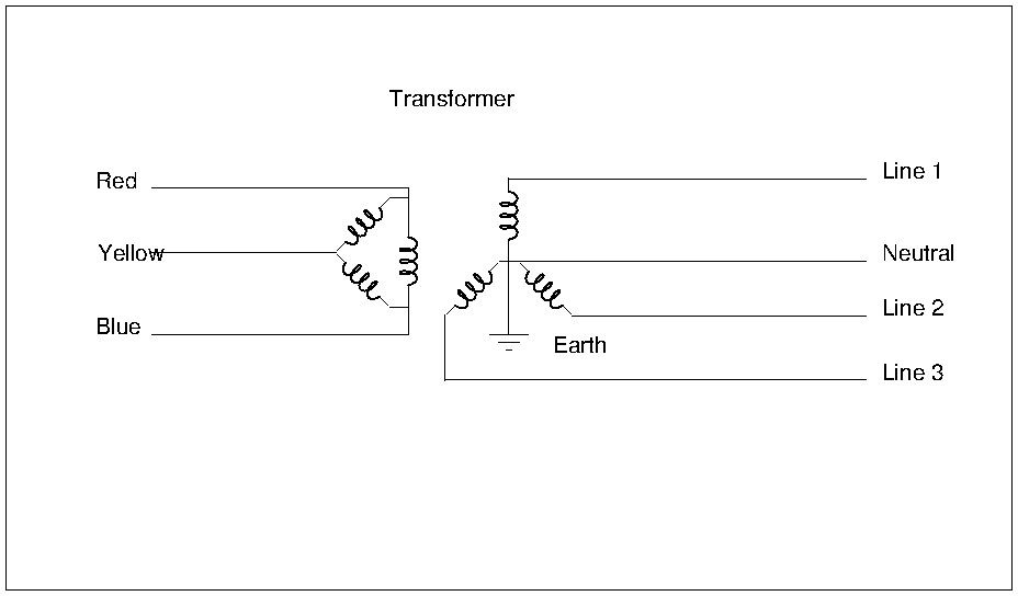

                                    #445296
                                    Anonymous
                                      In the UK electricity distribution is 3-phase and earth, no neutral. At the local sub-station transformer the primary is wired delta and the secondary is wired star. So the secondary has a 'neutral' point. This is grounded at the sub-station. The cable running down the road has three phases, the neutral (aka earth at the sub-station) and a protective earth. The sub-station transformer is arranged so that the voltage from any phase to 'neutral' is 240V, while the voltage phase to phase is 415V, ie, times the square root of 3. So a property on single phase will have an earth, neutral and live (from one of the three phases). An industrial property will have the three phases and earth. A neutral may also be supplied for any single phase loads. That's what I have at home; three phases (which are fused) a neutral (which isn't fused) and an earth. I run the house off one phase and the neutral whereas the workshop runs from 3-phase. The neutral also runs around the workshop, but none of my machine tools use it. They just take 3-phases and earth. Remember that all quoted voltages are rms aka root-mean-square.
                                      I feel the need to go and machine a large lump of steel! If no-one has explained why a 240V in VFD cannot normally produce a 415V output by the time get back then I'll explain.
                                      Andrew
                                      #445299
                                      Anonymous
                                        Should have mentioned that the reason the phase to phase voltages are higher is because the phases are time shifted with respect to each other by 120 degrees.

                                                Posted by norm norton on 08/01/2020 14:20:39:
                                                I thought I had a limited understanding of this, but now I am confused.
                                                If a residential road is fed with three separate phases of 240v, then each house takes a feed from one of those phases and has single phase 240v. If an industrial premise takes all three phases then (I assumed) it has an available feed of 415v (or 380v or whatever) 3 phase. Correct or wrong?
                                                Or are there transformers on the old poles to drop 415v lines down to 240v domestic?
                                                Now if you take one of the 250v phases, and put it through a VFD box, is the output actually three separate 250v sine waves each shifted by one-third of a cycle. If so, why is this phase adjusted supply not producing 415/380v 3 phase?
                                                I need to see the actual AC diagrams perhaps of the two 3 phase scenarios I have described. I think Gerard was asking the same question.
                                                Norm
                                                Wonder if this helps.
                                                The diagram is typical of a UK sub-station transformer wired to supply a mix of single and three-phase consumers.
                                                Electricity from the power station arrives at high voltage on 3 wires and is connected to the input side of a 3-phase transformer wired in delta. Using 3 wires to transfer power at high voltage reduces resistive losses and hence the size of the wires needed. Unfortunately, 3-phase at high voltage is dangerous and inconvenient for most domestic purposes: imagine the circuit needed to switch a 3-phase light bulb on and off! On the other hand, industry needs 3-phase for big motors, electric furnaces and other heavy equipment.
                                                Fortunately, both single and three phase can be produced by wiring the output side of the transformer in star (aka 'Y&#39, and making the centre point made available as 'neutral'. Note the consumer side of the transformer has 4-wires, plus – not shown – some kind of earth safety as well.
                                                The voltage between Lines is 440v 3-phase. The voltage between any Line and Neutral is 230V single phase. In a factory, the system might be used to supply 3-phase to equipment and also single phase to domestic services like lighting. Care is taken to ensure 'Live' from different phases is kept well apart in the same building.
                                                Houses are connected in groups to different phases of the same supply. Be careful borrowing power from a neighbour – there's a slight risk his house might be on a different phase! Trying to buy a 3-phase supply for a home workshop meets with mixed results because the convenient availability of all three phases depends entirely on local details. My village has 3-phases and neutral on overhead wiring in the street outside: easy! Not everyone is so lucky – in suburbia, they might to dig a long trench back to the substation.
                                                Has to be said 3-phase electricity is the work of geniuses! Not obvious how it works, or that it neatly solves several different awkward supply problems. For example the system is self-balancing, ie able to cope with one phase being lightly loaded whilst the other two are working flat-out. Clever stuff squared!
