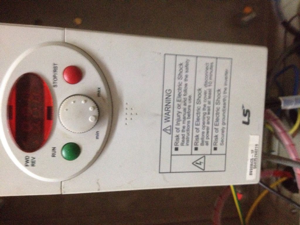

      Hi was using mill today and it just stopped while doing a fairly heavy cut.There is power going to the VFD but it is not coming on.I have pressed the reset and the run button but no joy is there a trip or any such like that I should look for inside this VFD?img_2961.jpg

          Its probably easier for you to look in the manual as no one here is likely to know the model number.
          Doubtful if you will see anything amiss if you open the casing.
          Are there any error codes showing?
          Was there a pop and a bang, or maybe a burning smell?

            Don't have a manual.No pop,bang or burning smell.No light up on the screen.

                    Its not the plug fuse.The VFD is an Ls sv008ic5-1f have down loaded and am reading through now.

                      The VFD clicks for a second every 45 seconds it partially lights up the fans give a kick and then off again.

                        If the symptoms you see are not mentions in the manual and there are no error codes showing then I suggest you disconnect all the control wiring from the VFD, leaving only the motor and power in connected. Then carry out a factory reset and return the VFD to an 'as new' state.
                        Input the basic motor details and see if you can control it using the VFDs own buttons. If it is still faulty then my diagnosis would be that it is a real faulty that probably needs a board level repair.

                          Sounds as if it's popped to me. Twitching periodically sounds like a pretty serious internal issue. If so, bin it and buy another, as repair won't be economical.
                          If you discover a blown fuse somewhere inside, bear in mind that they are fitted to prevent fire or hazard in the event of a circuit failure. Replacing the fuse is unlikely to repair the fault but if you use the wrong sort, you could create a risk of fire or injury.

                                Thanks for all the replies guys I think she is cooked.
