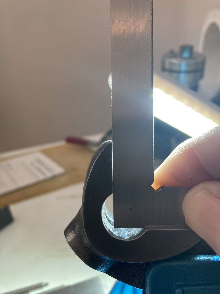

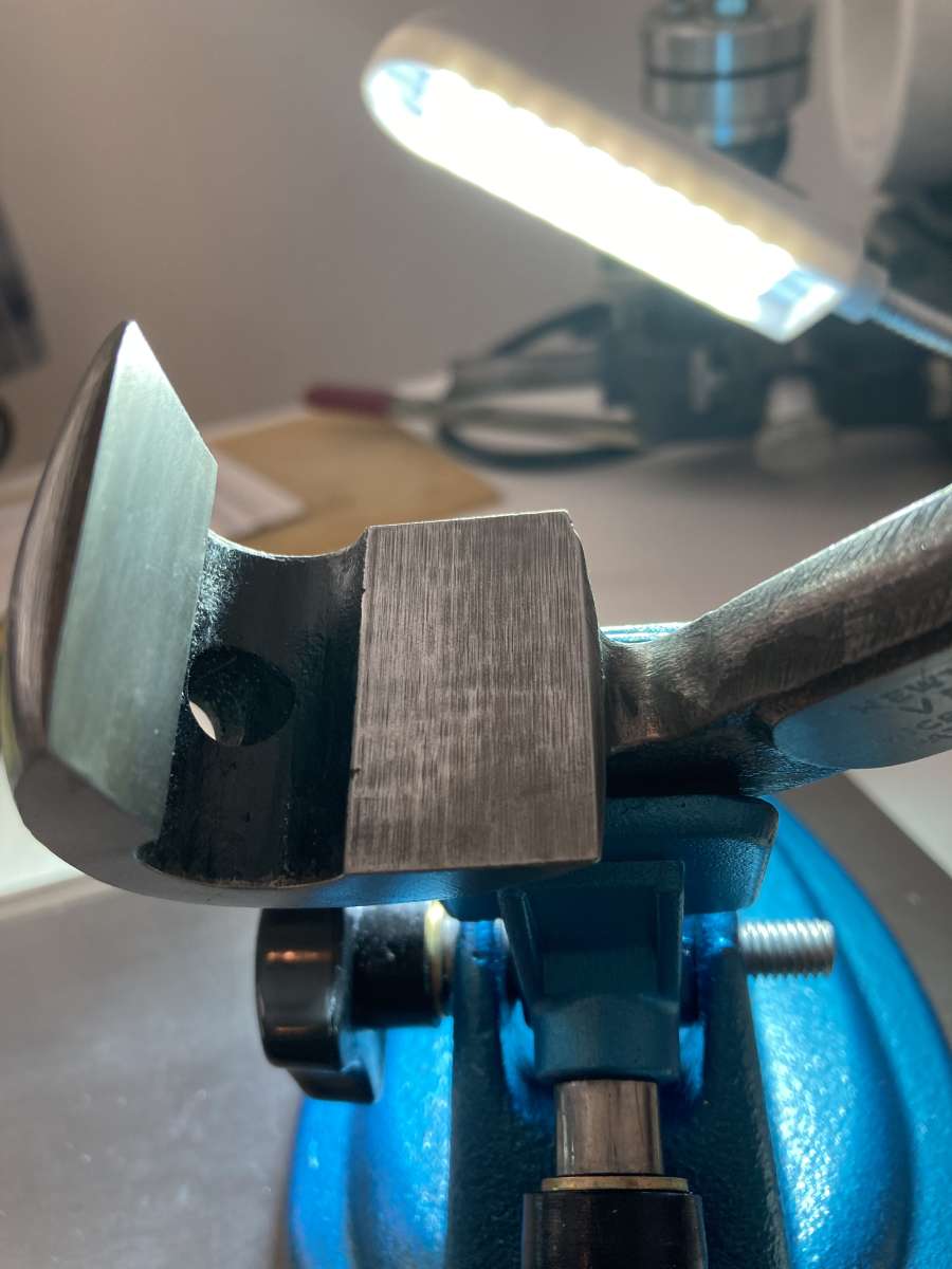

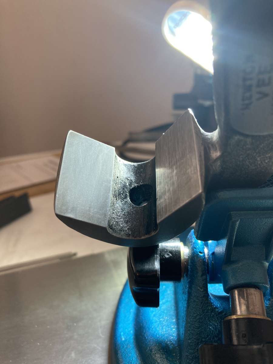

      Hi All, I have a Newton Vee Micrometer and the V is not 90 degrees, more like 91 degrees. Probably wear? It has 1.75- 2.75″ hand stamped on it. I’m considering making a milled square with one milled corner edge to be able to set heights of slip gauges. It has a 0-1 Moore and Wright stem micrometer on it.  I  can’t find any info about Newton company, British, Canadian, or USA made.  There’s a patent number inscribed with the makers name, 397631, but I’ve tried various patent offices with no luck. It’s very old and would love to know any history. Many thanks, hy toolman.

              IMG_3495IMG_3496IMG_3497Hello, many thanks for your reply posts. Michael, the patent you found contains all that I need, thanks. 1933 tool from Barnsley, 1/2 hour from me! The off 90 is shown in a photo and the Vee sides are one polished, the other has horizontal lines but is smooth, no burrs etc. It can’t measure 3 flutes, that needs to be a 60 Vee. I can set it to zero with ground stock but this tool is not for this purpose. It’s to set and adjust the tool tip of boring bars. If anyone cares to read the link Michael sent, it’s an eye opener.

                I have four of these, bought at a batch for very little money a couple of years ago.
                Mine are well worn, with comparatively deep grooves in the V faces; three seem to be near enough right angled, but one, like yours, is a degree or so off.
                I was considering re-grinding the V faces on a small Herbert Junior, but have been putting the job off until I can come up with a way to ensure the two refurbished faces will have exactly the same amount taken off, whilst still retaining the 90° angle, and being equidistantly aligned to the axis of rotation of the micrometer head.
                Unlike more sophisticated grinders, the Herbert only has a micrometer adjustment on the vertical axis, so front to back needs a dial gauge and careful handle twiddling, with no feed lock.

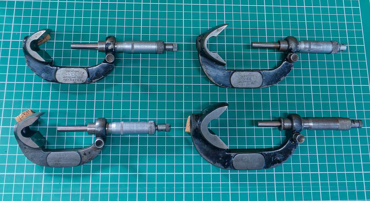

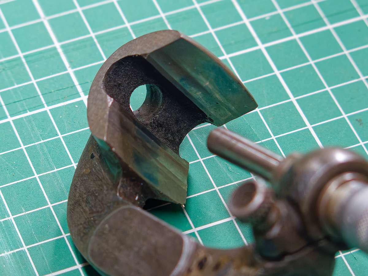

                                Here you go, just popped out to the workshop for a quick grab shot
                                S6250120_DxO-Flickr
                                Sizes from lower left clockwise; the smallest shows zero with a 1″ standard, but it’s obviously adjustable.
                                Top left 1.25″ and the two on the right are the same nominal size closing down to zero for a 1.7″ bar.
                                Note the thickness of the V sections on the larger pair is quite different, suggesting multiple re-grinds.
                                This angle shows the sort of wear I mentioned
                                S6250121_DxO-Flickr
                                It still works OK, but is less than ideal on some diameters.

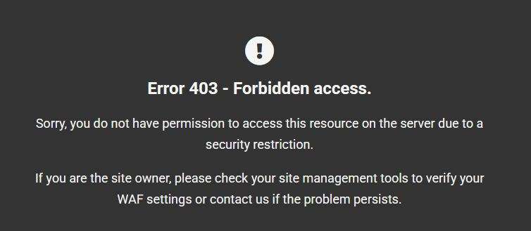

                                          This is now the 4th attempt
                                          I’m getting ready to give up trying detailed replies on this forum;
                                          Just spent 40 minutes writing a reply only to receive a 403 error on submission saying I no longer have access to this forum and to contact administrators.
                                          403 error
                                          I’ll try an abbreviated reply compiled in Notepad;
                                          The various parts, frames & mics, all arrived together, and are obviously quite old, so I can’t definitively state which mic belongs to which frame.
                                          The top right has the same style of ratchet as the rest, but the end cap, screw & pawl are missing, as I moved them to one of the other mic bodies, which was in better condition.
                                          Three mics are M&W with a satin chrome finish; the one currently showing lower right is engraved Ambrose Shardlow, it in a plain steel finish.
                                          It pre-dates GKN-Ambrose-Shardlow, or GKN-Shardlow, (engravings vary) a company which was later absorbed into M&W.
                                          Of the two on the right, the upper one has a lighter frame construction, though is of the same nominal frame size as the lower one; the frame is thinner, as well as having less substantial V sections.
                                          Overall the wear patterns are different suggesting regular use on different boring bars, if indeed that was their use during their working lifetime, as clearly they could be used for different applications.
                                          Top right, the satin chrome M&W body does have loads of deep scratches; I think they are longitudinal scratches/machining marks, rather than compression ones from pliers or similar.
                                          Lower right is in good nick, but harder to read, dues to the lack of satin chrome plating, though it does retain the knurled locking collar, absent from the M&W ones, though they are all threaded for one.
                                          I’m not sure it ever had, or needed a wavy washer, as different mics in my collection vary.
                                          Looking at the engraved sections of the frames, the smallest one seems to have the patent number in a larger typeface, and also the clamping screw features a plain knurling, whereas the rest are diamond pattern.
                                          Maybe this makes it the odd one out, and originally housed the Sharlow mic??
                                          Maybe the original user had loads of them and this is a random mix of parts, as they are all interchangeable.
                                          On the other hand, top right has a lighter frame, so maybe that’s the oddball.

                                                  I too was puzzled as to why the vees were cut to about 91 degrees. I may have an explanation. When trying to measure the diameter of a round part in a vee block with 90 degree faces, the height of the top of the part from the bottom of the vee is 1.2071 times the part’s diameter. By cutting the vee with faces at 91 degrees 10 minutes and 10 seconds the ratio changes to 1.2 times. The factor 1.2 can be remembered, and the multiplication can be carried out without a calculator. This would have been important in the 1930s. It would also have made it practical to use the micrometer to measure the diameter of round parts.

                                                    Hi, that’s a beautiful answer. Graeme
