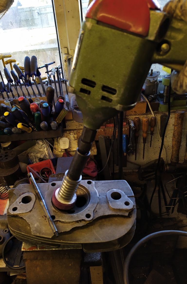

                  I too was a great fan of Neway valve seat cutters until I acquired a Wolf valve seat grinding set. Overall much lower in cost than the Neway kit and easier to use especially if there is a lot of material to shift. These wolf sets come up for sale on Ebay regularly and new stone are available. Dressing the stone for truth and shape is easy. The photo shows a spindle that fits in to the valve guide, stone turns on that. The thing that looks like an electric drill (it's not) spins the stone at ~10000rpm.

                          Posted by John MC on 14/10/2021 15:00:41:
                          John MC almost certainly knows this already, but for the information of other interested parties, the Wolf and Black & Decker grindstones are interchangeable, both have the same 9/16" OD thread. The valve guide mandrels are also interchangeable @ 3/8" diameter. But the 'ball hexagon' driver and hexagon socket on the Wolf grinder kit are smaller than the B & D one, so don't happily interchange. I had both sets at one time, but sold the Wolf kit on to avoid (my) confusion.

                            Stueeee, no, I didn't know about the interchangeability between Wolf and B&D. Useful to know.
                            I buy my replacement stones from Goodson in America. They do a very wide range of stones, both grade and size, pre-dressed or not. Interestingly with several different sizes of threads, I find that useful for smaller diameter seats.
