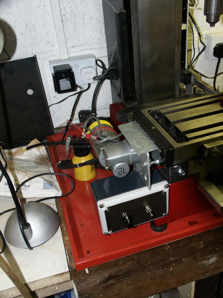

        Hi Graham,
        That IS My X3 and am very pleased with it. I have fitted a power feed (Home made.) to the X axis. I think I would have preferred to change belts for the two speed ranges rather than the noisy gear box with its poor lubrication system.

              Hi Graham,
              Here is my home made power feed. It is no real help as the motor is one I was given many years ago from some unknown photocopier.
              The motor was ideal for this application as it had an optical encoder on the end to provide closed loop speed control.
              You must of thought my first reply to this topic very odd. I thought by coincidence you had found the picture of my mill on one of the Yahoo group forums I use. (X_Series_Mills or Shumatech.) I had forgotten that I had put the picture on this forum.

                  Hi Graham,
                  Most home made power feeds I have seen on other forums for milling machines seem to use either windscreen wiper motors or the motor / gearbox from cordless drills. Another suggestion I have seen is to use a stepper motor with a suitable controller. As windscreen motors use a worm gear you would need to put some form of clutch between the motor and the lead screw to enable manual feed to be used.
                  If you decide on an X3 then when you wash out the head assembly in paraffin do not be as liberal as I was. The paraffin dissolves the adhesive on the label on the front as you can see in the picture of my mill.
                  Les.

                      Hello Graham.
                      I have an Optimus BF20 milling machine that is in many ways similar to that SIEG presented in Your message.
                      For that BF20 milling machine I built a simple automatic feed from a stepper motor I bought from the firm ArcEuro Trade (220Ncm – 10mm Shaft – Hybrid Stepper Motor) and a controller that avoids the use of computer I bought from the firm acquired QuasarElectronics (http://www.quasarelectronics. com / motor-controller-drivers.htm) ref. 3179 – Standalone / Computer Controlled Unipolar Stepper Motor Driver.
                      I installed a double pulley on the motor shaft(one having diameter twice the other) and another double pulley (both with same diameter) fixed to the handwheel and with the very same diameter. A V-belt transmits the motion from the engine to the handwheel (obviously should be a toothed belt…).
                      I have not had the opportunity to make a box to install the electronic board, the potenciometer and switches in adecent way. So I continue to use the little switches on the board to change the direction of movement and the small knob to change the speed of the stepper motor (although the knob is not very sensitive).
                      The stepper motor is mounted on a flat aluminum plate and fastened by the same screw that holds the top of the table of the router to said table. So I had not make any changes to the milling machine, with the exception of three 3mm holes in the left side handwheel. The set is completely below the table and not disturb in any way the milling operation. Both handwheels are also operational and when used with stepper motor disconnectd I can feel the steps in the motor wich is almost always usefull in controling manual movements.
                      If You are interested I can show some photos of the system, although I’m not particularly proud of its unfinished state and uglyness.
                      I’m only a satisfied consumer from the referred firms.
                      Best regards

                        #66767
                        Ian S C
                          @iansc
                          The power drive on my mill is a wiper motor, driving via a bit of bike chain that is loose enough to be lifted off the sprocket for manual use. Ian S C

                              You can find some pictures on my last album titled “My simple milling table feed”.
                              You will see I have yet to do a lot of work to give the device some “dignity”. I am not trustable at all in electronics so…
                              The belt, being very elastic, provides the means to change from one pulley to the other very easily and I have not found any slip.
