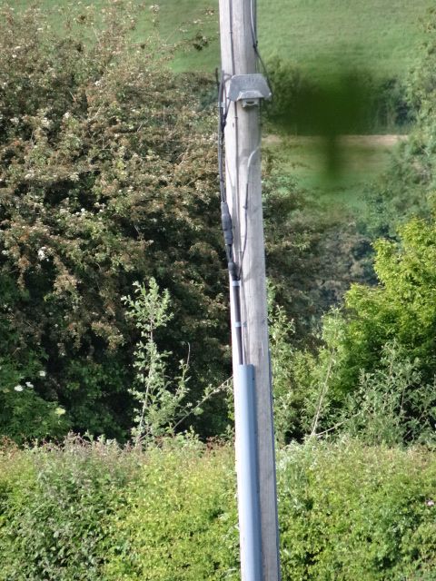

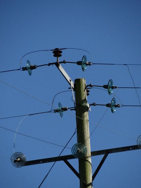

                    Nothing to do with Robert's problem but out of idle curiosity I took some photos of a local installation which I believed to be split phase. Except looking at them I don't understand the wiring! May be due to missing details because the photos were taken with a zoom lens across private land, or because I don't know about power distribution!
                    The consumer is a farmhouse and outbuildings converted to four or five private homes. Power comes from a HV transformer on a pole about 100 metres from the buildings, and the LV feed is buried.
                    The HV end of the line is connected to the grid about 750 metres away:
                    The two wires on the left obviously take a single phase to the farm. The three wires on the right are incoming, and the cross-bar beneath takes 3-phase across a road to power a Sewage Farm. (Rural charm!) Anyway, it's clear that the farm only gets one HV phase. There's no earth or neutral.

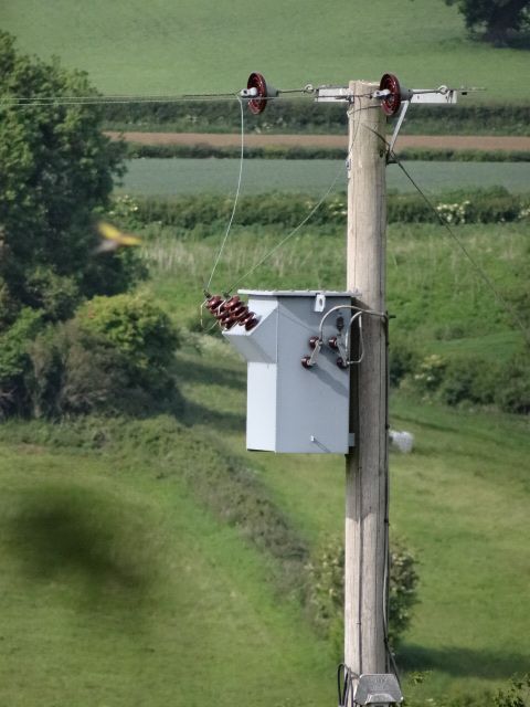

                    Just outside the farm the two HV wires drop to a pole mounted transformer:
                    On the transformer's side can be seen 4 insulated terminals, which I guess go to two secondary coils. Although 3 wires are connected, (implying split phase with a centre-tapped neutral), the two straps suggest the secondaries are in parallel, ie single-phase to the farm, with one side earthed and neutral under the pole.
                    The wiring around the fuse doesn't help me much:
                    Again 3 wires are involved (four including the poles safety earth), but I can only see one fuse. Possibly there's another fuse hidden on the other side of the pole.
                    Does any of the wiring make sense to you Stuart? (Or anyone else!) Is this split-phase, or just plain single phase? Also, is the HV side 6kV or 11kV? I guess 6kV because the poles and insulators feel safe for lower rather than higher voltages, but it's just ignorant gut feel.

                      It’s single phase.
                      This design of transformer has 1 HV winding and 2 LV windings as you thought. It is a type that can be connected as single or split phase by changing the links you can see. As this one is connected, the 2 windings are connected in parallel. The 2 terminals on the left are the live phase connections in this case, and the 2 right hand terminals are the neutral. If the 2 links were removed and only one of them connected across the top 2 terminals, this would be the neutral and the bottom 2 would then be the 2 live split phases. It is difficult to see the earthing, but the LV neutral will normally be earthed separately from the HV earth which is just used for the transformer tank and other metalwork.
                      The HV voltage could be either 11kV or 6.6kV, the design and construction are the same.
                      Single phase or split phase transformers are connected across 2 of the HV phases.
                      Three phase transformers have a delta HV and star LV with the star point the neutral which is earthed at the substation.
                      Stuart
