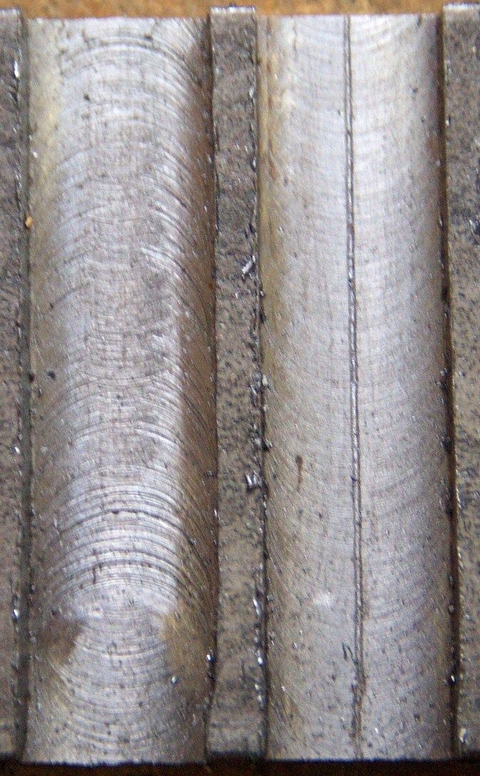

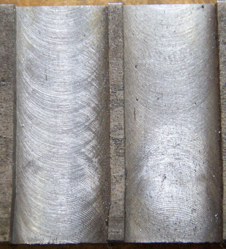

                                  I would not expect anything to come off depth wise on the return cut. However with the 3-flute cutter in the video I would expect it to be pulled slightly sideways during the cut and then take a small amount off one side on the return, this is why usual advice is to use a 2-flute "slot drill" for slots where width matters if only taking a single pass width wise.
                                  I've done another video showing the 3-flute and what that took off on the return and then the same 1.8 x 10 cut with a 2-flute which hardly removes anything.
                                  As Mentioned I'm right at the top of the column so using a vice so the head is lower would reduce this more as would doing away with the ER 25 collet holder and holding with an R8 collet which reduces spindle overhang by about 60mm.
                                  A blunt cutter will tend to deflect more than a sharp one. I took these photos some time ago, the slot on the left was the blunt cutter and the one on the right after sharpening. Cut from back to the front. You can see in the bottom left of the photos how the slot moves to the left as the cutter exits and is no longer being deflected sideways by the cutting force, Bottom right where the sharpened cutter exits has almost no deflection. These were both 4 flute cutters.
                                  If you are removing material from the bottom of the cut on the return then that is also a sign of a blunt cutter as it will tend to ride up rather than cut through the work on the cutting pass

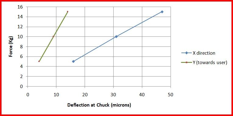

                                                      So many time people discuss rigidity of machines and spindles but strangely no one attempts to measure this significant attribute in order to make the discussions more objective. Its not hard to do. I have done it on my own Wabeco mill and the result is shown below. All I did was put a short stub in the collet with a DI earthed to the base. I then pulled the stub with a spring balance in the direction I wanted to measure the rigidity, then plotted a graph. You can see there is a considerable difference depending on the direction of pull.
                                                      The reason I did this was that I planned some simple improvements to the machine and wanted to make sure I was getting a quantifiable return on my investment. Unfortunately, with so many interesting things to do, this work is still in progress. One day I will report the conclusion but I can tell already that some re-machining of parts of the machine has improved my ability to work with tougher materials.
                                                      But as has been said in this thread, high rigitity is not crucial if one is prepared to compromise on the time it takes to do a task. Its more of a 'nice to have'. It would be good though if suppliers made some attempt to quantify rigidity of their products to help in comparing machines at purchase time, instead of us relying on folklore and hearsay.
