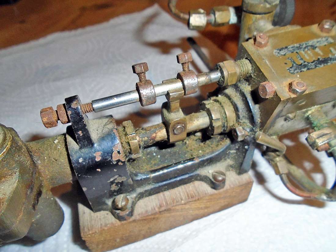

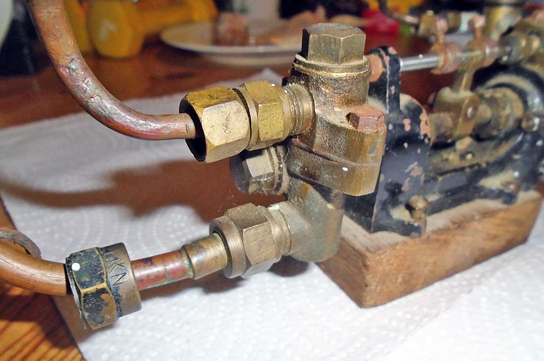

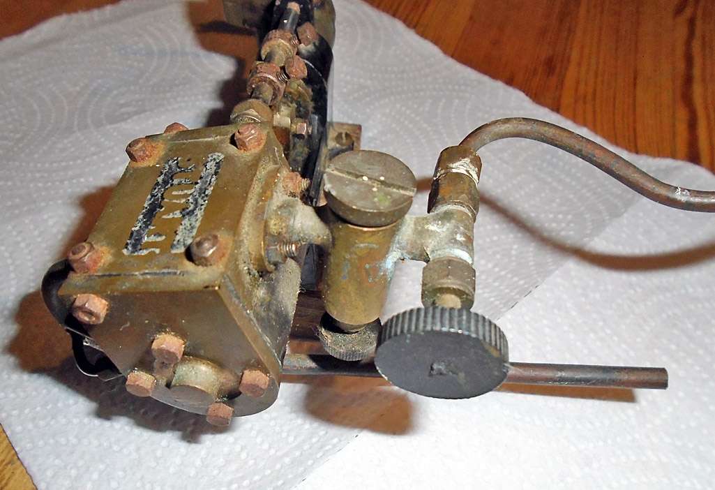

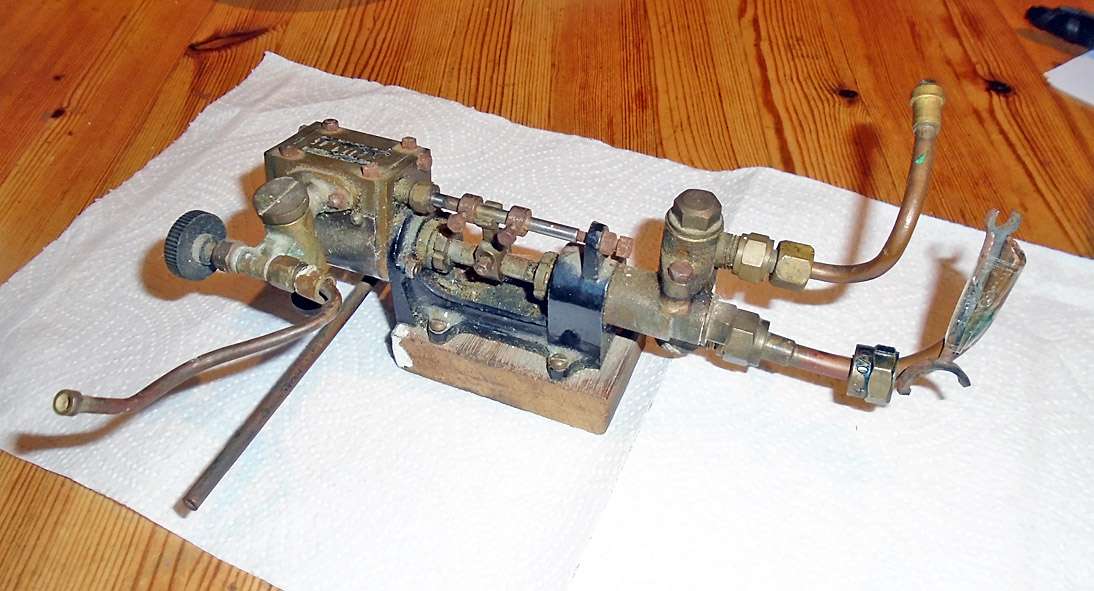

      Hi All,
      Just had my first visit of the New Year from one of my clearance guys who had this interesting but scruffy item amongst the stuff I bought from him.
      Seems to be some kind of pump but the cylinder appears to be brass not cast iron.
      stpump 1stpump 2stpump 3stpump 4stpump 5
      I think it will look a lot better when cleaned up but would love to know its exact purpose and lineage?
      Cheers, Martin

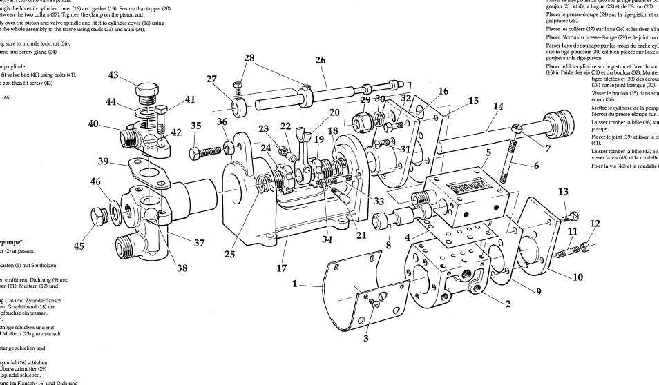

        I think the feed pumps have always had brass/bronze cylinders see here

          Ahh, An actual STUART item then, I thought it was a concoction of various parts! How little I know>
          Thanks Jason, now I am happy to spend some time cleaning it up.

            Genuine Stuart feed water pump ! Sometines difficult to get running reliably ! Got one on the book shelf. Noel.

              Just curious, if its a pump how is it driven?

                On the top right is the steam inlet and displacement lubricator that feeds the cylinder with steam. Central pipe bottom right is the exhaust with two drain cocks plumbed into it.
                The piston rod is also the pump ram that runs into the pump on the left. Water inlet at the bottom, outlet at the top. Two balls on seats act as one way valves.
                The clamp on the piston rod in the centre drives the smaller valve rod in a shuttle type motion opening and closing the inlet valves either end off the piston driving it back and forth.

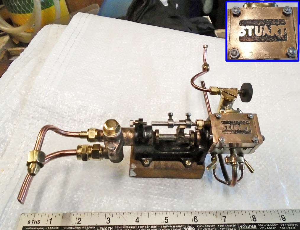

                                Hi All,
                                As it has not stopped raining here today I got on and cleaned this up a bit, came up quite well:
                                pumpforum
                                clean pump 3
                                Coming soon to an auction site near you!
                                I must say that the photo upload on the new forum is streets ahead of the old one!
