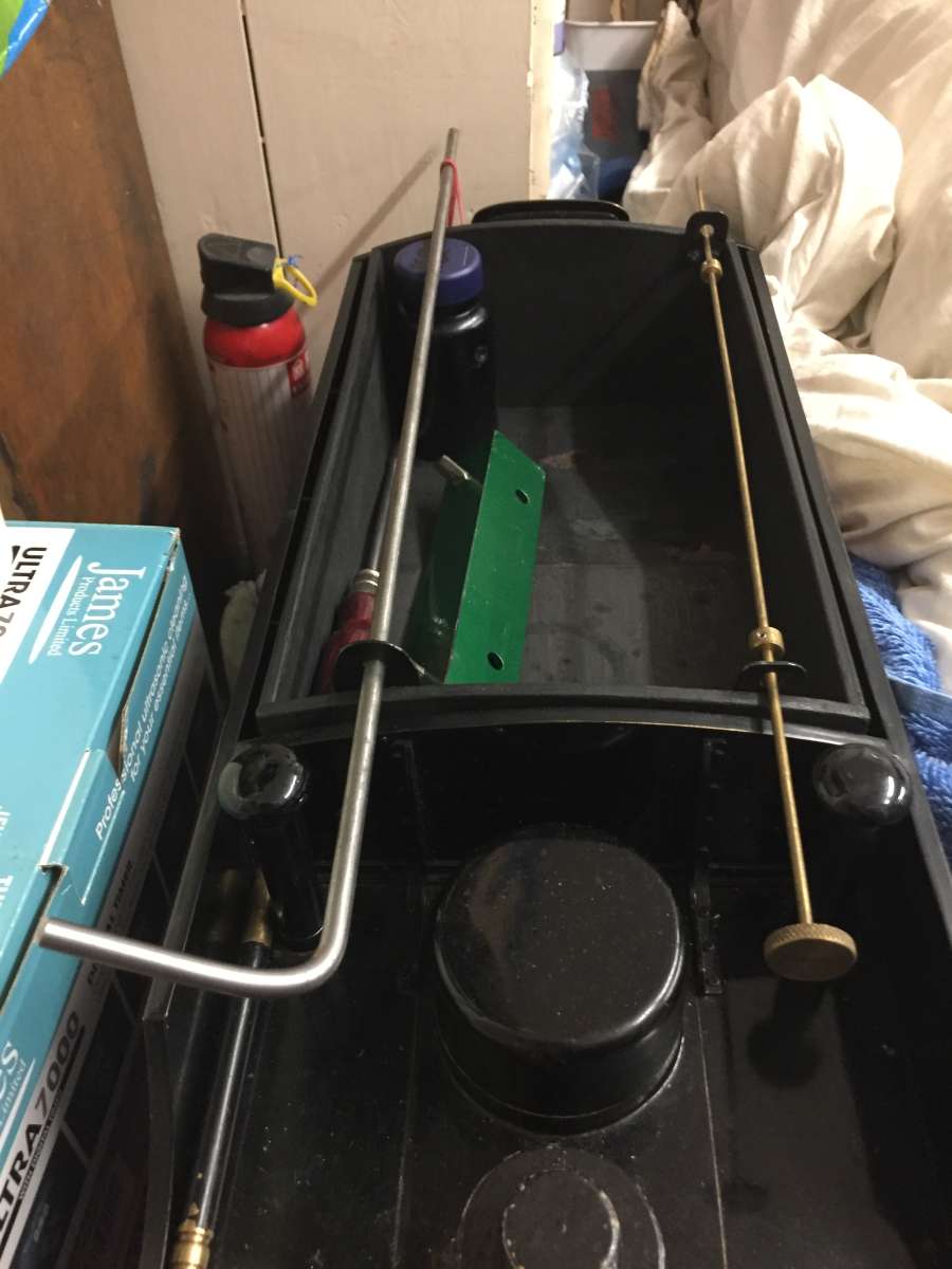

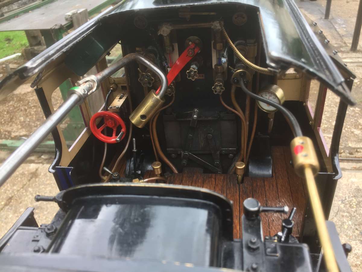

                                      Having a nose around the new Forum site looking for the answer to a question I realised from my posting back in 2016 that I never did follow up with what I did to make driving easier. In the end due to the restrictions I had with not having the front of the tender removeable I bought a universal joint and flexible cable via that well known auction site. I made up an extension for the regulator using the universal joint and used the flexible cable to connect to the RH injector steam valve.
                                      I have been pleased with the results which have both saved my back and enabled me to run ground level with, in my opinion, better control.
                                      Pictures attached, one on our raised track and one in the workshop to show from the driving position. IMG_8499IMG_2803
