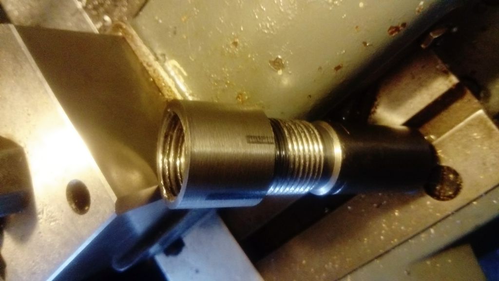

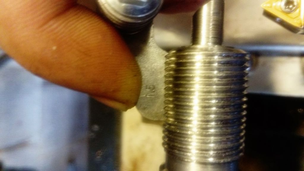

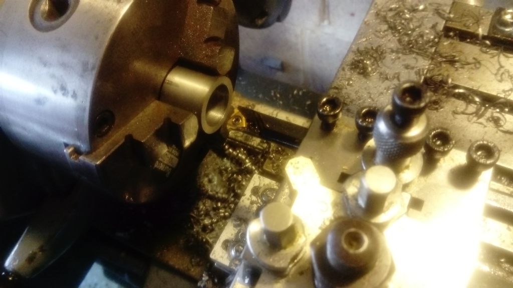

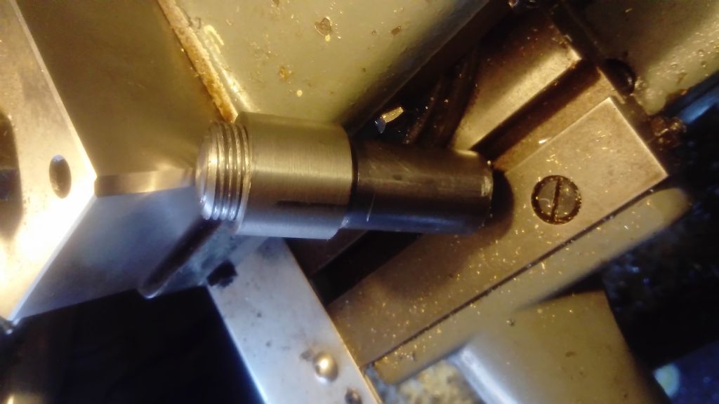

                              #290224
                              Allan B
                                @allanb
                                I HAVE DONE IT surprise
                                I took the majority advice and used the cross slide to advance across for the second thread, and just took smaller cuts and it seemed to come out ok.
                                19.5mm 1.5mm pitch
                                but after doing that, I needed a nut to go on it, so made a blank up out of some 25mm bar
                                and it works
                                thanks to John for the new gears so it is a true (ish) metric thread
                                and a big thank you to all of you for your help
                                Next job, 4 start threads, just for the hell of it.
                                Allan
