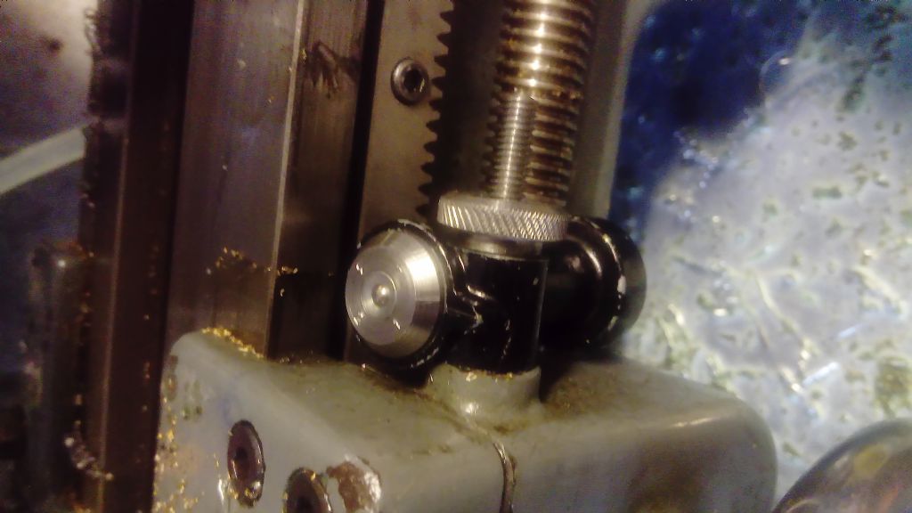

                        Jon and Neil not a great picture but
                        so to advance using the tread counter I use the little dash between the numbers? and yes it is an 8 TPI lead screw.
                        Allan

                          Yes, I believe if you engage the half-nut on the dashes between the numbers it should be plumb in between the threads you already cut.
                          Jon

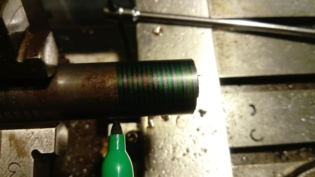

                              I'd experiment using a nice clean bit of bar and two coloured felt tips. Replace tool with first colour and 'cut' first thread. Change colour and 'cut' second. With a fine 'sharpy' type pen you should be able to see two clear 'threads'. No metal gets wasted… no tools get blunt!

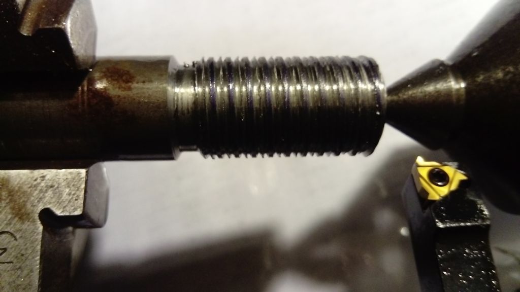

                                          ok so I thought I had this sorted, but maybe not
                                          as per advice I tried setting with the tread gauge using the 1/8 marks, and it just ran the pen along the same line, even tried in-between the 1/8 marks and it still followed the same line sad
                                          so next I tried just indexing round the spindle by 180 degrees, I dis-in-gauged the back gear, and the tumblers so the spindle could move independantley of the screw cutting gearbox, moved it round the 180 degrees and then in-gauged everything again and this was the result.
                                          a nice even twin lines, so I thought I would have a go, I turned a bar down to 19.4mm, cut the first thread in, then reset everything back to zero, turned the spindle 180 degrees as per the attempt with the pen, and this was the result.
                                          maybe not the clearest of pictures, but you can see that I have got one thread as you would expect, but then a flat before you start the next pair of threads.
                                          any clue what I have done wrong this time?
                                          Allan

                                            You need the leadscrew to move 180degrees not the spindle. Or move the work 180deg in the chuck
                                            #289734
                                            Allan B
                                              @allanb
                                              by dis-in-guaging all the back gear ect, it allowed me to manually turn the chuck and spindle the 180 degrees without the tool moving with it still inguaged with the lead screw, so I thought that is what I had done.
                                              #289735
                                              Clive Foster
                                                @clivefoster55965
                                                Did you make sure that the backlash was properly taken out of the system when switching things round. Seems to me that with such a fine thread it might be possible to have enough backlash in the gears to let you effectively reconnect one tooth out which would offset the second thread enough to leave a flat between the two starts.
                                                Some years since I did one so no longer fully up to speed without the machine in front of me. usually my hands remember better than my brain for this sort of thing.
                                                Think I'd go back to the pen with a bigger simulated workpiece and set a coarser thread then try the effect of deliberate errors. Like what a happens if I set up one tooth wrong. Maybe wrap a piece of paper round the inner cardboard tube left when the kitchen roll is used up for a simulated workpiece.
                                                Clive.
                                                #289736
                                                  Depends on the gear train.
                                                  Although the overall ration is 1:1 for 8tpi thread with an 8tpi leadscrew. The first driver and driven gear are unlikely to be the same.
                                                  #289737
