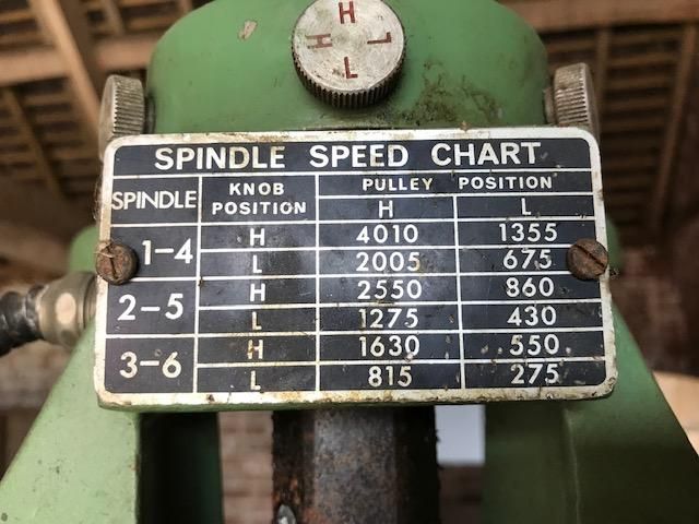

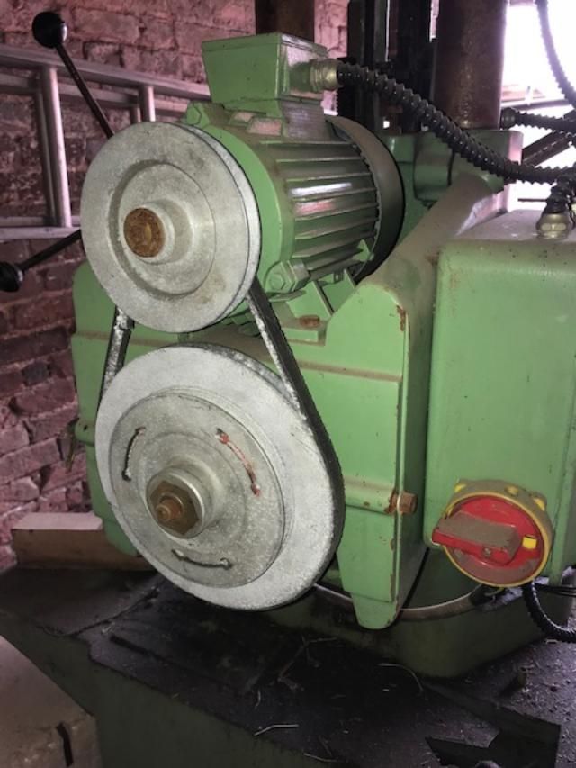

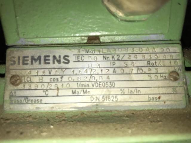

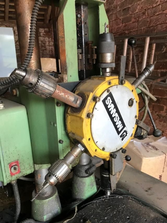

      Anybody know anything about these turret drilling machines? A friend asked me if I wanted it and although the workshop is pretty full I am tempted to make some room for it. I believe this may have been made by Metabo a Spanish machine tool company that also built clones of the Deckel FP1,and Thiel type mills. It has no 'moveable' table but could be adapted for a bolt on x-y table as long as it was low enough. It is well built and sturdy and too good to scrap out, plus it has a goodly collection of tapping heads (not the retainer plate of the one tapping head on the turret currently)

          It looks like a clone of the US made Burgmaster.

              Wouldn't use it for milling as I recognise there is little sideways support in what is essentially a drill, I already have an Aciera F3 and a Bridgeport for milling so no worries there! It is an interesting 'Production' set up as opposed to a 'gang' of bench drills which is the more normal approach to multi op drilling and taping. The x-y table was more to do with an attempt to get some accuracy in co-ordinate drilling of multiple holes – but on second thoughts it is probably easier to 'mark out' and pick up centre spots. I'm considering using it for crankcase drilling and tapping, which will need a minimum of 12, and upto 24 holes drilled and tapped, with corresponding clearance holes and spot facing.
              One area which looks to be well thought out is the depth stop system for each individual tool station, as indexing the head turret also indexes a stop bar. The other bit of trick design seems to be that the turret head is programmable for speeds as it goes from station to station – but note that stations have explicit speed ranges.

                    Burgmaster went under in 1986. There is a history of the company on line if you do a bit of light Googling. Not seen a Spanish copy before, though the online history says that Burgmaster did a licencing arrangement with Yamasaki (Mazak) that seemed to hasten their demise.
                    There was a UK importer / agent. I can't recall the company name, but did work with them around 1983/84, when my previous employer worked with them to make one into a CNC drilling machine. They did the mechanical mods (ballscrew to replace the star handle feed & an X-Y table, all mounted on a fabricated base. We supplied the electrics & a Heidenhain TNC131 point-to-point control. The machine went to a pneumatic valve manufacturer in southern Scotland. IIRC there was talk of doing another, but it didn't come to anything. On the original machine the turret index was achieved by driving the head assembly upwards until a fixed bar on the frame depressed a lever on the head. This diverted the motor power to an index mechanism to rotate the head one station. On the CNC version the head was retracted to theZ axis reference position & an M-code controlled solenoid pressed the index device on the head. There was no turret position feedback, so the programmer had to keep track of where the turret was & add a number of M-code calls at the end of the program to skip through un-used stations to return the first tool to position.

                            I forget the make but recall using a very similar machine many years ago at work, for drilling a matrix of some hundred tiny holes in each one of batches of plates for vacuum-tables on screen-printing machines.
                            The plates were not tapped though I think the machine had a tapping function or small tapping-head. They were though counter-drilled from the underside for perhaps three-quarter depth, to reduce air-flow loss. We did not use a co-ordinate table but drill-jigs probably made on a milling-machine, and fitted with lots and lots of hardened drill-bushes.
                            These are neat and effective machines, and best used with simple co-ordinate tables, jigs or jig-setting.
