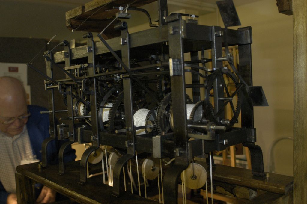

        image.jpegDoes any body recognise this clock. It was on a stand at a model engineering (Midlands I think) exhibition a few years ago. Was its construction published any where. I'm particularly interested in the method of frame and grear construction and have nothing to scale the size if stock from which it is constructed.
        My memory tels me that the gears were made from hot rolled strip and just bent into a circle using a vice and a gas axe! That is what I  would really like to know more about
        Edited By ANDY CAWLEY on 27/09/2015 08:22:09

          A nice clock!
          Gee…. I know I am going to get trampled in here suggesting this but a perfect job for the modern Gas Axe… Also called a laser cutter.
          The gears almost all of it frame and all. Simple? No. a large amount of drawing and design work on paper or CAD.
          After cutting the nice flattened and rolled features can be done after on the anvil, hot metal is fun. still plenty of lathe work.
          For the modest level of accuracy required for a large clock like this high quality 1:1 drawings on paper can be scanned into CAD software and then tidied up. Or just pay a draftsman to enter the completed drawings into a cad program to be sent to the laser cutter. As long as the person is only transcribing and not designing it should not take long.
          Scale? My guess is the frame is made from 2 x 1/2 or 2 x 3/8 inch black bar. The only issue I can see is if you want to retain an "Old" look the crisp edges of the laser cut bars would have to be rounded off by linishing or grinding. There are various ways to distress the finish. Or better in my view celebrate the present and leave them crisp and new.
          Anyway I guess that is enough heresy for one day.

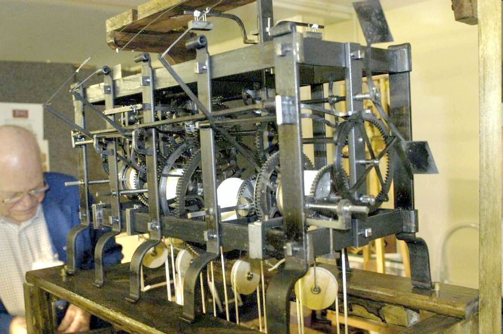

            I was struggling to make out the details in that pic so I tweaked it. Hope you don't mind.
            Fascinating piece of work!

              Thanks for that Neil, my picture was a bit muddy!
              John, your concept is quite interesting but is almost the opposite of what I was interested in. The use of black bar was actually what rang my bell (oops sorry). The really early clocks were in effect blacksmith made and using tapered peg locked mortise joints equated to what they did.
              The chap in the background was, I believe, the builder of the clock.

                  Lovely as it is … the 'Birdcage' frame of that clock looks to be made from mild steel strip ['though I am happy to be corrected].
                  It's a very different frame, but this shows some authentic wrought iron Tenon and Wedge construction.
                  P.S. if you want to try [roughly] scaling the clock in your photo; note that his left thumb is lying by a piece of the strip.

                    Bar / strip, what's in a name, the point is that it is hot rolled and therefore cheap and cheerful and available at my local agricultural merchants. The Cotehele clock is just the sort of thing I was looking for, it should give me some sort of reference to start from.

                        Is that Alec Price standing next to it.? If so I would say it was Alec Price's Half scale Turret Clock
                        regards Martin
                          If so; then this is a useful lead …

                            That is just the info I was hoping for, the name is even familiar from all that time ago!
                            Thanks.
