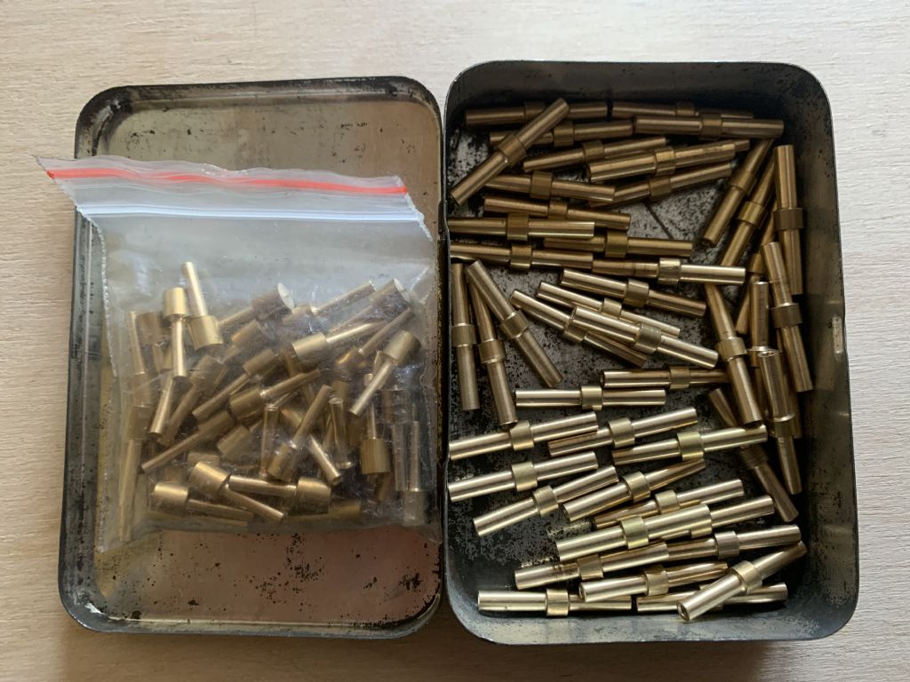

                    Been there, I set up about a year ago to manufacture some brass load binders/turn buckles for a neighbour who is interested in Tamiya 1/14 scale RC lorrys.
                    Tracey tools supplied the left handed taps and dies, I used a 8ba as its an inbetween size:

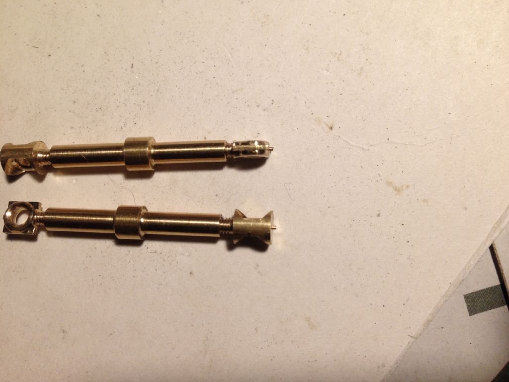

                    Blanks ready for threading:

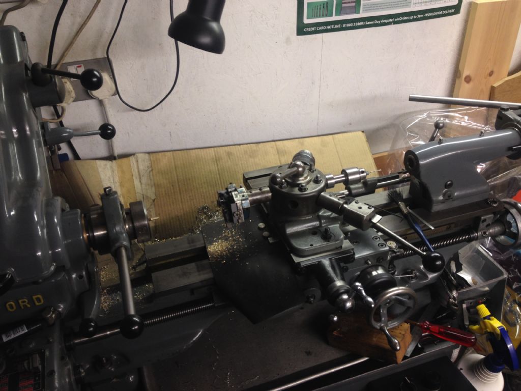

                    It was an exercise for me in setting up and using the Myfords capstan lathe attachments, This was worth it to me as I did 50 turnbuckles which meant 100 "eyes"

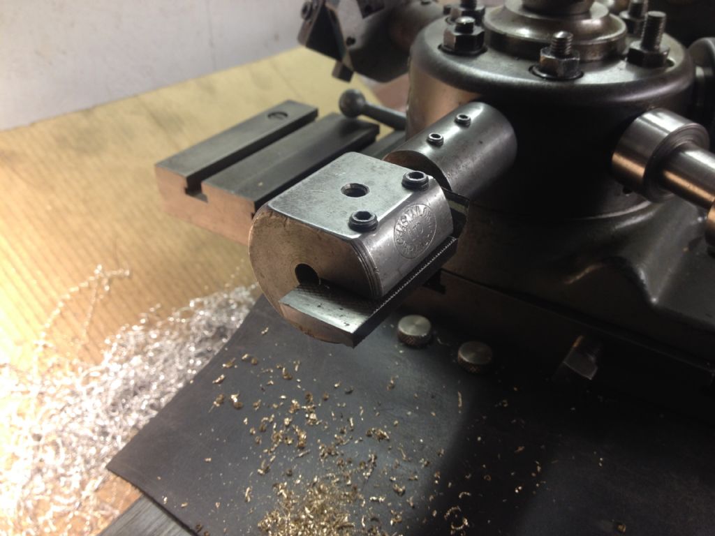

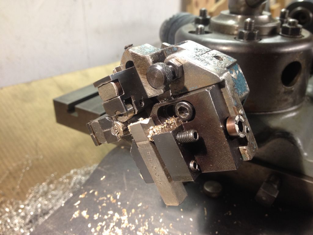

                    I used a roller box to reduce the the diameters on the body's and the "eyes"
                    This tool faced the components:
                    Centre drill and tapping drill:
                    I made these up for threading the bodys, I used these with the lathe in standard mode, only to keep the motor running the same direction. I kept on using the quick release collet chuck though. the die was held in a tailstock die holder and used in the same way.

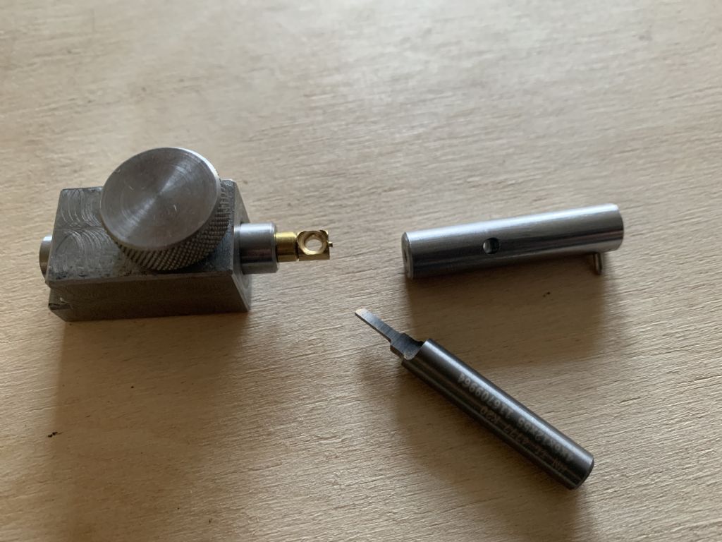

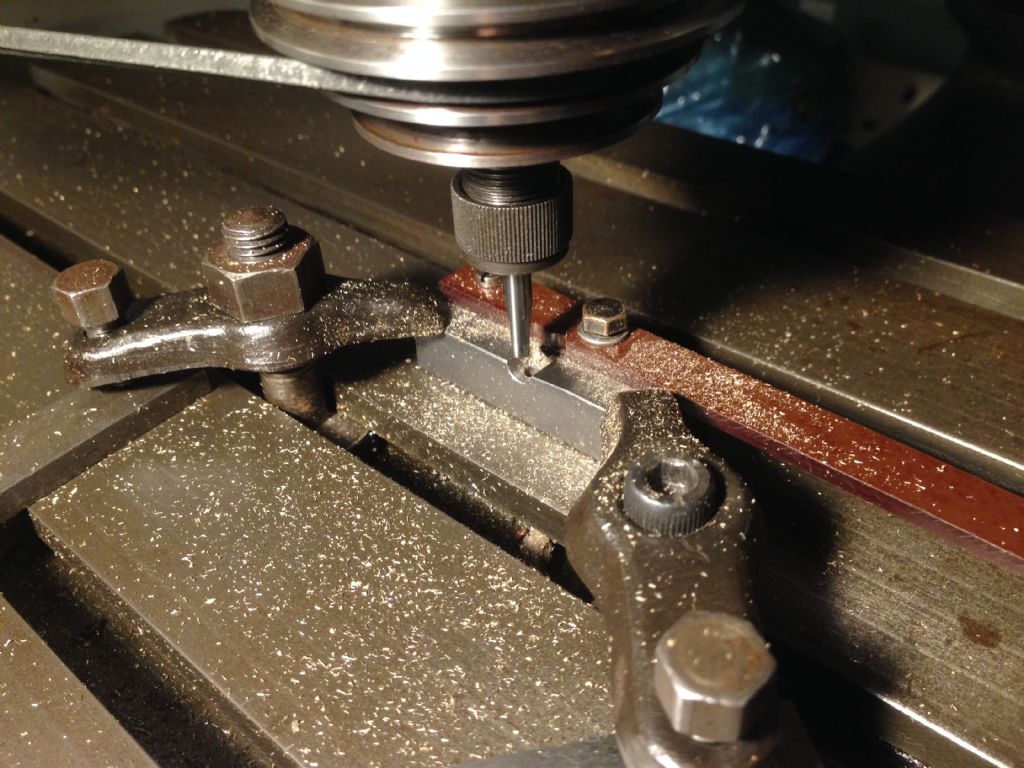

                    This attachment was to drill the cross holes and thickness/flats, for the eyes, the "drill" is an old carbide endmill shank ground to a D bit. The jig enables the component to be rotated 180degrees to produce the the flat on both sides.

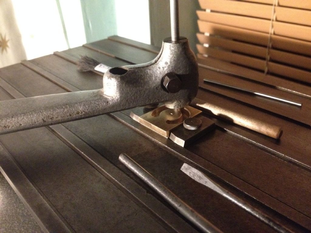

                    The following images show how I made the eyes round and put a round over on the edges, done on a pantograph engraver following the template:img_3467.jpg

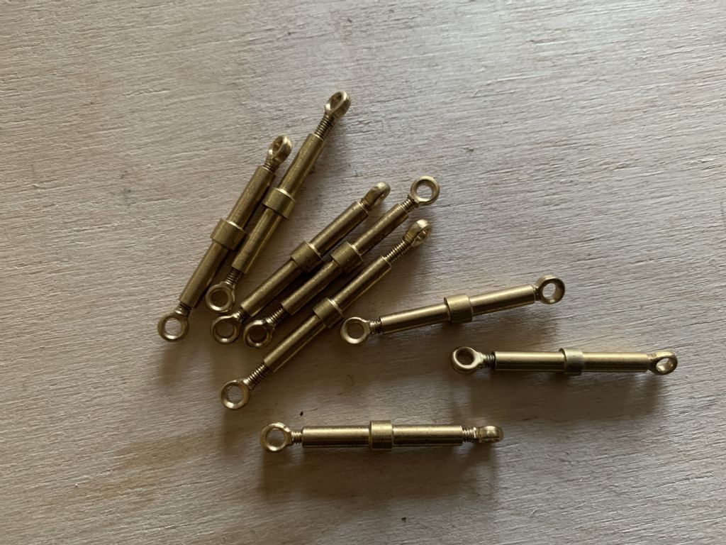

                      As one of my models is a Free Flight BE2e I want the rigging to be functional and adjustable for trimming purposes, hence the turnbuckles.

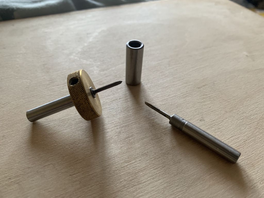

                      Here are a few photos, more in my album BE2e
                      Regards * Danny *

                        Beautiful work , Danny!
                        Please keep us posted on progress
