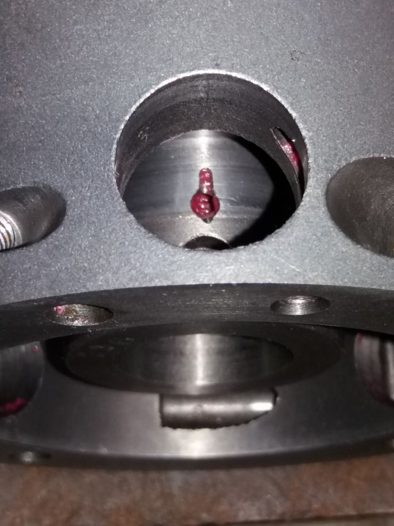

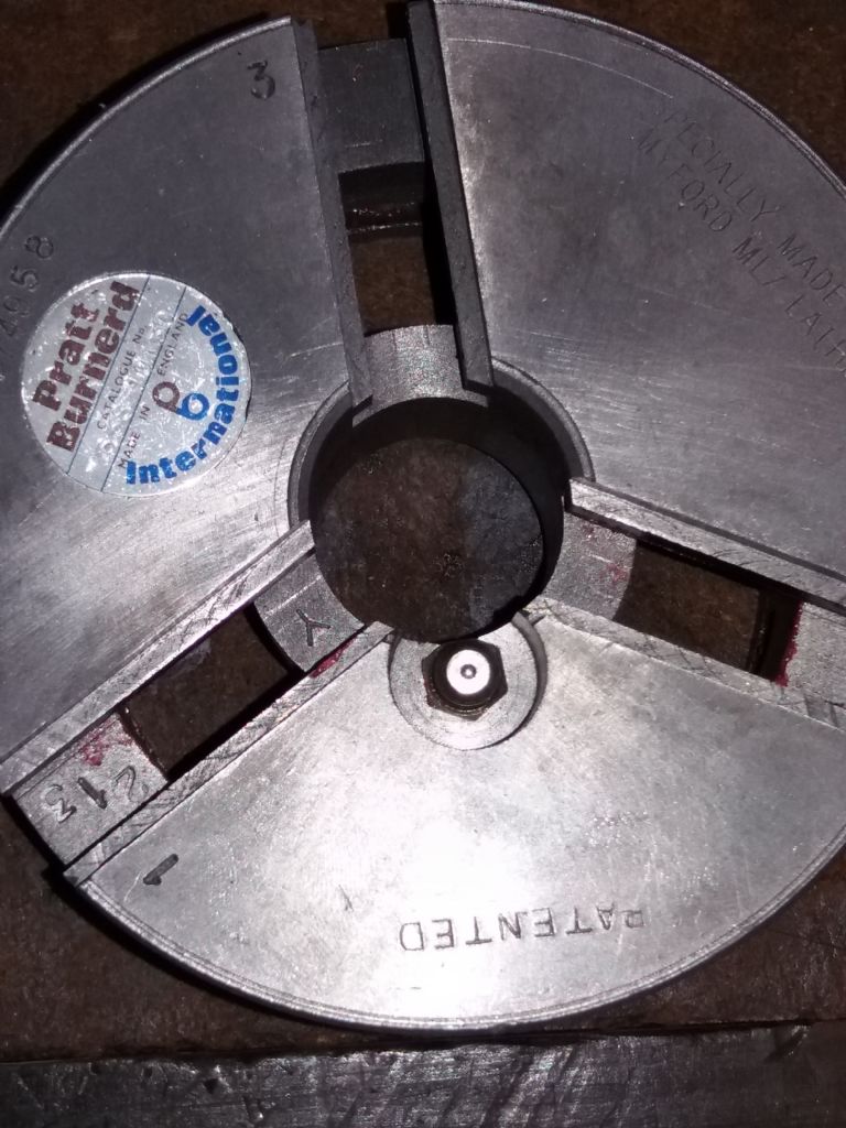

                          So I did a minor referb on my old grip tru chuck. I added a grease point that puts grease into the area between the scroll and the chuck body, (main scroll location) and also puts grease into the main body under 1 of the pinions. Time will tell if it is a good idea or not. The other option was to turn off some from the body on the inner loaction and press onto there a sleeve, then retrim and recut the inner of the scroll as well. Here are the pics of the grease fitting and the position of the hole into the body and scroll.
                          So I made one of those rings that I had in my album with 3 holes to clamp the jaws with. I was not happy with the result from that method. So then got some jarrah from the left over spa pool surround, and cut it into piece 18mm wide and 5 mm thick. I put these in between the jaws, and turned it all out. Very happy with the result.

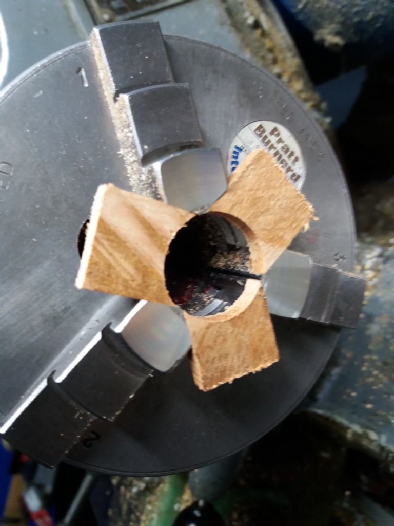

                                                  Getting back to chucks, I tried 3 methods to get the jaws correct on a worn bodied chuck. The video link of grinding a reference through a sleeve and then clamping down onto a spider or plug works for chucks that have a body in good order. The body of this chuck is worn. When I put the jaws from the new chuck into the old one, it would still clamp tighter on the back of the jaws and be loose on the front. When I used the ring with 3 holes in it for the jaws, the end result was the jaws were cut too much on the front. So when I clamped down on my test piece, the front was very tight with the back being loose. So then trimmed with the wood bits and it worked the best on this chuck. The wood is a physically hard wood and is clamped across the grain, not on the end grain. When I bored the jaws, in each case I used a boring bar with an insert capable of hard turning with a 0.2mm nose radius only taking small cuts each time to get a minimum clean up.
                                                  Hopefully this may help others who have worn chucks and would like to improve the chucks condition without too much effort with an more than acceptable outcome.
