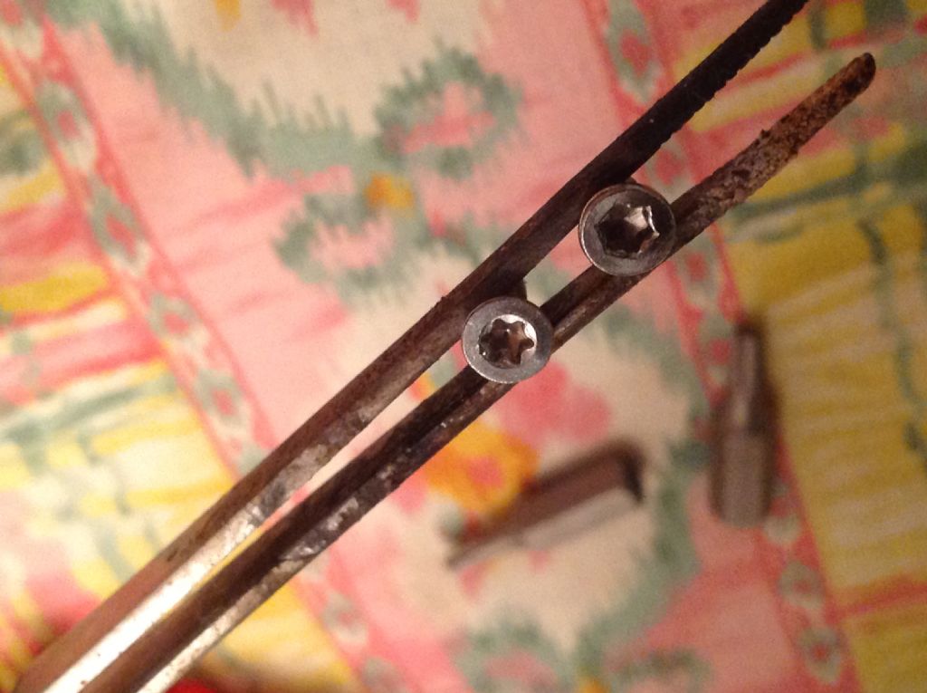

      Pictured are two M3 countersunk Torx head stainless bolts. The smaller, pleasingly star-shaped one is the type I'm used to; the other one is from a bag of twenty, all with identical-looking Torx recesses, that I was sent by the supplier who supplied the regular-looking ones.
      A T10 bit (usually the correct bit for an M3) is a very sloppy fit in them, and frustratingly a T15 almost goes in, but not quite. In appearance they're like a strange and useless hybrid between a hex and a Torx head.
      Has anyone else had a batch of these mongrel Torx heads? Can anyone suggest how the manufacturing can have gone so awry?

            The right side one looks like "the recess formerly known as Torx" laugh
            Could be bad or worn tooling, could be a China oddity, could be a new and better thing….er…..
            I'd be a whole lot happier with them if they looked like the left one or better yet were a straight hex socket.

              The ones on the right were hex socket (see the hex indent around the socket) and were double stroked in the press. Note the nice hex indent on that one then look at the dish dent on the Torx screw. If the hex socket had by some miracle jumped out of the hex header and into the input of the Torx header……
              Double stroke. Press clutch issue.

                Hi Bill, don't know what the one on the right is supposed to be, but the ratio of the socket diameter to the head diameter looks totally wrong and I would think the head may be a lot weaker than it should be. Possibly the wrong screws were in the wrong machine or the wrong tooling as Jeff has indicated was used. I would return them for a replacement or refund if it was me.

                      Not really a question, surely? Not even faulty. Just not Torx.
                      I expect there are quite a few, but possibly not on here!
                      Can anyone suggest …?
                      Just cheap chinese rubbish. No quality control. Slave labour production.
                      It is not the manufacturing that has gone awry. There will always be possible set-up errors, but they should not get palmed off to paying customers!

                                  Definitely a manufacturing fault that has escaped the rigorous quality control system, I am sure they will be happy to replace with no need to return faulty ones.
