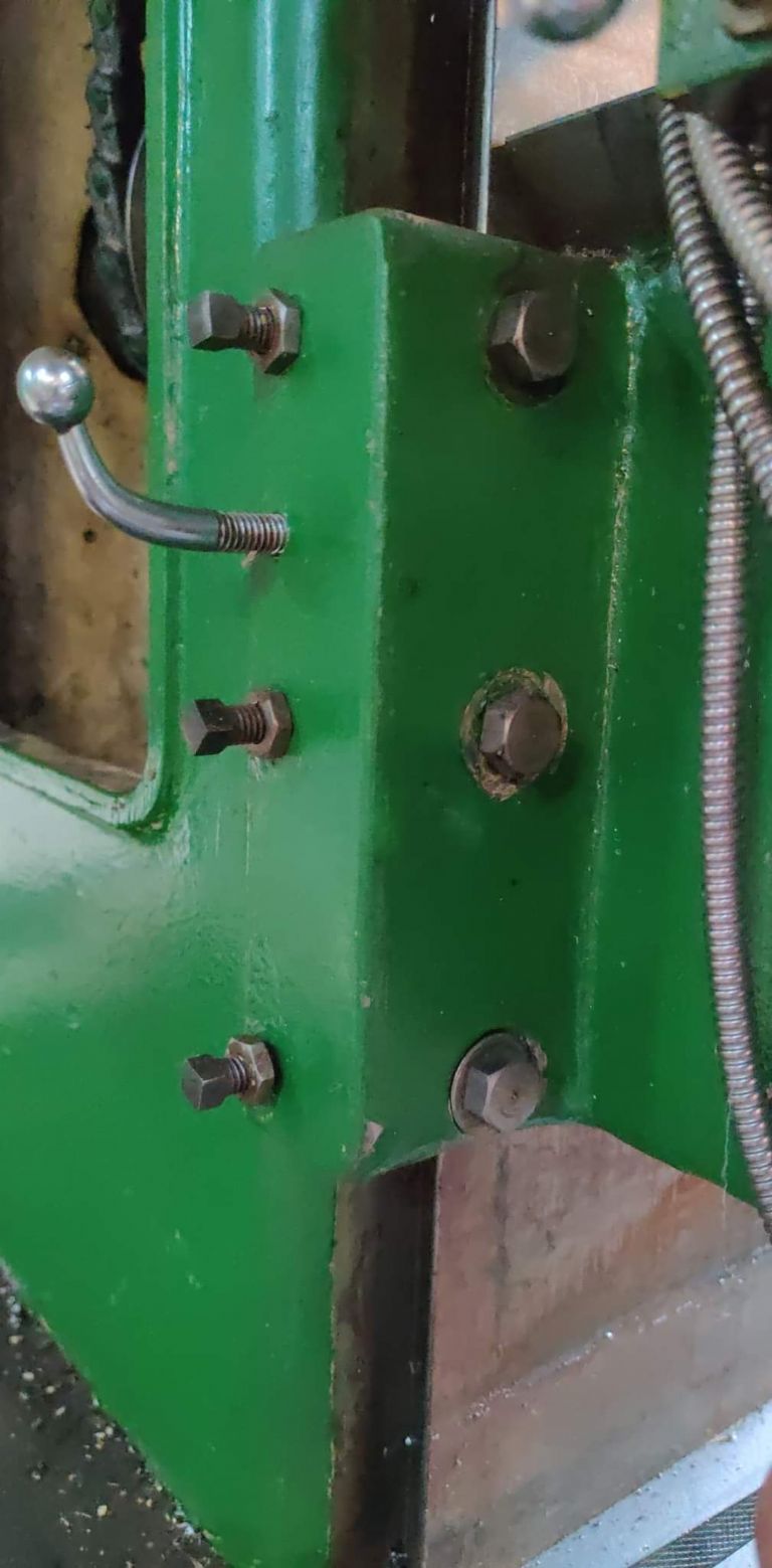

                Like Steve, I have a light vertical and believe the arrangement is the same. The three large hex headed bolts that face the rear of the machine should be tightened fully in use as they clamp the gib firmly to the knee. The three grub screw with locknuts on the side are the ones that adjust the gib. The procedure is to slacken the three large bolts just sufficiently to allow the gib to move but no more. The adjustment is carried out by slackening the locknuts and turning the grub screws and relocking. The three large bolts are then retightened fully.
                I have found the adjustment is a bit tricky. Unlike the X and Y adjustment, gravity is involved and the parts are heavy. When carrying out the adjustment, it's important to centralise the table using the X and Y handles so that the centre of gravity is as directly as possible over the Z feed screw.

                  That might be the issue then, I had slackened the three large bolts as I thought the might be locks for transport or something. I'll try what you said and report back as to how i get on. When everything is properly adjusted should I be able to easily wind the handle one handed?

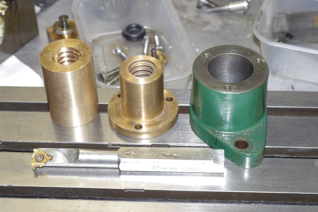

                          _igp2983.jpg_igp2672.jpgThere are several reasons for the difficulty, wear in the leadscrew nut which allows the knee to drop when lowering, lubrication and the setting of the gib which can vary in tightness due to uneven wear throughout the travel. I have not been able to entirely eliminate the problem even after making a new nut which reduces the backlash to about 0.004".
                          I bought a long lever to quickly replace the wheel when there is extra weight on the bed which makes raising much easier. The lever might be off a Myford mill, it has 7 indexing lugs rather than a Bridgeport's 8 lugs and is smaller.

                            The gib for the knee is held on by three SHCS which are not noticable at first. They should be only just above finger tight when adjusting the three adjusters with the square ends and lock nuts. You need to carry out the adjustment in the least worn area when the bed is about 5" below the spindle. When the movement seems good, but not binding, then tighten up the three SHCS and recheck. If there is a lot of wear , you might have to run it slightly tight at the ends of travel to give the best results in the middle. Plenty of oil on sliding surfaces and dovetail and on the leadscrew does help. Page 13 in the manual from Denford.

                                Unfortunately, to get at the Z raising mechanism in the knee, everything above it has to be removed, and then the knee itself. A taper pin has to be knocked out to dismantle the bevel gears. There is a thrust bearing taking the load at the top of the leadscrew.

                                  @old mart, thanks for the info on properly setting the gibs. The square headed bolts, do you just adjust them with pliers or are the specific tools for that? Interestingly on my mill the SHCS seem to have been replaced with standard hex bolts.Gib locks

                                      The square heads can be adjusted with pliers or any spanner that fits, even mole grips or an adjustable. They won't have to be tightened much over finger tight, but need the locknuts to keep them from unscrewing by themselves. You will find that TS used Whitworth, BSF and BA fasteners, so get some spanners specifically for work on the machine.
                                      Our mill has the hex headed bolts on the knee, I was muddling them up with the Y axis gib screws.
                                      Some 1/4 drive socket sets have a couple of double square sockets which fit square bolts, you might have some.
