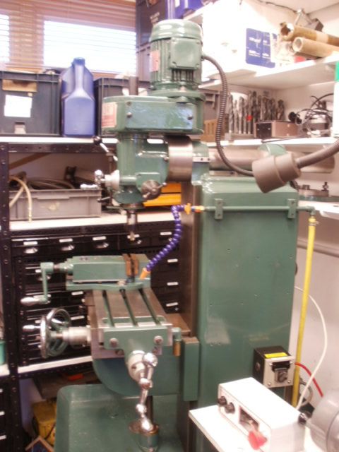

                                                Hi All.
                                                I have finally reassembled my "new" tom senior mill. I decided to give it a paint job after all while it was in big lumps. I fitted the inverter in the left hand cabinet in the column ( thanks Brian ) Still waiting for the magnetic scales ( which I ordered at the Midland show, reading heads out of stock ) for the DRO.
                                                I have created a photo album showing the mill in various stages.
                                                Andrew. The Z axis is imperial on mine as well !

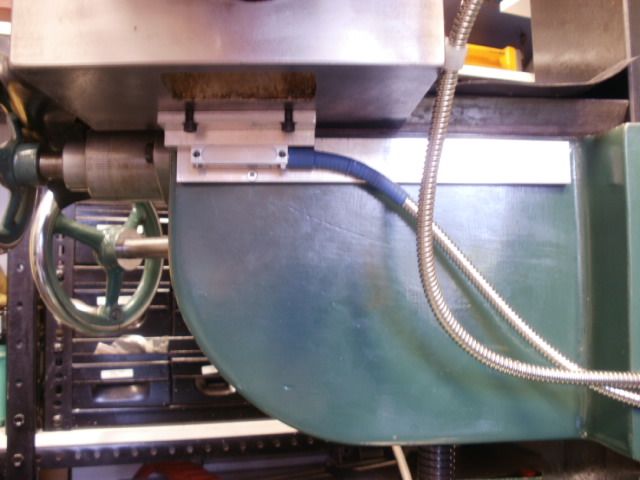

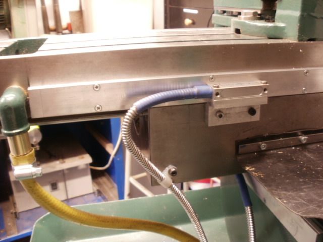

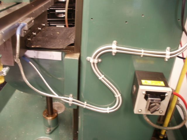

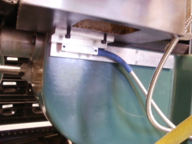

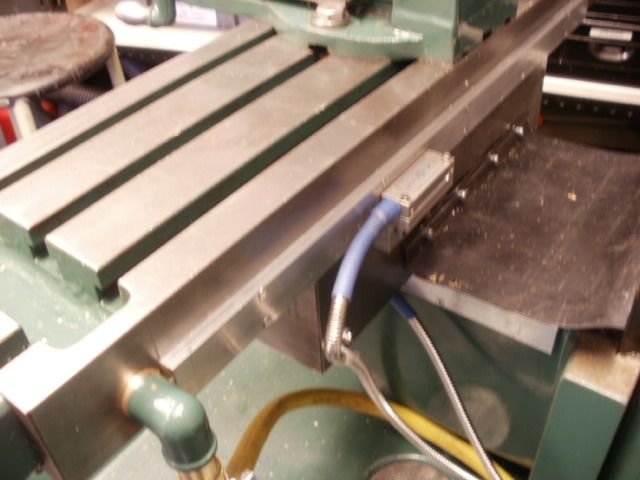

                                                      pb241078.jpgpb241079.jpgpb241080.jpgpb241081.jpgpb241083.jpgHi All.
                                                      Finally finished fitting the DRO, I decided on the magnetic scales as they are of a lower profile. By fitting the X axis scale at the rear of the table I lose less than 8mm of travel in the Y direction & the scale is out of the way & the T slot on the front of the table is still accessible.
                                                      Has other owners noticed that if you try to tilt the milling head it hits the bolts securing the horizontal bar?pb241084.jpg
